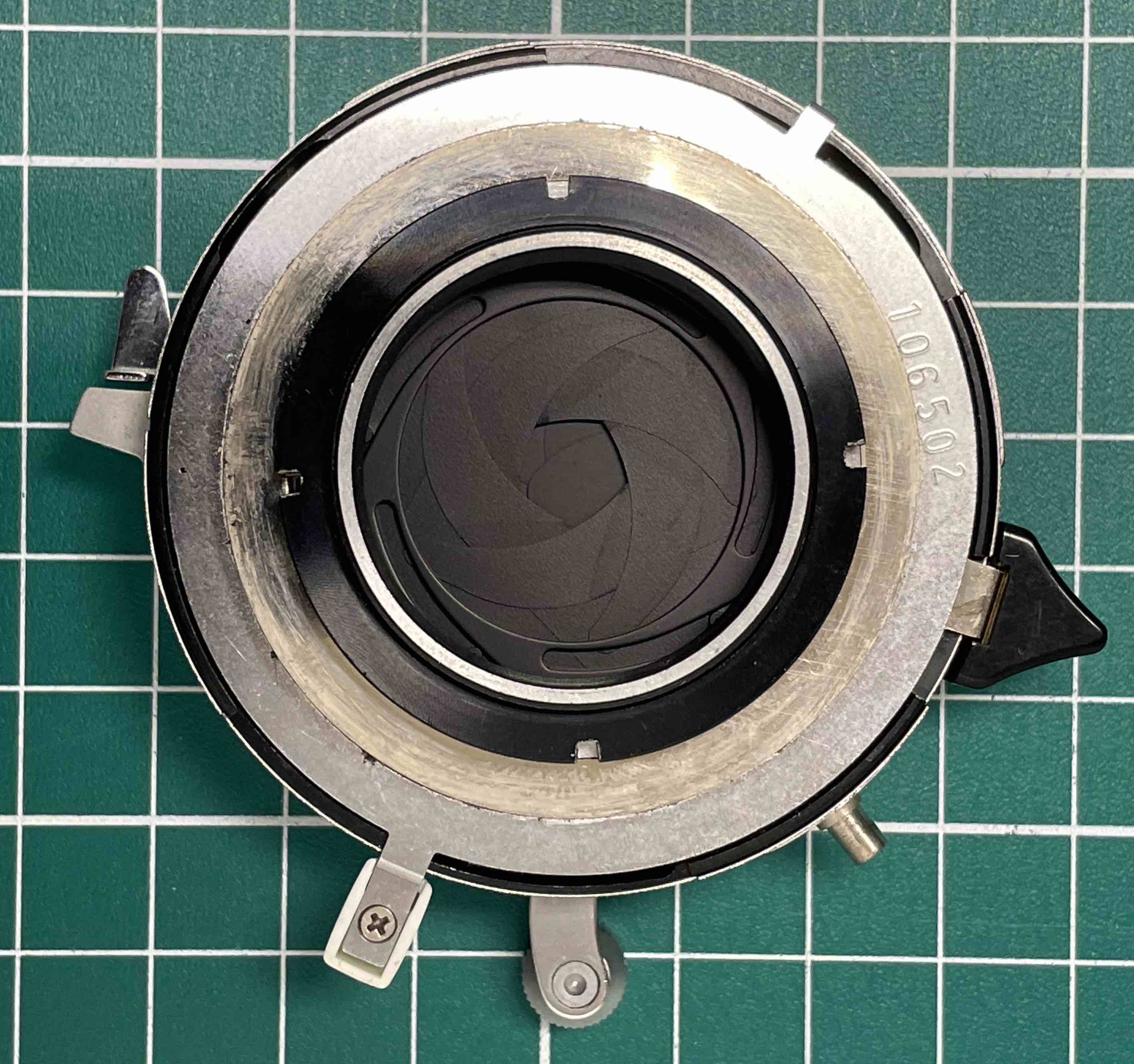

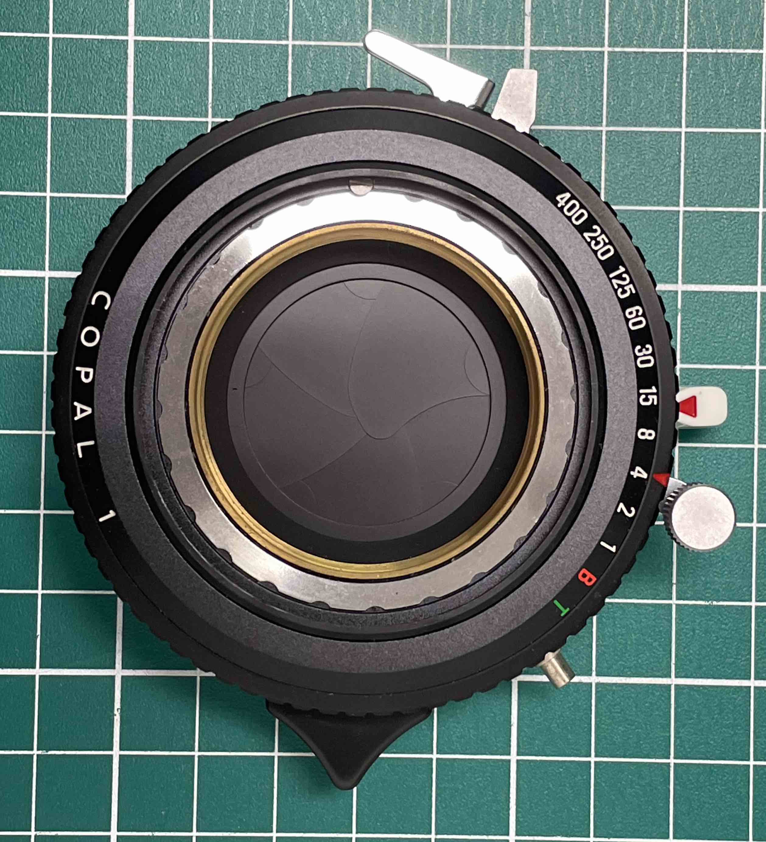

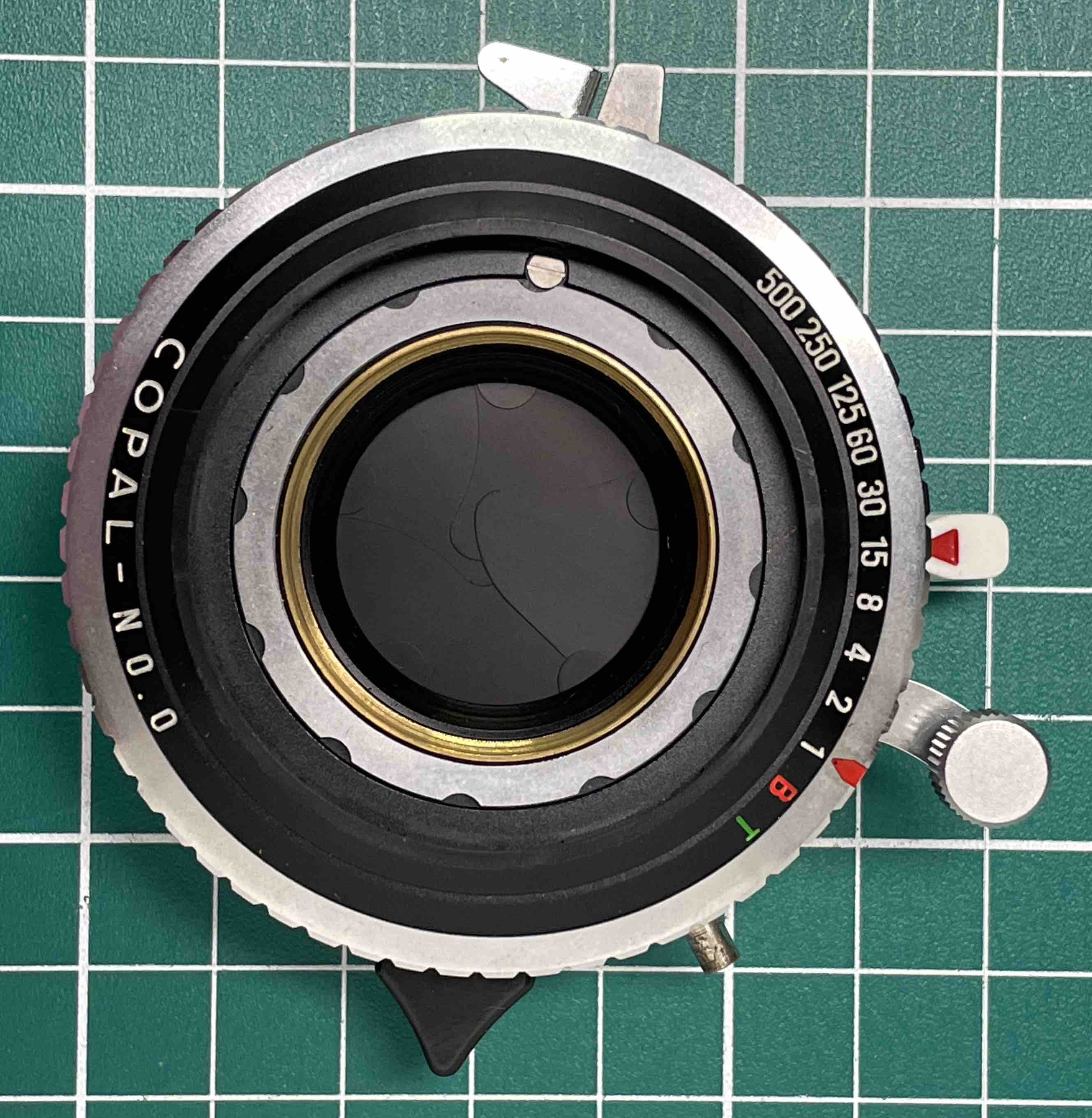

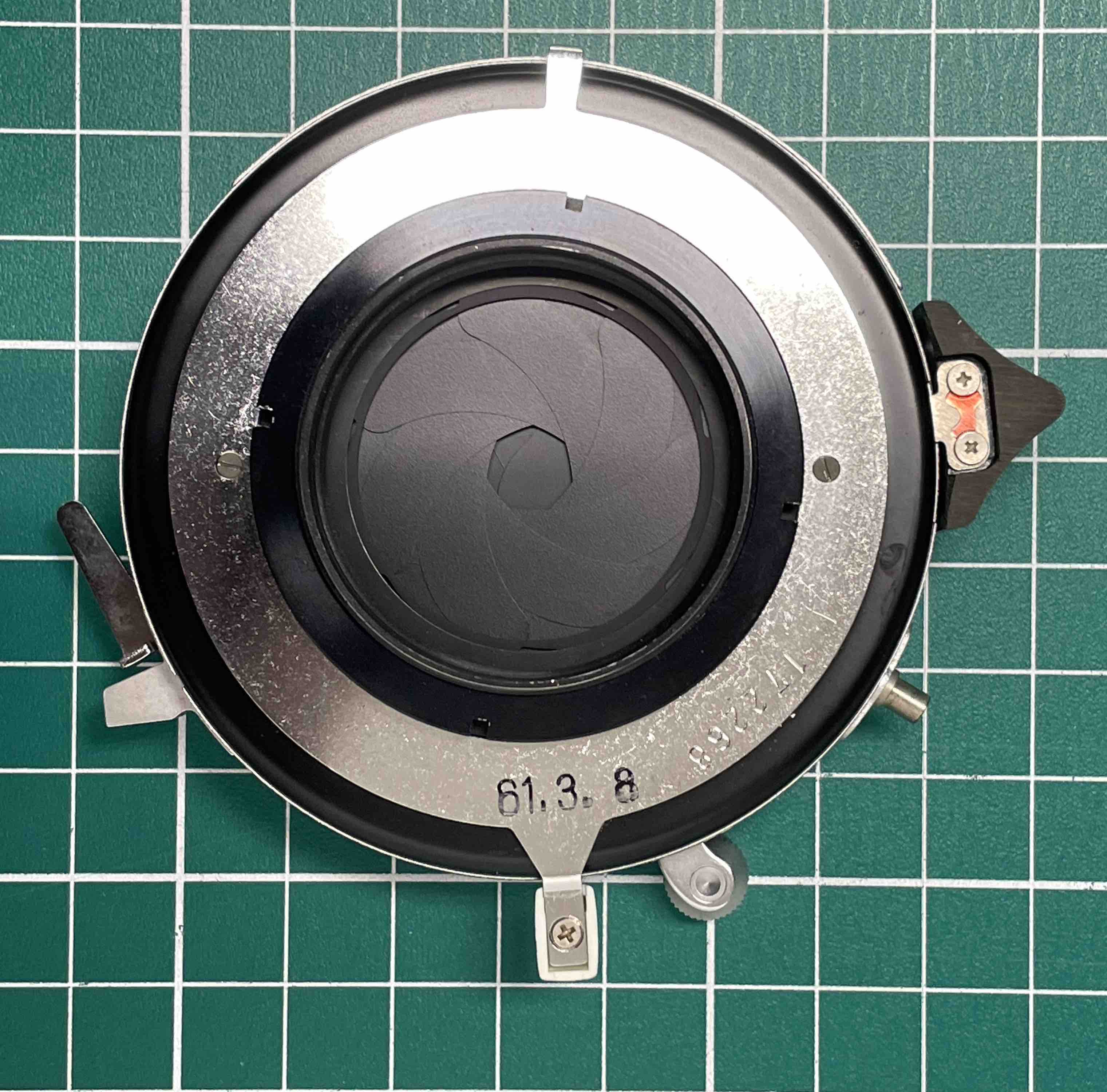

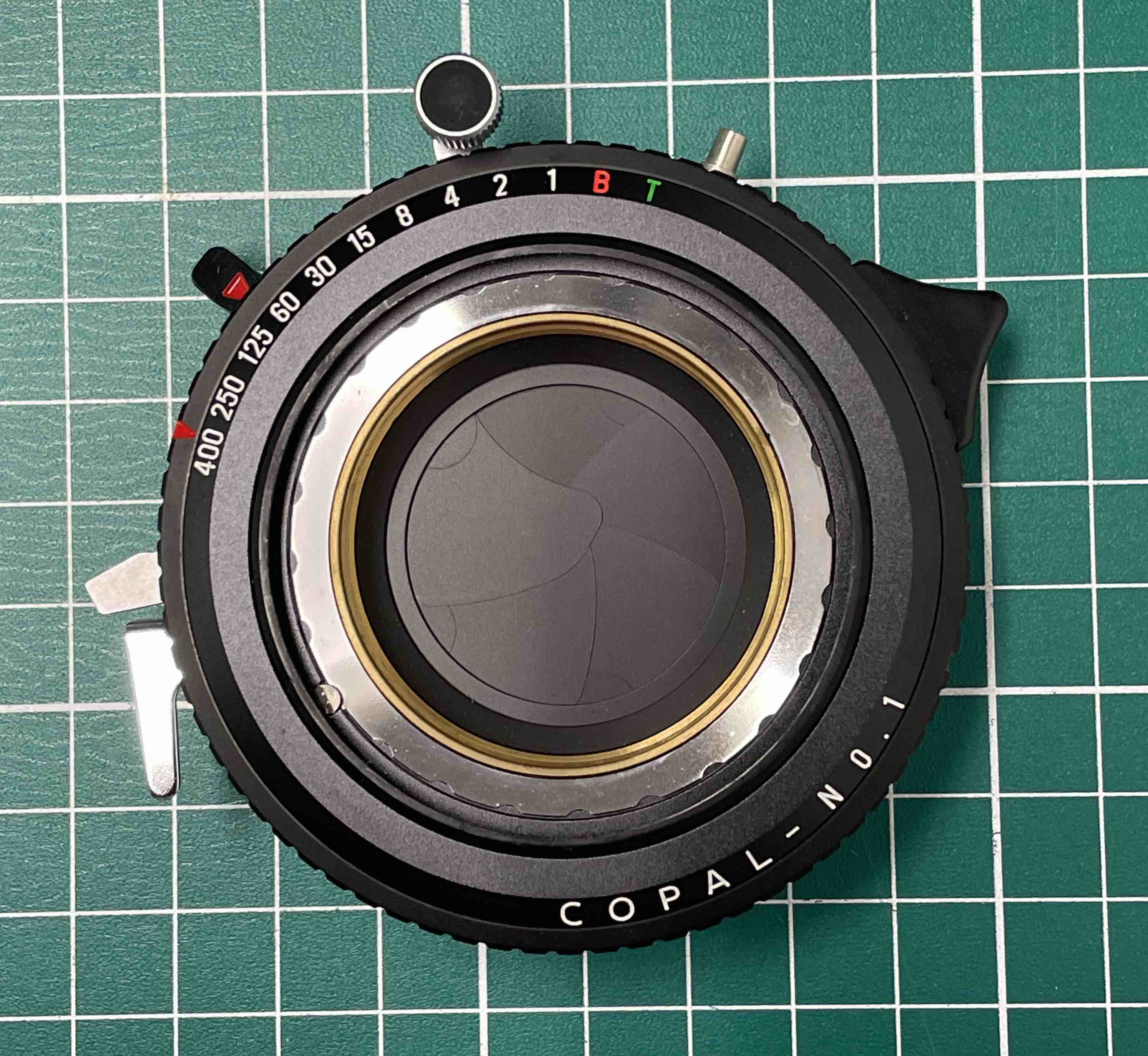

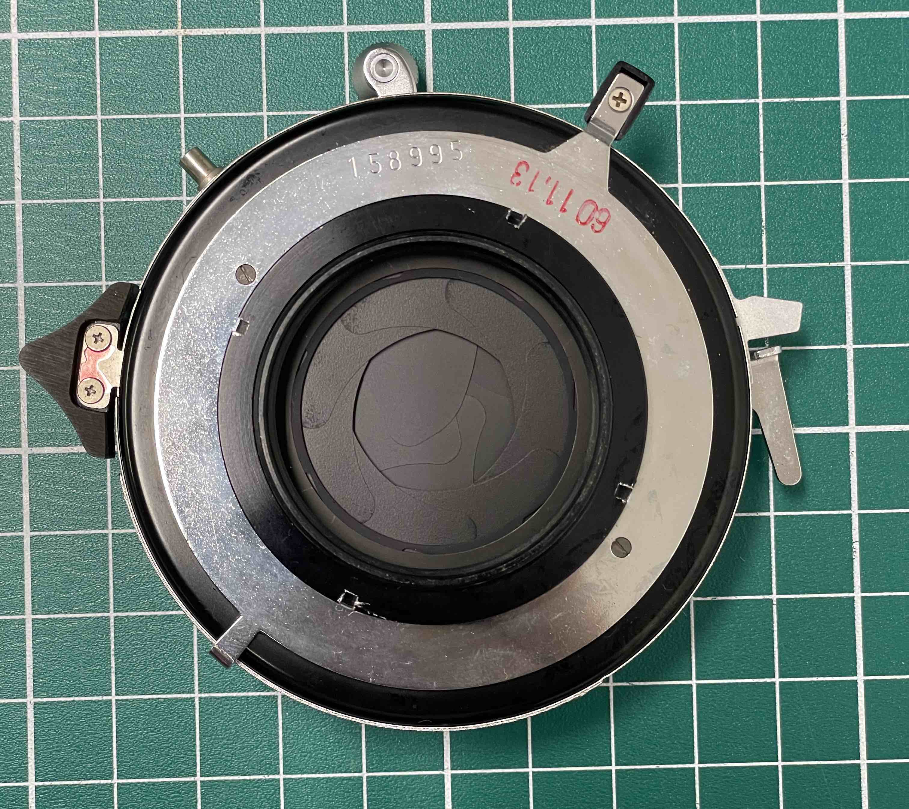

I should have posted these images with my original question, but fwiw here are the shutters I'd love to put to use. I don't have the exact dims here but the grid lines in the background are 1cm apart. There are 2 Copal 1 shutters, and a single Copal 0.

Great stuff! You shouldn't have any problems whatsoever with mounting modern barrel G-Clarons in stese shutters, like detailed above. Happy tinkering!
