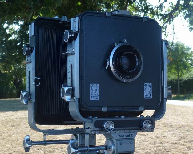

Case-in-point f. using odd lenses with odd shutters: My 5x7 Plaubel mounted with old Compur-1 shutter for 2 sets of lenses. 1. the. 210 G-Claron (the left paper aperture scale) and the 300mm Apo-Ronar (right paper scale).
Thanks for this example. Good to see.
So I can surmise that the 210 G-Claron and the 300mm Apo-Ronar (at least in your version) share the same thread size - they both fit an old Compur 1 shutter? I can figure it out, but do you happen to have the diameter / thread size information?
Sorry for the pedantism, but as far as I know, I'm in a community of one shooting large format here in Dublin, so I'm wholly reliant on forums like this to draw on others experience.
I can’t speak to the Apo Ronar (though I did transplant a 480 into a Copal 3 without issues.. The G-Clarons all transplant to Copal/Compur shutters—150mm goes in a C0; 210, 240,270, and 305 all fit in C1. The 355 needs a C3 shutter. There is a rare 355 that having a slower max aperture (f11 vs f9) that fits a C1. I’ve remounted a bunch of them from barrels.
