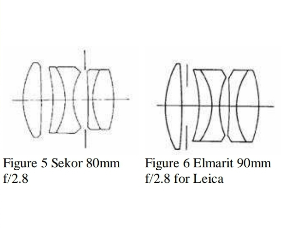

There are two "normal" lenses available for the C series, f/2.8 and f/3.7; 5 vs 4 element optical design. I have the f/2.8 version, and can say it's a very good lens.
I never ever understood why Mamiya used that lens formula.
The leica lens on the right isn't comparable because it has a much narrower field of view. It's a long-focus length, while the Mamiya lens is a normal lens with a much wider field of view. That the design works well for a long-focus/"portrait" lens, doesn't mean at all it will work as well as a normal lens.
Mamiya is the only one to use such a lens design for a 6x6 normal lens. They also used the exact same design for the 127/3.8 lens on the Mamiya RB67 cameras, all versions.
I never understood why. The 80/2.8 is usually done using the tessar design (early rolleiflexes, early hasselblads, folder cameras, soviet industar-29), xenotar (soviet vega-12, rolleiflexes, bronica 75/2.8 nikkor-P, bronica 75/2.8 zenzanon), or double gauss aka "planar" (more modern rolleiflexes, bronica 75/2.8 nikkor-H, modern hasselblads, soviet volna-3, etc etc etc ETC).
The only, only manufacturer I've found so far to use this design on the picture, was Mamiya.
My understanding is the Elmarit is really a Tessar derivative, so I think in that sense it is consistent.

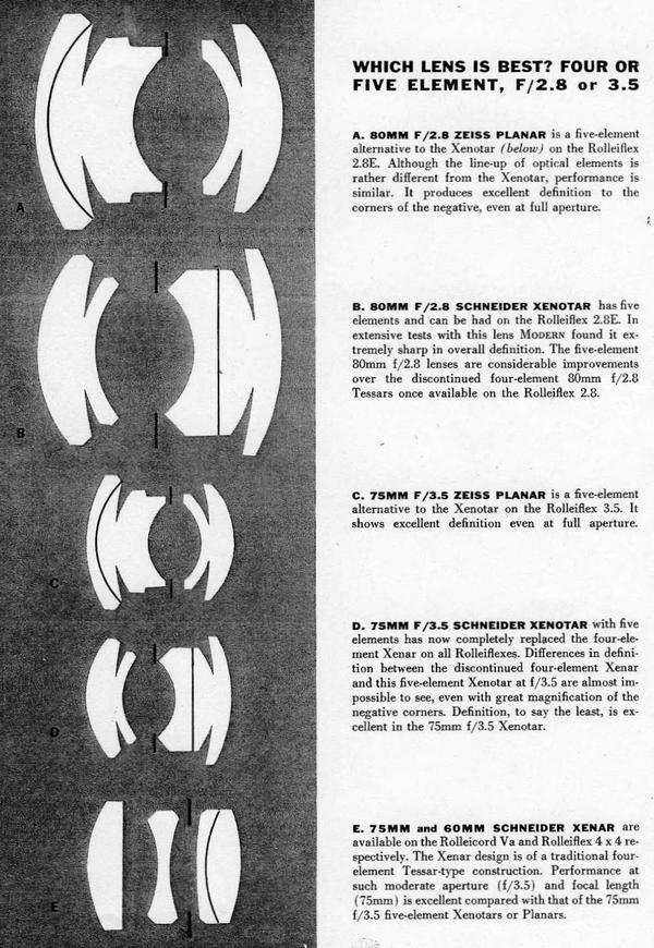

I always thought that Xenotar and Planar are exactly the same thing, at least in the context of Roleliflexes, no?
In the context of my post i am referring to a lens type. "Xenotar" refers to an optical designs that is completely different to the design often labeled as "Planar". Sadly Zeiss put the "Planar" to lenses with wildly different optical designs. Most of the "Planar" lenses are 6/4 Double Gauss designs. The Schneider equivalent for this scheme is the "Xenon", not Xenotar.
In fact my post was badly written, i should have written "Biotar" instead of "Planar" and it would have been more clear.
The Xenotar is a 5/4 lens:
The Xenon is a 6/4 lens, this is the "Biotar" design, as are many of the lens labeled as Planars

@flavio81 Thank you, that makes sense. But - in case you're familiar with Rolleiflex ecosystem - are Planar and Xenotar Rolleiflexes the same? The 1st diagram in your post looks very similar to this page.
reddesert
Jul 22, 2019
2,545
SAZ
The Mamiya 80//2.8 lens design is an elaboration of the Tessar design, with an extra element added to the second group. "Tessar" is a Zeiss trademark and Xenar is the Schneider equivalent usually. The trademark name is still proprietary long after the lens patent expired. Of course Zeiss can now paste the "Tessar" name on lenses that aren't a Tessar design, witness the "Vario-Tessar" zooms and so on.
The original double Gauss lens is 4 elements and symmetrical. Xenon and Xenotar are Schneider trademarks while Planar and Biometar are Zeiss trademarks. These four are derivations of the double Gauss design, typically with 6 or 5 elements respectively, but there's no absolute rule about a name implying a specific design. Typically, the fancy Rolleiflexes had either a Planar or Xenotar, while the less fancy or earlier ones had a Tessar or Xenar. They are made by different companies and aren't the "same lens," although I don't know if there is any difference in practical use.
Nearly all "fast normal" 35mm SLR lenses (f/2 or faster), and modern normal MF SLR lenses, are some descendant of a double Gauss design.
flavio81
Oct 24, 2014
5,170
Lima, Peru
As i've mentioned, Zeiss labeled "Planar" lenses with very different designs.
The diagram you show is indeed a Planar for the Hasselblad and the design is not exactly the same as a Xenotar. You can readily see how the first lens is formed by a group of two lenses, instead of a single positive element.
I've read somewhere that later on the Rolleiflex, Zeiss changed the optical design to the same biotar/xenon 6/4 scheme that is very common in the 35mm SLR world.
