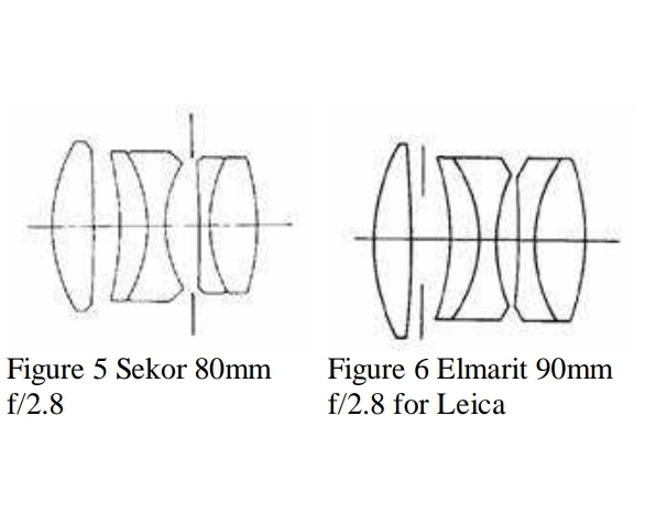

Assuming the Mamiya TLR lenses improved in later years, what is the latest Mamiya TLR normal lens, i.e., in the 75-80mm range? Will it work on the older Mamiya TLRs, e.g., the C3 and C33? My main goal is the "best" image resolution/sharpness. Thanks!
The 80mm lens. End of discussion.
I have a couple of copies of the 80, including the latest 'S' version. They're very good. But I find the 105 DS just as good if you prefer a slightly longer normal. I've never thought one of these was better than the other.
I've owned almost all Mamiya TLR lenses. Easy. The "black rim" 80mm without any markings on the lens rim. That's the latest version with the latest coatings. Here's how it looks like on the right. It matches Rolleiflex Planar/Xenotar f/2.8 in resolution but beats them in flare resistance and contrast.
