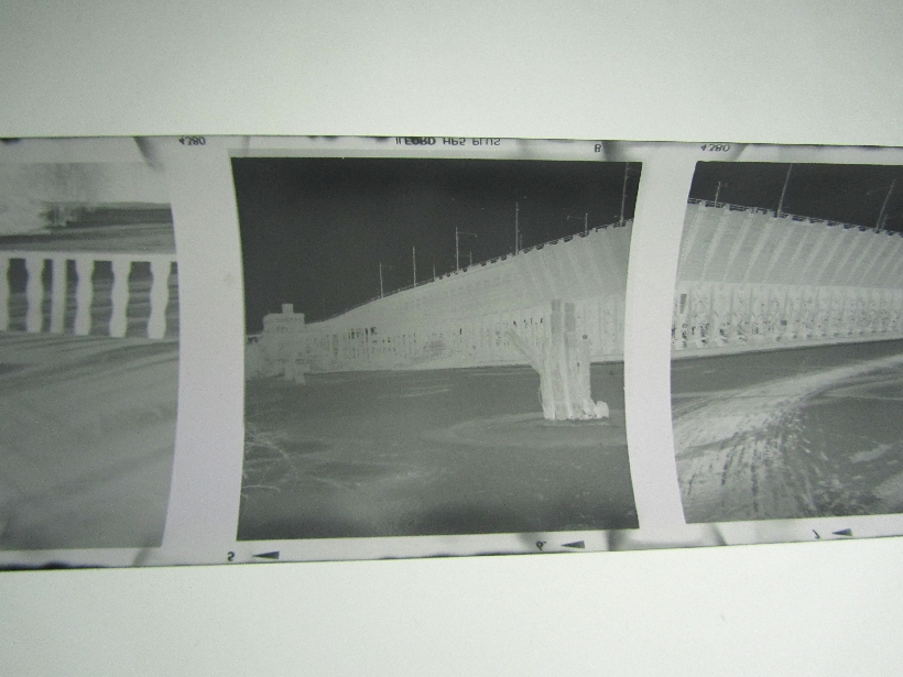

Got some serious light leaks in my 6...on the bright side, HP5 was a lot easier to read through the window than Portra 400. I'm thinking the window must be at fault here at least in part. The red is pretty much faded away on the filter, and the sliding door that covers it is wonky and sometimes doesn't close all the way. But I'm not sure that could do all of this...
MattKing
Apr 24, 2005
54,270
Delta, BC Canada
I don't think those leaks are from the window - they are out near the edge.

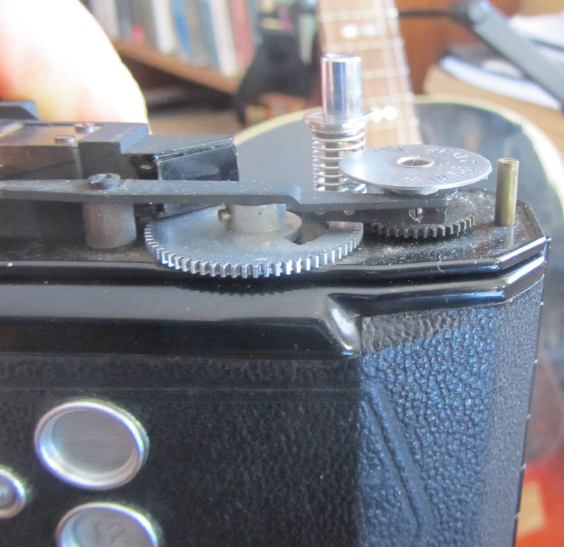

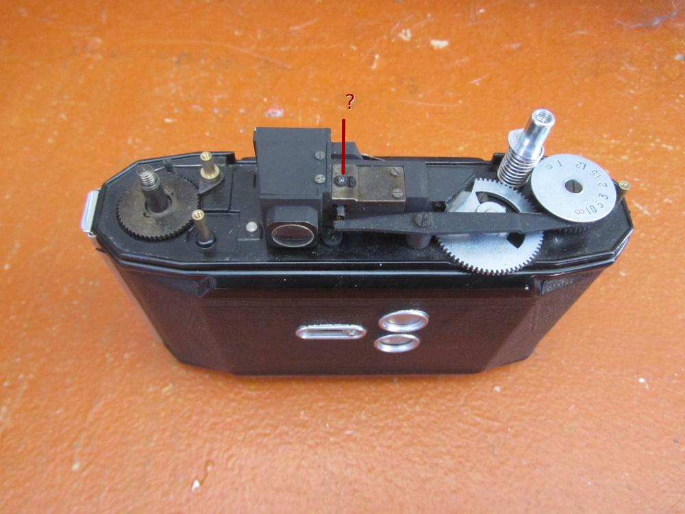

Here's the horizontal RF adjustment screw. Might be easier for someone to find it through the access port if they can see what they are groping for. But it's probably not worth trying, just take the top off.
Now whats this other screw? Is that a vertical adjustment?
