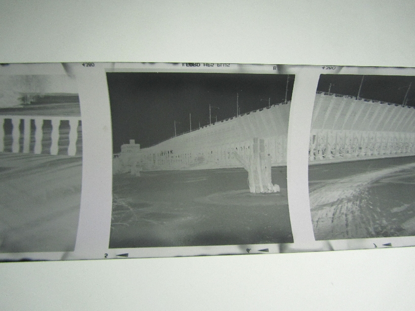

Got some serious light leaks in my 6...on the bright side, HP5 was a lot easier to read through the window than Portra 400. I'm thinking the window must be at fault here at least in part. The red is pretty much faded away on the filter, and the sliding door that covers it is wonky and sometimes doesn't close all the way. But I'm not sure that could do all of this...
Ughh. It seems improved but still leaking. I think these are bellows leaks, and my 30 day return period just expired 2 days ago...

Actually that's what I did when I first got it, and I saw nothing. The trick was to do the opposite-shine the light outside while looking inside. Now I just need to figure out where the leaks are. Its a little harder this way. I found one but I think there is at least one more...
