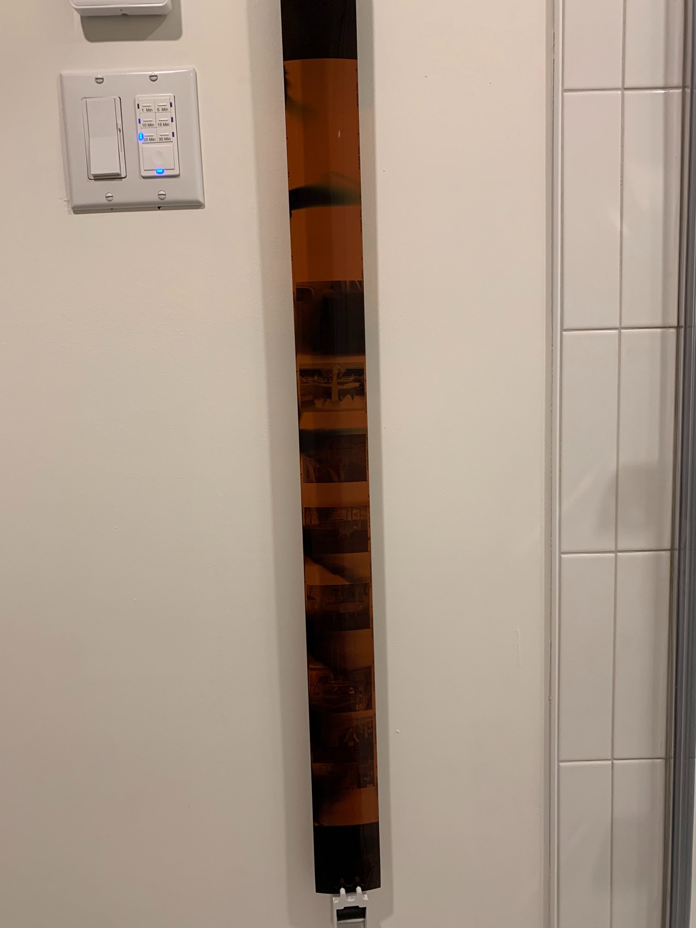

Whelp... I just shot another roll with it and unfortunately, it looks like there's something very wrong with the film advance crank. Here's the result:
I'm not sure what the issue is exactly, but it looks like the film advance mechanism is misbehaving depending on the thickness of the film. Weirdly enough, if I use an empty roll of fomapan (with only the backing paper, which is super thin) everything seem to work just fine; the film advance crank stops at frame #1, and then stops properly on every frame, and shortly after the last frame (#15) the crank keeps going and after a couple of turn past the last frame, I reach the end of the backing paper, and there is no more resistance on the crank, just like I'd expect.
However, if I use an actual roll of film (the one in the picture above was Portra 400, but the same happens with HP5), when I load it and then turn the crank to go from "S" to frame #1, the film counter advances reaaaally slowly, and I end up making dozens of turns before I hit frame #1, and by then, I'm usually halfway through the roll. After shooting a couple of frames, I can definitely feel where I reach the end of the roll since there's no more resistance on the crank (seems to happen around frame 6 or 7), and the result, when I develop the film, can be seen in the image above (that's just one example, I went through 3 rolls now). Basically; a long stretch of blank film that reaches almost halfway through the roll (where I go from "s" to frame 1) and then a couple of decent frames, and then I reach the end of the roll...
I was willing to attribute the first roll to human error, but after 3, I'm pretty sure there's something wrong with the camera :\

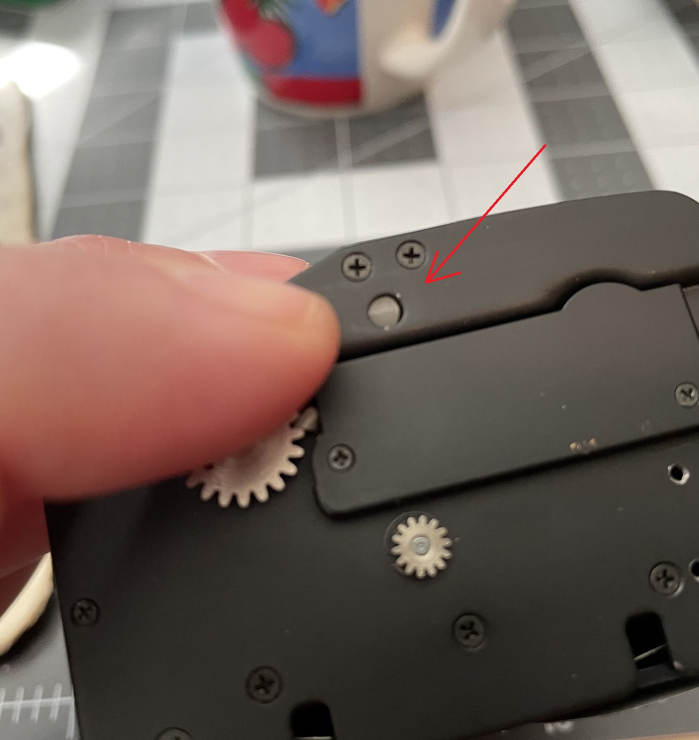

Well, this is very interesting. I also appear to have the same problem with a spare insert I have that I rarely use.

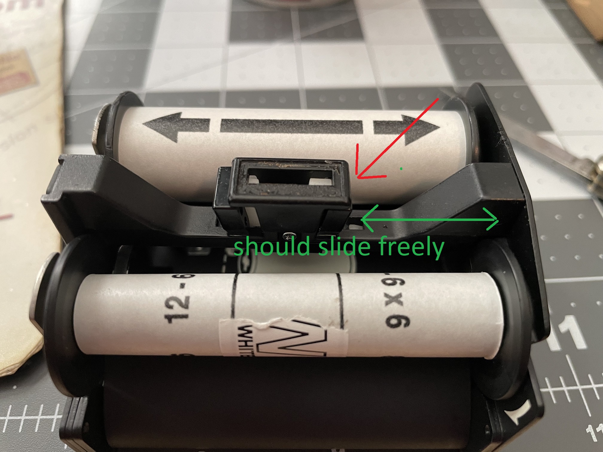

As you can see here, the right spring tab is stuck and not allowing the plastic tip of the locking mechanism to extend and lock the magazine against the pressure plate. The other side does and gives me a false sense of being properly inserted. I was able to successfully transport a roll of backing paper only without mishap.
Here you see the pin trapped and unable to extend.

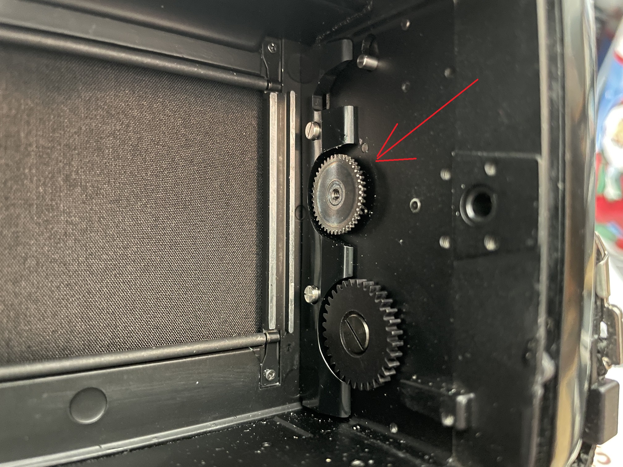

Here you see the frame counter wheel that the meshing gear on the insert MUST fully engage and run uninterrupted to transport the film properly. Adding the thickness of the film to the equation, undoubtedly will push the gear AWAY from the frame counting gear and cause intermittent skipping.

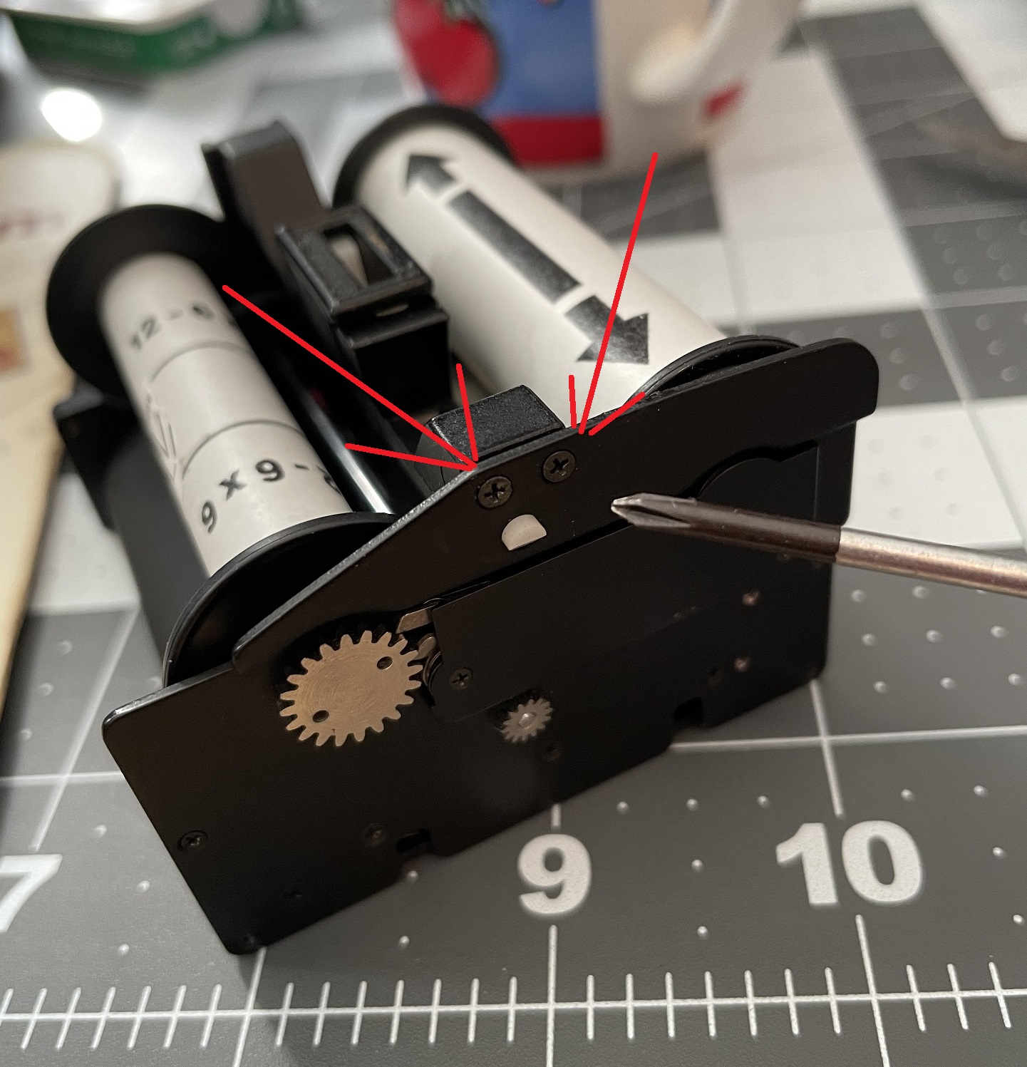

I was able to partially remedy the situation by loosening, but NOT removing, these two screws and playing with the tab that pushes the pin outward. Once I got the pin fully extended, I jiggled the loose end around several times to try to center the pin in the hole so it would not bind upon retraction. It took several attempts, but now the pin will extend, however the spring appear to be slightly weak or the pin not exactly centered, as when I insert it into the body of the camera, I have to carefully check to make sure the pin IS fully extended. I sometimes have to push the tab outward a bit to get it to fully seat and then everything appears to be fine.
It is not a total fix, but it might temporarily solve your problem, IF that is what is going on with your camera.
I need to do some more poking around to come to a more definite conclusion on MY situation, but suggest you carefully examine your insert for sticking or stuck retention pins.
PS: NEVER put lubrication on any part of your film insert! It will migrate to the film and film with oil on it will be a disaster!

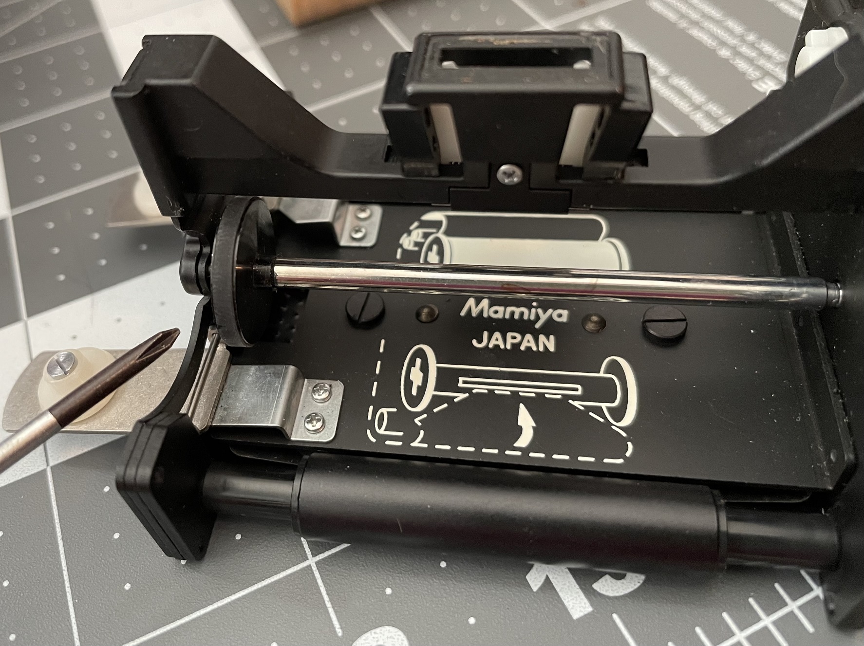

One other thing you can check on the insert is the follow roller. I am pointing to it with the screwdriver tip.
It must have good spring tension to push it back against the backing paper to turn the gear that moves the frame counter. It could have poor spring tension or the rubber on the surface of the roller might be hard/slick and need to be rejuvenated .
Either or both of these problems could also contribute to the problem.
