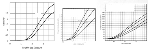

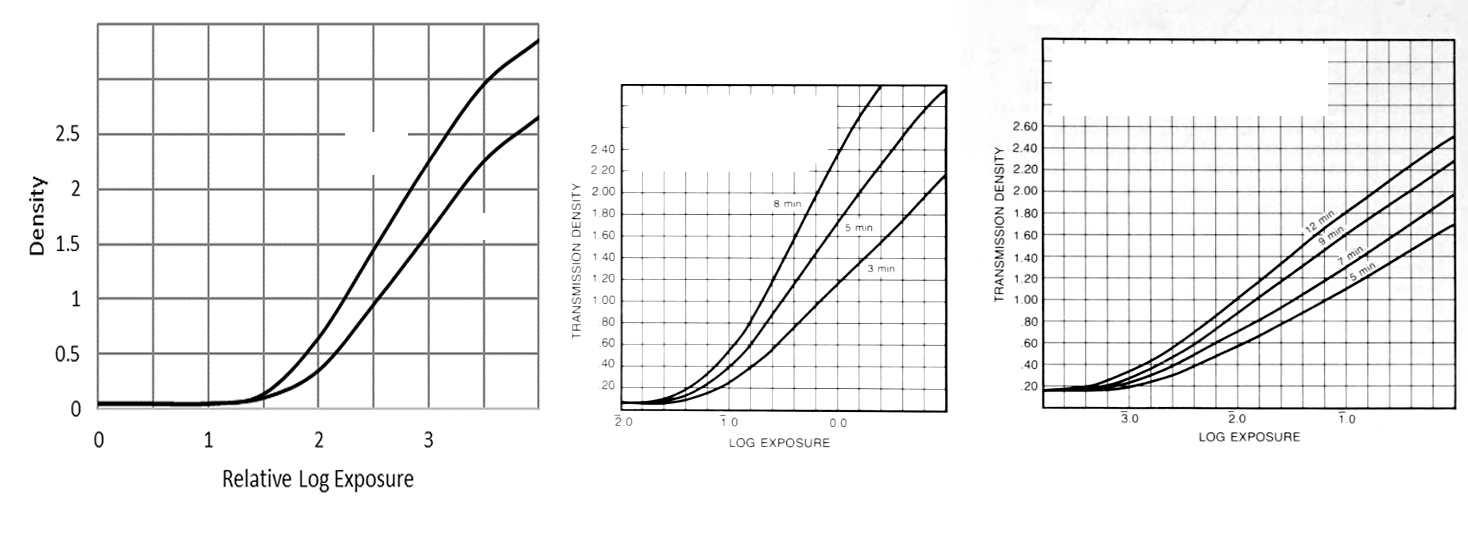

Any general purpose film will work for continuous tone separations. Kodak recommended Super-XX because it was their general purpose sheet film, in a range where many of their other sheet film products were geared towards very specific markets (an extension of the mentality of 'you push the button, we do the rest'). In contrast, most of Ilford's sheet film products were and are general purpose.
The attached (I've obliterated all identifying information as if you are even vaguely familiar with the relevant literature, you'll be able to identify them) shows you information that seems to be alien to those desperate to impossibilise dye transfer. Sometimes it's a question of the right developer, other times it might have been about an emulsion aimed at the standard choice of developer in a given industry.

Gosh, IB, you've sure got you facts mixed up, and seem to be in downright denial. And maybe a typo too - Portra 400 is a popular ordinary color neg film, and like many of them, has a relatively wide "latitude", but certainly not with respect to decent performance way out there in the Kuiper Belt; the realistically usable range is far less.
Super XX had only about I stop more of straight line down into the shadows as TMax films, that's all. And as far as nobody using TMax commercially for DT separation use, well, I'll simply spare you the embarrassment. Frog Prince was a tiny operation, way back when; I'm not referring to them, but to a fully modernized operation still ongoing, at least for awhile more.
No, not any general purpose film will work well for continuous tone separations. For separations of color transparencies each of the three narrow-band spectral exposures needs to be recorded on film as linearly proportional to the dye curves of the transparency. This requires proper spectral sensitivity characteristics, and there must not be any significant non-linearity in the response throughout the entire curve. Manufacturers don't normally publish how the spectral sensitivity changes as a function of exposure. The nonlinear effect of exposure on the spectral sensitivity of Tmax 100 will result in a characteristic curve that is not completely flat for some separations. The red or the green separations exhibit the greatest change in spectral sensitivity characteristics during exposure. According to Kodak Technical Publication F 4016, one can see a change in the normalized spectral sensitivity curve from 0.3 D to 1.0 D. Kodak Separation Negative films and Super XX pan film will keep constant tonal linearity across all wavelengths along the entire curve. Some of these problems with spectral sensitivity have been discussed in Gorokhovskii, General Sensitometry (1965) and Gorokhovskii, Spectral studies of the photographic process, London Focal Press 1965.
I have heard that Ilford FP-4 will work ok although it will give a flat curve at a higher gamma. It probably doesn't have a completely flat curve throughout the entire density range of the transparency. The latest datasheets I have of Super XX pan, indicate it was for some narrow specific markets, perhaps that wasn't always true.
The curve on the left is Ilford Ortho Plus, the middle is a Kodak film that might be Super XX pan in DK-60a with white light exposure, and the one on the right is definitely Super XX pan in HC-110 with white light exposure. Is this to try to say I don't know my curve traces very well, Lachlan? Curves of significance are made using narrow band light, not white light.
