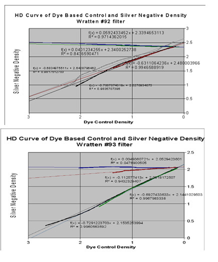

Here are some curves I made myself of Separation Negative Type I film showing the self-masking effect a few people asked about. An IT-8 Q60 Ektachrome color transparency tablet was used to make the test exposures onto the Kodak Separation Negative Type I (4131) cut to 4x5 sheet film. This has step tablets of pure cyan, magenta, yellow, and neutral at the END point. When this test is performed with Super XX Pan or any other pictorial film the derivatives of the curves (-gamma in this case) all show a value < 0, indicating an unwanted contrast of the dye spectral sidebands. No other exposures were used in these tests. These were both developed by hand in trays of DK-50 with a water pre-soak, but without any surfactants added. Some uneven development was observed and this is due to the rapid speed at which Separation Negative film develops. The neutral curves on both graphs diverge and is probably due to exposure being off slightly.
On the first curve on top a Wratten #92 red filter with a spectral cutoff at around 625 nm, was used used to make a red light exposure with the IT-8 Q 60 tablet contacted with the Separation Negative Type I (4131) film. The red curve is the main absorption band of the cyan dye. The green and blue curves, are yellow and magenta dyes, and the gray and black, are the 24 step neutral scale, and the 12 step END neutral scale, respectively. Here red has a gamma of 0.63, green gives a gamma of -0.04, and yellow gamma of -0.05 (smaller R2). These were all plotted from row A to row L on each column and re-checked multiple times. The gray curve is showing is some non-uniformity development since it doesn't align with the other curves. This step tablet runs at the bottom of the transparency and is 24 steps long.
On the bottom curve a Wratten #93 green filter with a maximum transmission of 545 nm, was used used to make a green light exposure with the IT-8 Q 60 tablet contacted with the Separation Negative Type I (4131) film. The green curve gives a gamma of 0.69, and the blue curve is showing a gamma on 0.4 with a very noisy result, likely due to development uniformity error. The red curve does not show any loss of contrast of the magenta sideband of the cyan, indicating a masking effect on the yellow dye, magenta unwanted absorption band only.
Curves of the blue light exposure through several blue filters do not show any masking effects, and all three absorption bands track as one would expect.
On other tests I have performed using filters of wider spectral bandwidth, the masking effect appears less strong but noticeable. A Wratten #92 red filter is too strong an effect for this film, but I'm posting it here to illustrate this effect. This is also interesting since the masking can be controlled by filter selection.

Those are such sketchy and abbreviated curves that it's hard to tell what is really going on. How many actual points did you read for each respective curve?
The curves didn't display very well and were originally of different dimensions. I don't know how I can modify that post now. I probably should have removed the linear curves generated by the algorithm, as it is a bit confusing. They were made on LibreOffice from 12 data points for each cyan, magenta, yellow, and neutral trace. One of the curves is composed of 24 data points. Possibly I can re-post the red light curves so the 2 top sideband curves are more visible.
An R2 of over 0.99 is a very good fit to a linear function, and the derivative of the linear curve is just the multiplier on the x variable. Seeing how the linear regression algorithm plots were very close to the measured curves, shows the additive and proportional property of the sideband absorptions.

The Wratten #92 is a longpass gelatin filter with a stopband around 620 nm (I think), and has a narrower spectrum passband than the Wratten # 29.
The Wratten #93 is a gelatin bandpass filter with a maximum transmission of 545 nm, and is aligned with the magenta dye absorption peak. Wratten #61 has a peak transmission around 532nm and is broader. Green 61 filter also leaks a lot of red light.
There is no reason these can't be used for making separation negatives. Wratten #93 and #94 (blue at 450 nm) are also darker and would require more exposure time. For Kodak Separation Negative film, the #92 red gives too much correction, but the green #93 might be useable.
It should read a gamma of about 0.004 but very noisy. From the curve it appears almost flat. Using any other pictorial film this value (yellow's magenta sideband) will have a gamma of about approximately 20% of the main gamma of green.

What derailed me is how you referred to Sep Film as "self-masking". Well, it's certainly not that, or anything different in that respect. What seems to be going on is that you (or someone whose notes you've adopted) managed to find a sweet spot in its spectral sensitivity and gamma nexus, "as if" it was doing something analogous to a mask in relation to just certain specific dyes. But change either the dye or the film and all bets are off. So this is really more like archaeology than R&D going forward, since that particular film is no longer made.
No, Drew I did not find a “sweet spot” this is analogous to negative spectral sensitivity. The magenta dye's red absorbing spectral sideband, is producing a negative value of gamma, on the graph above, where the main gamma curve is positive. That is a kind of self-masking effect.
I don't want to get into a highly technical discussion of silver halide spectral sensitivity. From a purely sensitometic point of view a red separation for example, will primarily record the cyan dye peak absorption (at about 650-660 nm), producing the greatest contrast. However it will also record the small amount of red absorption in the magenta dye which is about 8-10% of the cyan dye's contrast, because the magenta dye's spectral absorption curve absorbs some red light as well. This unwanted absorption reduces light exposure to the separation film (whatever film one is using, Tmax, Super XX, Sep. Neg. etc.) where magenta appears on the transparency, so according to basic sensitometry less exposure should be produced on the film where there is magenta on a red light exposure. Films responding only to the light exposure intensity will only produce a positive gamma for all of the three curves on the red separation. The self-masking effect appears to “sense” the magenta spectral sideband from the Ektachrome magenta in the red light exposure and add rather than remove density, a rather curious and interesting effect.
