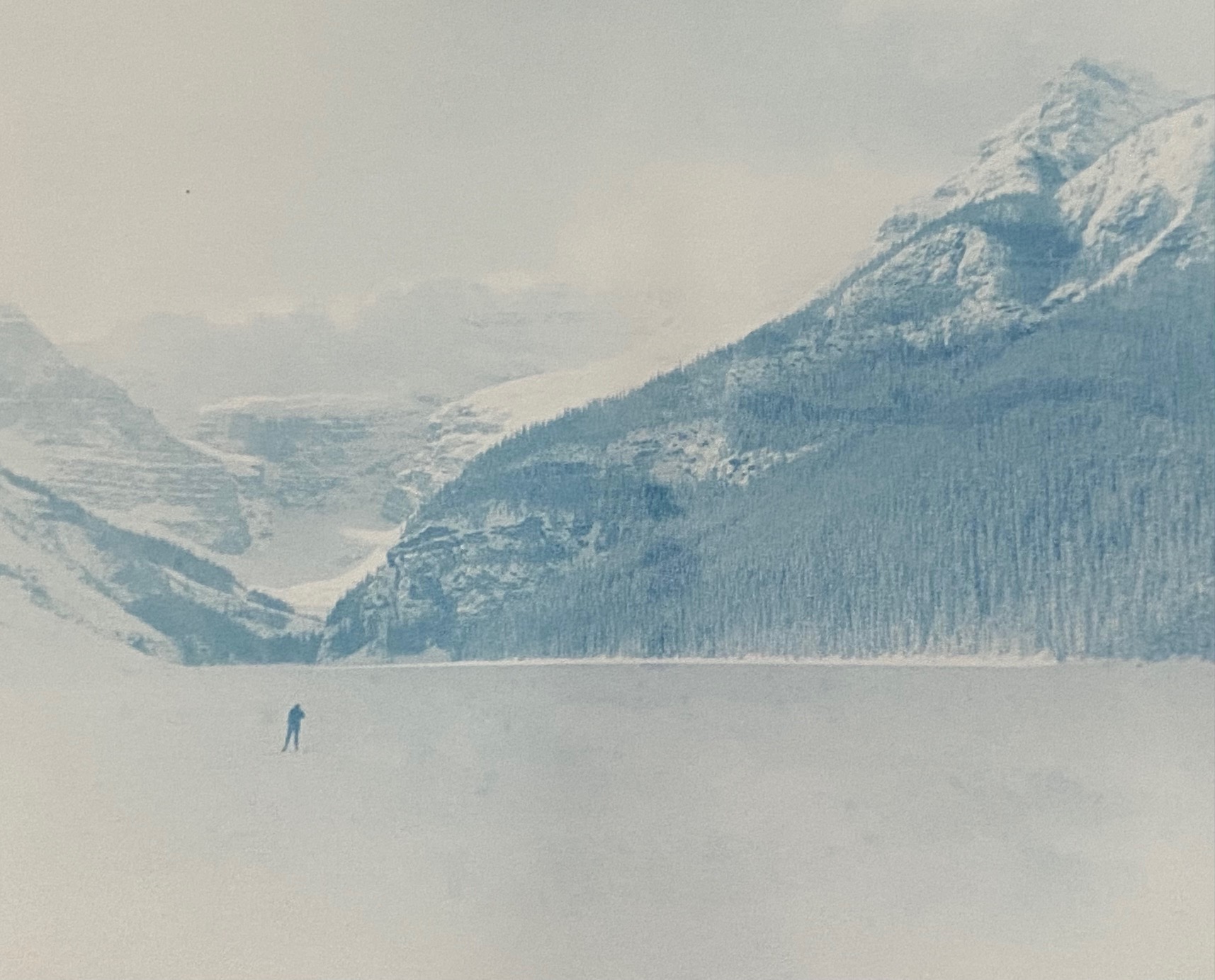

Here it goes:
First real print from 6x6 negative, enlarged to 10x10 inches. The sensitizer is old and has some fog/clearing issue and the coating was sloppy (I just wanted to see the enlarger work)
As far as focusing goes, I used white printer paper since as @douwe explained in his podcast, they have brighteners which fluoresce under UV, i.e. they convert UV to white light. I need to get some way to magnify this image so that I can see the grain... Focusing with white light itself probably requires to carefully think about focus shift with wavelength.

Here it goes:
Well done! Beautiful print.
If there is shift in focus based on wavelength, based on my experience it is really small. I focused my salt prints by eye and those look pretty sharp even that way. I used same paper type as "reflector" on base board.
edit: because of the alternative process looks I wouldn't be worried of needing super sharpness in prints.

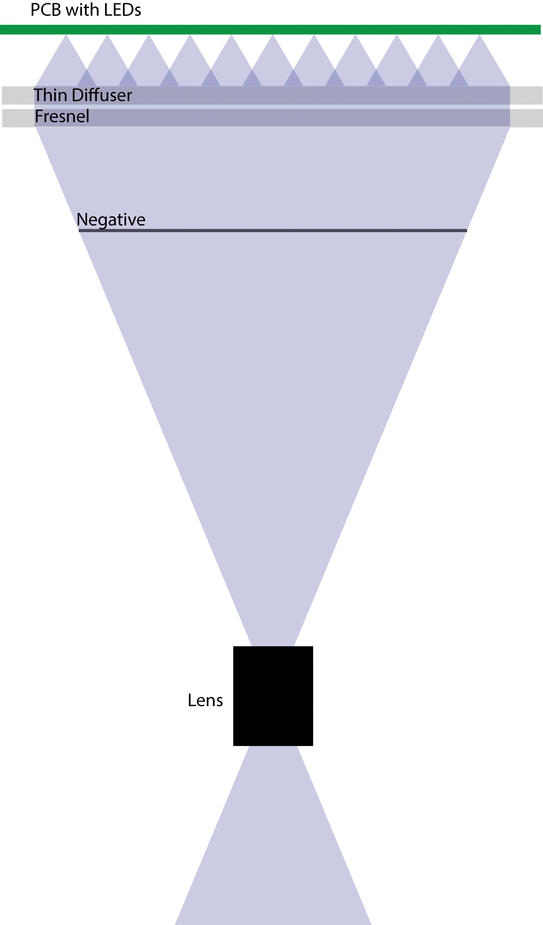

I've been following Alan's UV enlarger progress on facebook, and he directed me to this thread yesterday. I'm in process of designing an 8x10 LED enlarger I hope to build soon, and since reading this thread and talking with Alan, I'm wondering if it may be possible to make a UV head for it, or maybe even have UV LEDs in the same head as I would use for standard black and white printing. In thinking about this, I have a few questions for you guys.
My first question is about enlarging lenses. In the podcast you were on Douwe, you mentioned that old enlarging lenses are best because they are optimized for near UV light. I have a newer rodagon 300mm, which I assume is optimized for color enlarging. Assuming that would not be ideal, do you have any recommendations for what series of lenses I should be looking for? I've got a 30cm Zeiss Jena Apo Tessar, which being an uncoated 4 element lens would work, but it's only f/9, which is much smaller than the rodagon's f/5.6
My second question is about how much power I should want for the light source. It sounds like all of you used 40W UV LEDs, for 6x6 and 6x7 negatives. For an 8x10 negative which is roughly 20 times the area, some quick math gives me 800 watts as the power needed. 800 watts is quite a bit though, so would it be feasible to use 400 watts or something smaller? how long are your enlargement times with the 40 watt sources?
The last thing I'm wondering about is how to design the light source. It sounds like using a condenser is optimal as less light is lost to reflections. A traditional condenser requires a point source though, and if I need a 400 watt or 800 watt source, a point source that powerful probably doesn't exist. I had an idea on how it may be possible to solve that issue, I'd appreciate your input though. The idea is basically a hybrid condenser diffusion enlarger. I'm thinking I could have a bunch of UV LEDs on a pcb, a diffusion panel beneath it to even the light, and then a fresnel lens beneath that to focus the light onto the lens. Could that work, or would too much light be lost in the diffusion glass? below is a sketch of what I'm thinking.

Ethan, I'll leave other to answer more but I would bet on you CZ Jena as being good for passing UV - All the old (19460's or before) uncoated lenses (Wolensack/Nikon/Componon/Rodenstock) pass more UV than anything newer. Most of the coated lenses are blocking UV - I used an old Nikon metal 80mm in testing and that was supposed to pass 90%, UV - and it was one of the best - An old Componon 210 c1961 (non S) apparently covers 18x24 although not by Nikon specs, and it too was good at passing UV. I will (have already) look into Flouride lenses and *may* be able to get a 150mm coverage for a one off price if USD 1500 which is horrid, but I am guessing some people will not mind that cost if they can print 16x20 without internegatives. Once I get the replacement cc PSU I will be able to measure and test more, and I will post results of testing, good or bad. Douwe get 20 mins exposures on New Cyanotype and I hear that process is 4x to 8x slower than Salt where I will test, so I hope some the extra power I get might be transmitted and give me a result around 30 minutes. I live in hope....... Previously I contacted via the enlarger with 20 mins time and that was about x1 underexposed so........
Fraunhofer
Jan 1, 2016
208
East coast
Ethan, a hybrid enlarger will be much closer in efficiency to a diffusion enlarger than to a condensor enlarge. The key quantity is the emittance of your light source. Emittance being the product of the area of the light source times the solid angle it emits into. It sets a limit to how effectively it can be focused. You need to able to focus the light source within the entrance pupil of your enlarger lens. The diffusor increases emittance by a lot (that is what it is designed for).
However, I think your calculation is maybe not quite right: what sets the amount of light you need is the size of the print and not the size of the negative. So if you wanted to a 11x14 print than 40W will suffice for any size of negative. If you do 22x28 print you need 4x40W asf. Since typically one doesn't enlarge 8x10 negatives by the same factor as 6x7 ones, it's not quite that bad. Also the focal length of the enlarger lens has to go up in proportion to the negative diagonal. In turn, for fixed f-number of your lens the entrance pupil grows., so maybe Douwe's design can be "simply" scaled up to 8x10 (notwithstanding huge Fresnel lenses etc.)
You're absolutely right! Thanks for pointing that out. I'd like to make at largest 32x40 prints, but calculating for that rather than the negative size I only need ~300 watts, which is much more reasonable. I can probably use a 300 watt LED similar to the one Alan used in his design, with a pair of 12x12 fresnel lenses or something along those lines. Thanks!
