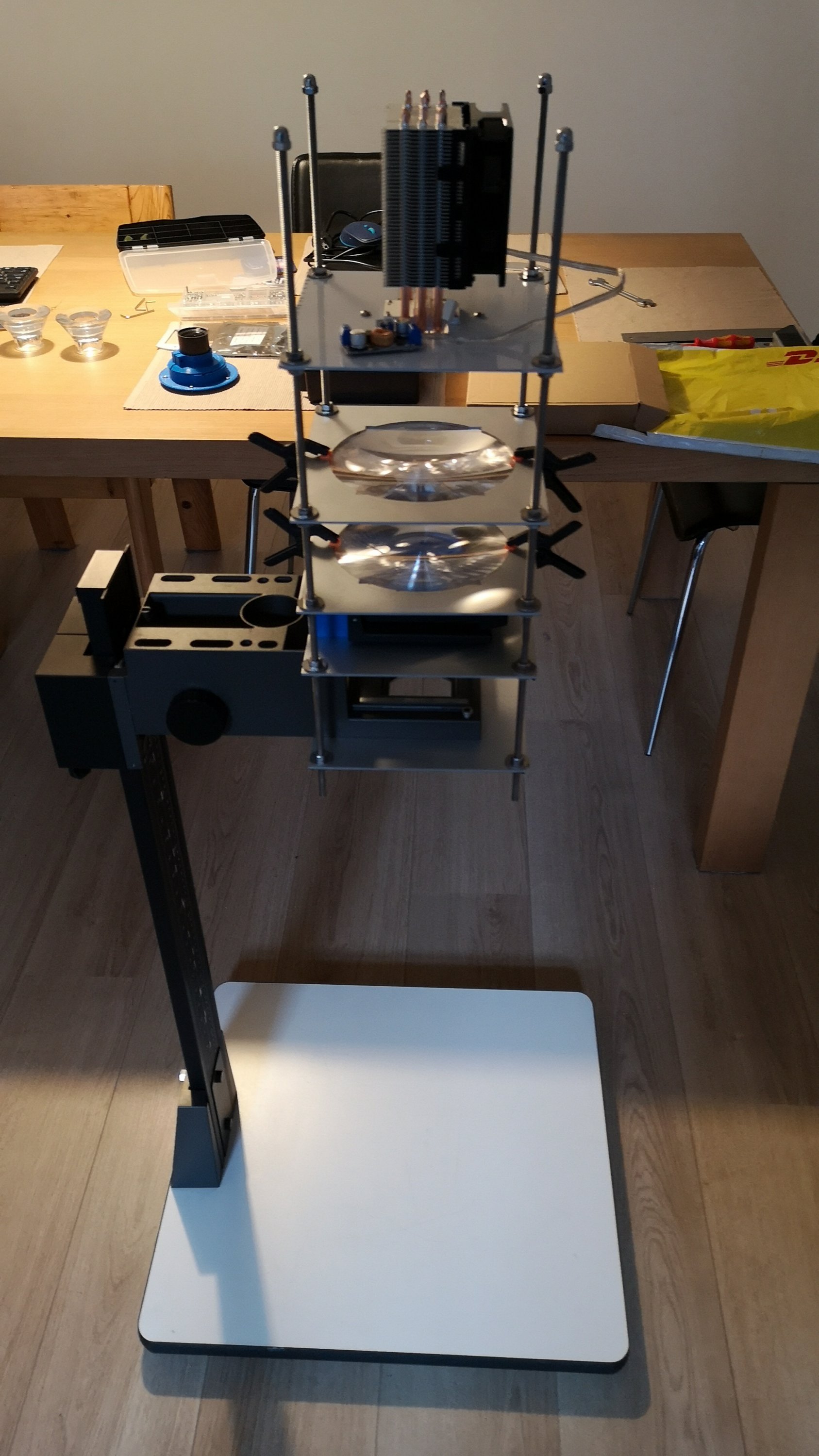

I just stumbled on this thread by accident, having built a prototype UV enlarger myself over the past weeks for cyanotype. I use it to enlarge my 6x7 negatives to A3 paper size (11-3/4 x 16-1/2inch, 297 x 420mm)
The key to this game isn't using as much light as possible, but making the enlarger efficient in terms of its light path and its transmission. That means using acrylic fresnel lenses for the condensor, and setting the whole thing up as a point source enlarger. For point source enlargers, the light source should be smaller that the exit pupil of the enlarger lens, otherwise the light cannot pass the lens. So using the latest high power UV LEDs with a quarz lens is the best approach. the dies in the LED I use measure 7x7mm, this allows me to use a regular 100/5.6 enlarger lens.
Using a LED with a larger cross-section is not effective; you'd need a faster lens to pass all the light. There are not many fast enlarging lenses, and fast lenses that do exist are either poorly corrected for near UV, leading to massive focus shift, or optically inferior for the application due to field curvature or poor sharpness for other reasons.
I also found that for the cyanotype process a 385nm wavelength works very well. There is a trade-off between transmission of the enlarger lens and sensitivity of the cyanotype process. Below 380nm the transmission of enlarger lenses falls off steeply. The spectral sensitivity of cyanotype really drops off at about 390nm. So there is an optimum based on the two factors.
Focusing isn't really an issue. There is a focus shift also with enlarging lenses that are corrected to near-UV (they pretty much all are), so a grain focuser is not very useful. I use copier paper on my easel. The optical brighteners fluoresce blue as a result of UV illumination. With a pair of UV safety glasses you can focus by eye. If you print the same format all the time, you can fine-tune with a piece of paper placed on a wedge.
Interesting! Where did you source the fresnels? I was under the impression that acrylic blocks a fair amount of UV, but based on my tests it seems the condenser lenses are the biggest issue in my current design so I'm eager for an alternative.
What sort of exposure times do you get for A3 (which is ~5-6x magnification by my crude math)? Any issues with heat affecting the negative?

I got the fresnels from Aliexpress. You can find a lot of diameter and focal length combinations, but it is a bit of a puzzle to find a suitable combination for your condensor system. As far as I know the transmission of acrylic (PMMA) for ~385nm is about 90%. The transmission drops off at lower wavelengths around 300nm. The big party trick of the fresnel lens is how thin it is. Al things being equal, a fresnel lens will have higher transmission because light passes through less material than with a comparable glass lens. Less material equals less attenuation.
I print 6x7 negatives in a regular Durst negative carrier with glass inserts. Exposure for an A3 piece of paper is 20min-40min depending on negative density. The enlargement is about 5x. I haven't noticed any adverse effect on the negatives. Perhaps this is due to the larger surface area of the negative compared to 35mm and the glass inserts. A regular lightsource would of course also put out Infrared light, but a UV LED doesn't.

It's very important to think about cooling, but it's not very critical in my set-up. I use a 40W LED, that probably emits 15W in UV light. The 25W in heat produced at the chip is carried away by a processor cooler quite efficiently. The chip is mounted on a copper core pcb. The 15W in UV light is of course mostly transmitted. The diameter of the fresnel lenses is 150mm, so any heat is also spread over a large surface area. Everything is cool to the touch. The light does concentrate in the enlarger lens of course, but I haven't noticed a build-up of heat there either.

So, I was a guest on the Homemade Camera Podcast, and we talked about my UV enlarger. I thought you'd be interested to see it!

I watched the video but am still confused about the light source. How did you make it? Are you using water in the heat pipes? Are you letting it boil then closing the ends with a torch? What kind of power supply are you using?

It's much less complicated than you might think. The cooler is a pc processor cooler and the heatpipes are part of it. I just bought one. Every processor cooler has a flat surface that sits on top of the processor to carry away heat. In the enlarger the copper pcb with the LED sits against that surface of the processor cooler.
The power isn't so hard either. I use a 18V power supply that can handle 6 amperes. From that power supply I run two buck boards that can control current and voltage. The first powers the cooler fan at 12V and 0.15 amperes. The second runs the LED at 14V and 2.8 amperes (check the data sheet of your LED).

@douwe thanks for clarifying. Could you help with picking correct fresnel lenses? It is otherwise a completely shot in the dark for me. I would like to build 5x7" enlarger so maybe I could consider doing it for both UV and RGB :smile:
