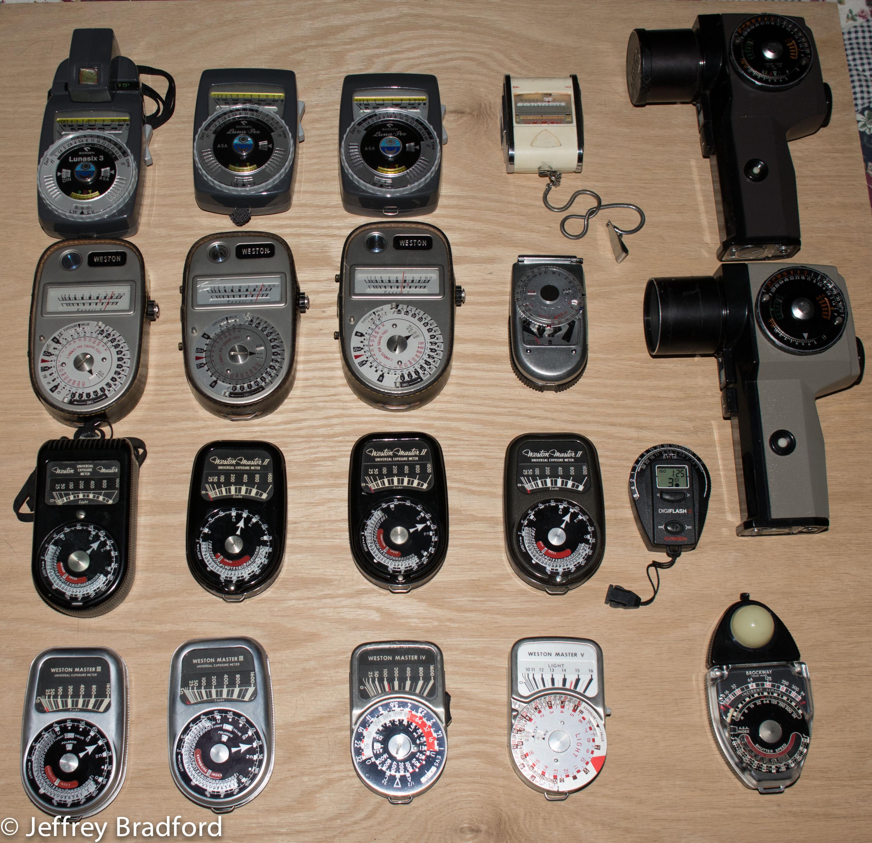

Jeff Bradford
Jan 14, 2015
421
Rolling Prairie, IN
The trick is to pick a meter and pair it with a camera.
If the meter is consistent, you can work it out from there.

Wide variety there. I once had the Pentax Spotmeter(IV?) and the Sekonic at the bottom right...308, I think it was.
