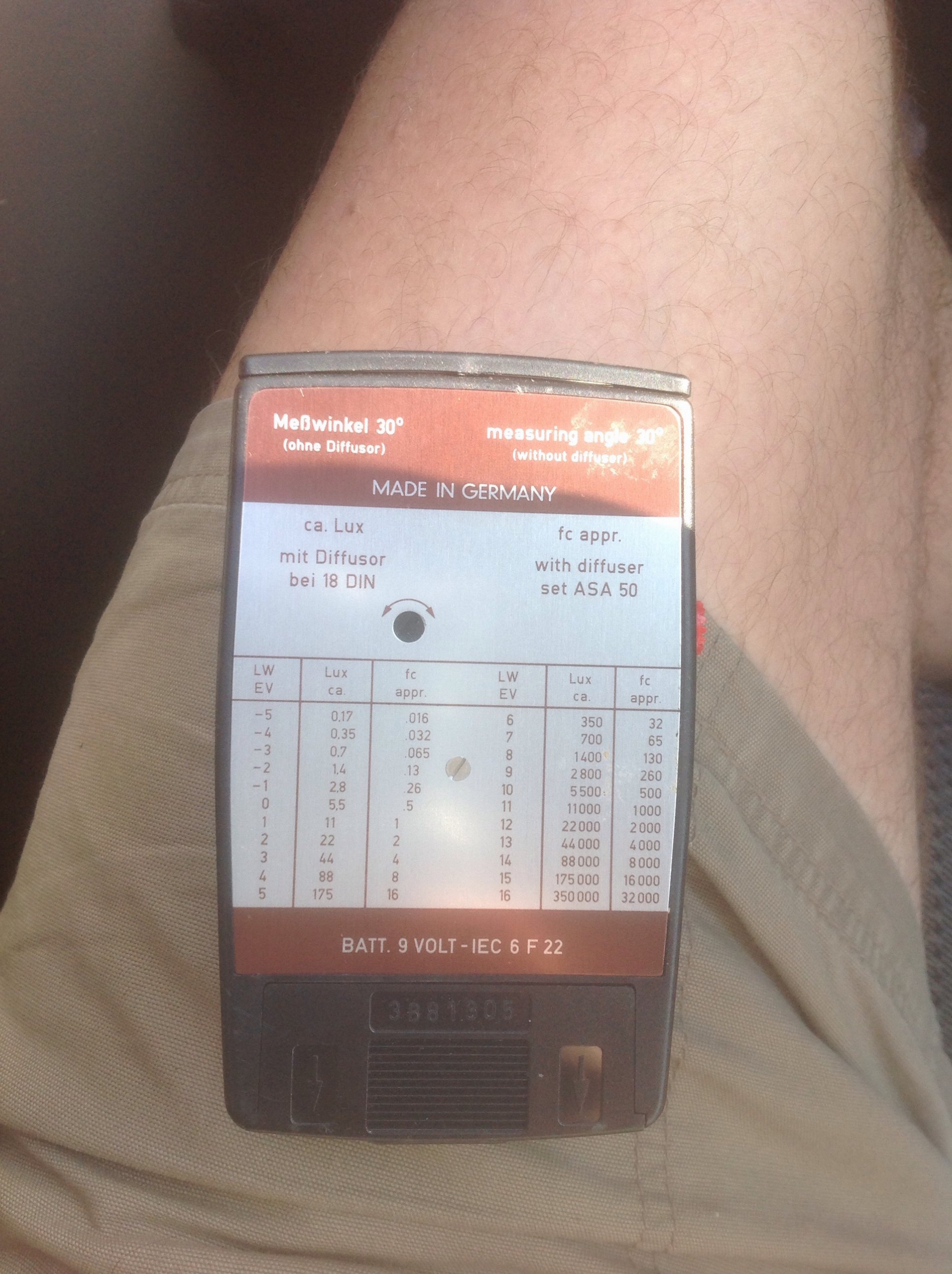

On the back of the meter there is a small plastic screw head. Turning it skews the meter needle left and right. This should fix your reading issue. I cannot speak to the loss of linearity though I have heard of it. My SBC (Silicon Blue Cell) decided to just stop working a couple years ago. I fixed it with a Sekonic 308S; less aggravation.

Here is the Back of my LunaPro SBC. You can see the black adjustment pot off set from cent a little high and left.
That adjustment is to bring the needle over the green mark just to the left of the 3 on the left side. It's adjusted by disconnecting power to the meter and that screw turned until the needle lines up with the green mark. It's spot on.
I took the little screw out from the back thinking the two halves would separate so I could have a look, they don't.
If you want to separate the halves, you must unsolder the three wires that come off of the nulling potentiometer and attach to the circuit board. You can then take a look inside. There are four pots accessible through the PCB that allow adjustment. Each has a different function. Tweaking these pots without knowing which is which will guarantee making the meter unusable!
I'm not going to get into that. It's just unstable and unusable far as I'm concerned. I put the Variable Angle attachment on it today and actually got better and closer to camera readings with it than without and didn't even compensate the +1 stop for it. I just left it set as if I were using it normally. That's just not right. Without the attachment it comes closer 70% of the time giving me what the camera indicates as long as I set it on ASA200 instead of 400. It's just unpredictable.
Forgot to mention - the principle of operation is designed around the nulling potentiometer, which, if it hasn't been used in a while, will form oxidation on the wiper/resistive element. Through use, the oxidation is worn away. This oxidation is simply an added resistance that will introduce an error into the nulling process. Working the dial back and forth a couple of dozen times might improve the accuracy if it has been in storage.
Once I take a reading and turn the needle to null, it wants to go past it. I try and bring it back and it wants to go past on the other side. I have to do it slowly or I cant center it. The meter hasn't been used in a long time so like most electronics I guess it needs a bit of exercising.
People laugh at me when I tell them I had to exercise my Marantz receiver and Pioneer RTR tape deck. You have to keep the juices flowing.

I've been fiddling around with this meter and it's been most consistent with underexposing one stop about 90% of my test. I rotated the dial to -1 on the LW/EV scale and now it's spot on with my other cameras. Wish I knew what to tweak inside to fix it there rather than do what I did to get a proper reading.

Today I thought I'd break out the Gossen Luna Pro SBC meter to see if it was still up to snuff if needed...if wasn't. With a new battery and all things checked it was consistently reading about 1 stop under two other known good cameras, the F2A and Nikkormat FT3. Those read the same thing. They would read in sunlight 125 @ f/11 whereas the Luna Pro indicated f/16.
I decided to see what my D7000 thought of the Luna Pro's exposure recommendations and used what it showed. Each shot was underexposed by 2/3-1 stop in comparison with what the D7000 meter displayed. This was true in sunlight or shade with the Luna Pro showing underexposure each time.
I'm not sure how to fix this problem, if I can. It would work if I set the ASA dial to 200 instead of 400 but, that's not a proper fix. Any suggestions? I know there's nowhere to send it to have it recalibrated anymore most likely.
As I indicated before, the correct exposure reading for the SBC on a sunny day with no clouds in incident mode will be f16 at 125 for ISO 100. There appears to be nothing wrong with your SBC. Nikon camera meters will be making readings in reflected mode and will usually indicate +2/3 stop more.
Don't monkey with the SBC; it is calibrated for slide film and will indicate slightly less exposure than the Nikon camera meters. If you don't like the exposure you're getting from the SBC, simply adjust the ISO or Exposure Comp dial and make photographs. Reflected camera readings vs incident SBC readings is comparing apples and oranges. I have six Nikons from the F2 to the D7100 and they all indicate about +2/3 stop more exposure than my two SBC meters, my Luna Pro F and a Luna Lux (these meters are all calibrated with the same test equipment). Also true for my two Sekonic 448s and my Sekonic 398 II. Your meter is doing what it was calibrated/designed/intended to do.
Make some photographs!

I feel a hand held meter should meter the same thing as your other cameras. If it doesn't one of the other is wrong. You'll get a different exposure at 125@f8 than at 125@fll and that's especially noticeable with slide film. I can set the SBC on 200 and I'll get a proper reading in accordance with my F2A or Nikkormat FT3, both which are known to be accurate. If I meter another scene the SBC will not read the same scene as the other two cameras.
I think it may just behoove me to send it to Quality Light and see what they have to say. I don't mind having to change the ASA on the meter to compensate but when it reads differently than the other cameras under varying light conditions, that seems wrong to me-it should read the same in sunlight, partial sunlight or shade as the cameras. Else wise, what good is it? If it was calibrated to underexpose approx. 1 stop, that hardly seems industry standard.
