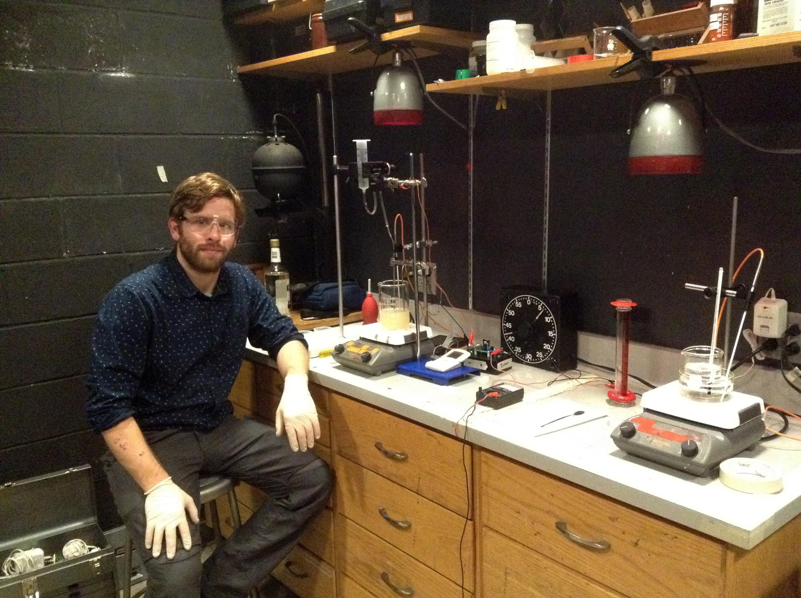

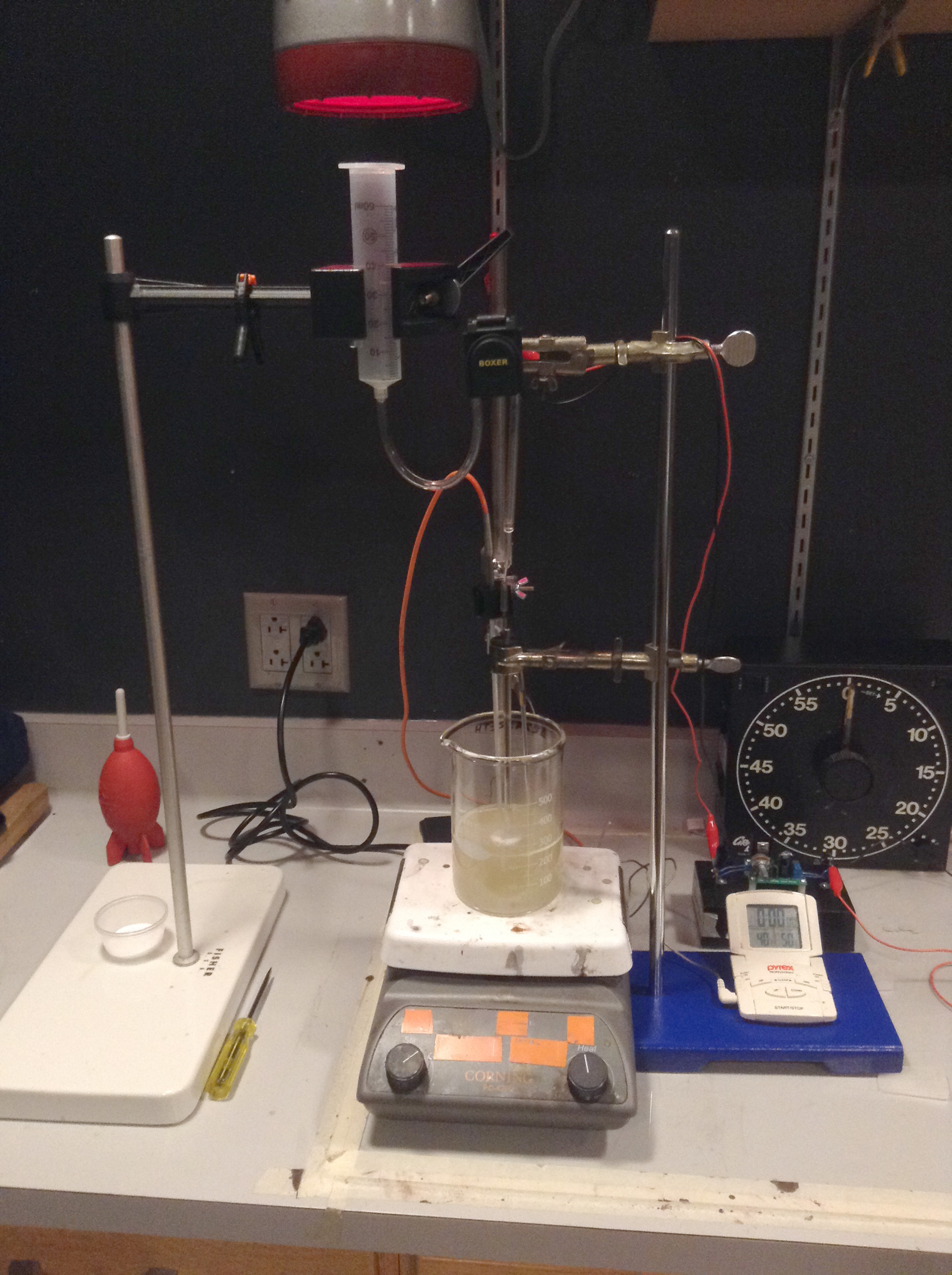

I was with Nick this afternoon when he made a 600ml AgBr emulsion using the new pump setup.
Attached is a photo of Nick at the GEM before starting the emulsion make and a closer view of the apparatus.
Thank you, Prof_Pixel. Got a question: at the end of the Ag run through the pump, is there any problem draining the last of the silver solution from the line? Is he using something to flush the line?
The way Nick has the 'plumbing' arranged, the pump clears the lines.
Both filling and clearing are important steps and part of the timing for making. If you use an exact amount of solution you just pump dry, but this is not always the case.
