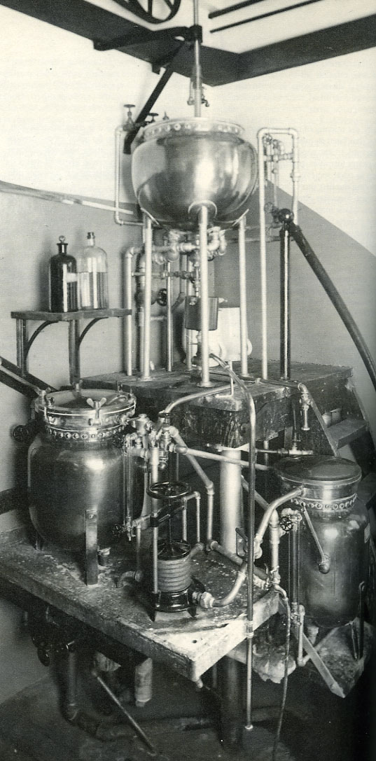

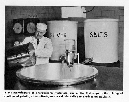

To answer your other question about making, here are some photos, the first being from Eastman's day, and the second from the '50s.
The second is a photo of an early making apparatus believed to have been used for "boiled" emulsions or "ammoniacal" emulsions. The first shows two production sized "percs" in the background, and one small "perc" in the foreground. In production the total volume could be up to 1000L but in research it was typically around 10L.
PE
