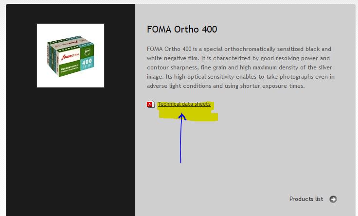

If you're referring to my mention of Foma R100, one reason you might use it for negatives is if you shoot a 16 mm camera that needs sprocket holes; this is one of only a few black and white stocks available in small quantities for single perf and double perf 16 mm (as well as double 8) -- but many folks who shoot, say, a Rollei 16 won't want slides half the dimension of a 35 mm, but would rather have a negative from which to make prints. Sure, Kodak and Ilford make B&W movie films, but Kodak's minimum order is huge and the stuff isn't commonly stocked at the regular still film dealers, while Ilford appears to make this only during the annual "ULF custom cut" event.

Just recently Foma itself has marketed two new negatives film for this pourpose...
At those links, Foma doesn't do a good job of making it clear what cine formats they offer, but 16 mm single- and double-perf are the most common.

What's that's not clear?
Only that I didn't see a link that led to that information. It's what I expected, though -- 16 mm single- and double-perf (the formats most submini shooters want), and double-8 (the minimum order for DS8 is probably more than anyone I know would be willing to pay, but from Foma isn't likely enough to put off a budding cinematographer). Added to the R100, that gives Foma a pretty good range of B&W cine films.

@Alessandro Serrao Data sheets is where I'd usually expect to find information like H-D curve, developing times, reciprocity correction, etc. I'd normally expect a list of available formats to be separate from that.
Ilford does it like Foma and Fuji did it like Foma.
So what's the problem with that, Donald?
Nothing, it's all down to me not having thought to look at the data sheet link for supported formats.
