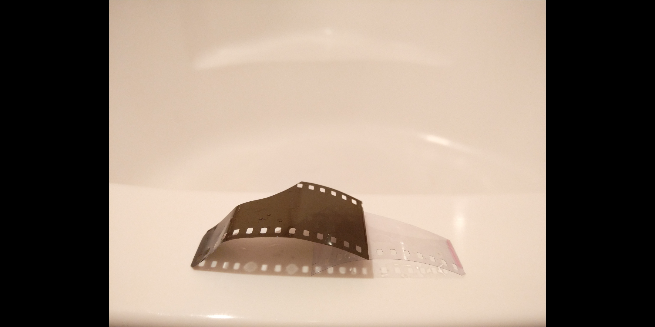

You can cut a small piece of it and just dip it in fixer for some minutes. What does the fixed film look like?
Neat, simple idea, I like these - I'll do this this evening with hypo fix

Let's see how that fixer test will look like with R 100 Vs Superpan 200 / Aviphot 200

R 100 on the left, Superpan 200 / Aviphot 200 on the right side, both straight out of hypo fixer, 10min fix time.
So tell me more how this film can be developed as negatives, I'm all ears.

Yeah, maybe he has access to some magical, metallic silver dissolving water, who knows.
