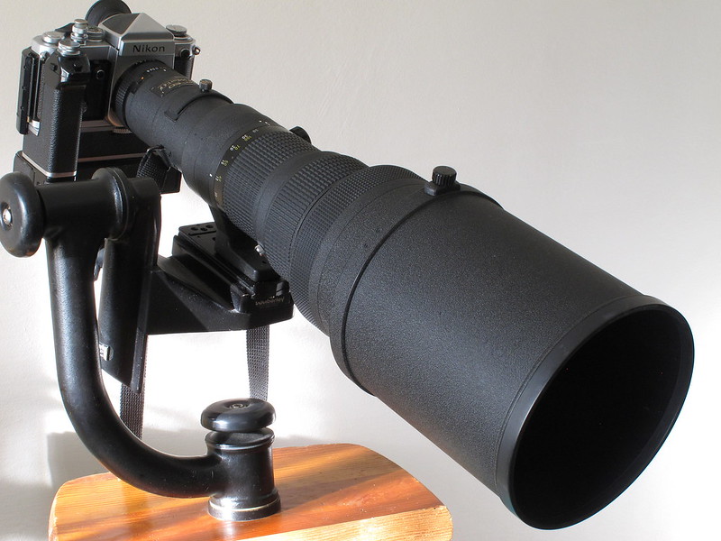

I use the Nikon 500mm f/4. If a used one does not meet your budget constraint, you may be able to find a used third-party version for less money.
Long 500mm Lens by Narsuitus, on Flickr
