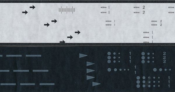

It is just the leader and trailer, yes?
Yes.
It seems that the start arrows are inaccurate as they are for 120 film. In my GW690III I managed 15 1/3 images, but there was plenty of room for 16. The start arrows come up too soon for 220 film.
Weird thing - it stinks like mothballs. Never noticed the smell of backing paper before on any other 120 or 220 films that I have used
I wonder if this came from a bunch of long stored 120 backing paper.
Does anyone recognize the backing paper?
I don't have any 220 backing paper - other than as part of a few remaining rolls of Portra that I don't want to open now - so I can't measure the 220 starting position for you.
From a quick Google search , the backing paper appears to be Shanghai GP3 backing paper for 120.
The mothball smell says a lot, I think.
I am no 220 film expert but the photo of the backing paper looks like it was 120 paper cut and stuck to 220 film. To me it looks a bit like a homemade job.

Well yes, my photos of the backing paper in this thread show the text 120 all over it.
