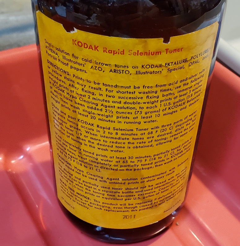

I have a have full bottle of Kodak Rapid Selenium Toner from 1998, that still works, so it can last years. Once diluted, it will last a few months or longer, depending on dilution. Store in a cool place.
mshchem
Nov 26, 2007
14,627
Iowa City, Iowa USA
Pretty sure the date? on the bottom of the label translates to November of 1970. This stuff is alive and well. 😁
