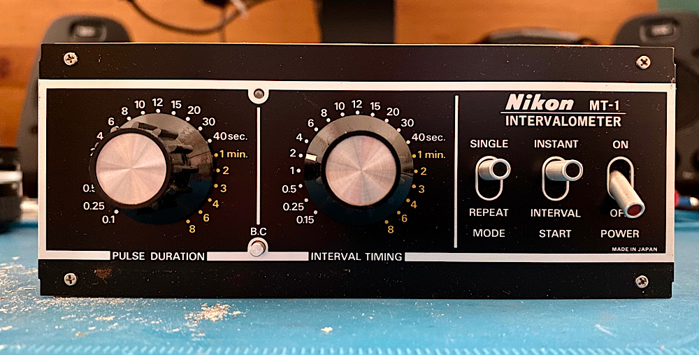

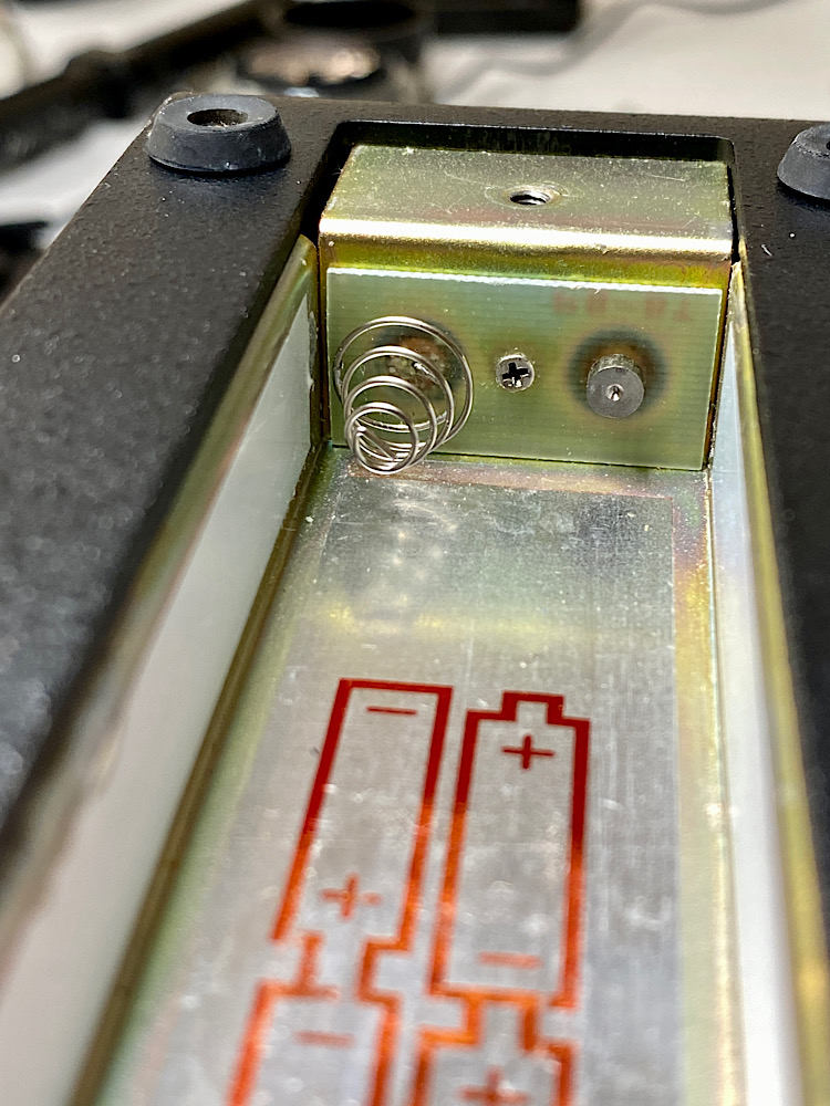

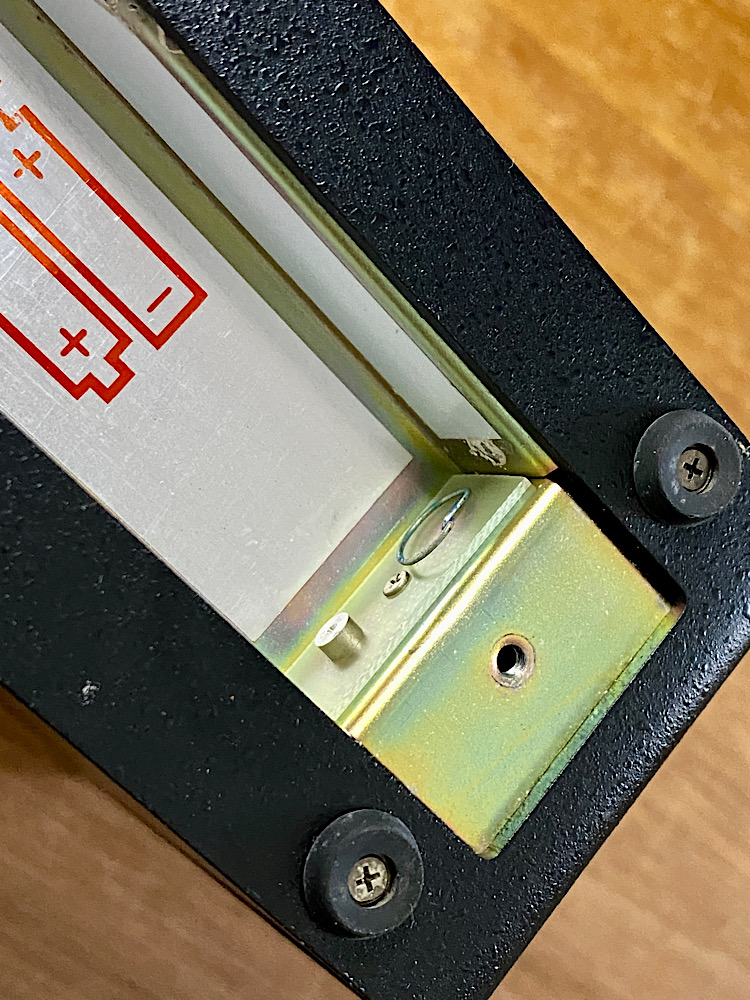

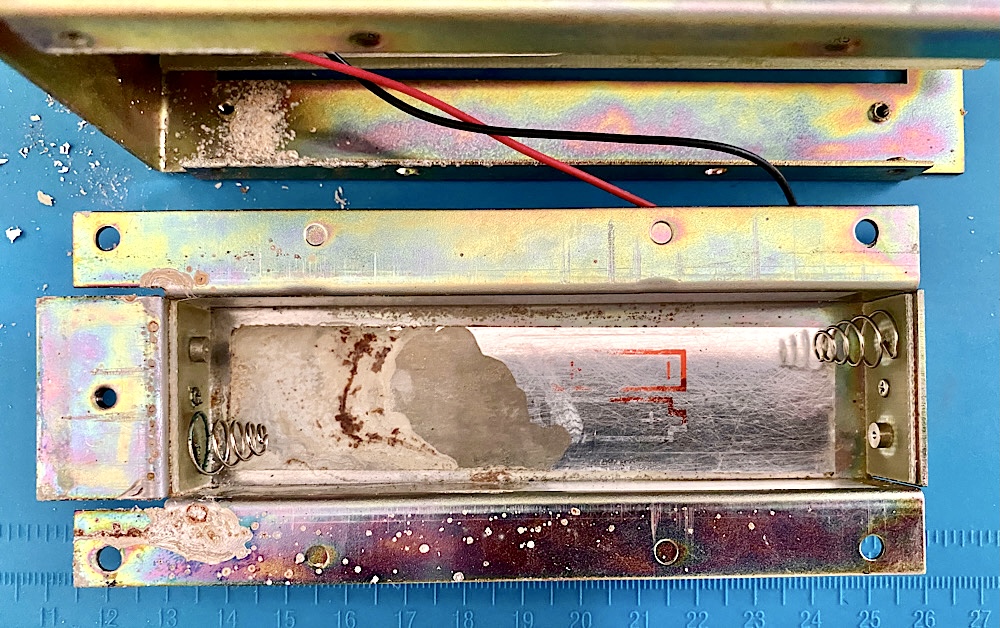

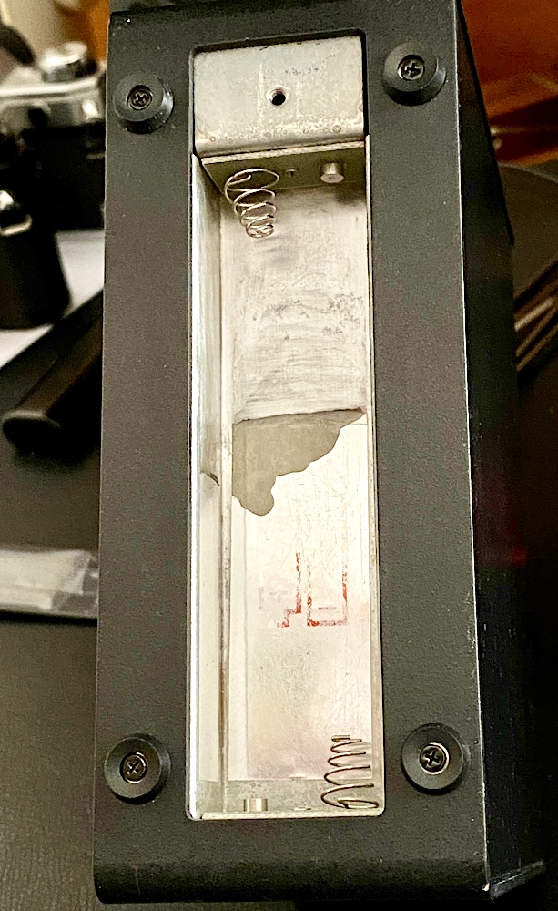

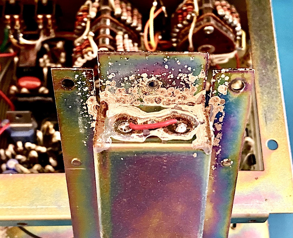

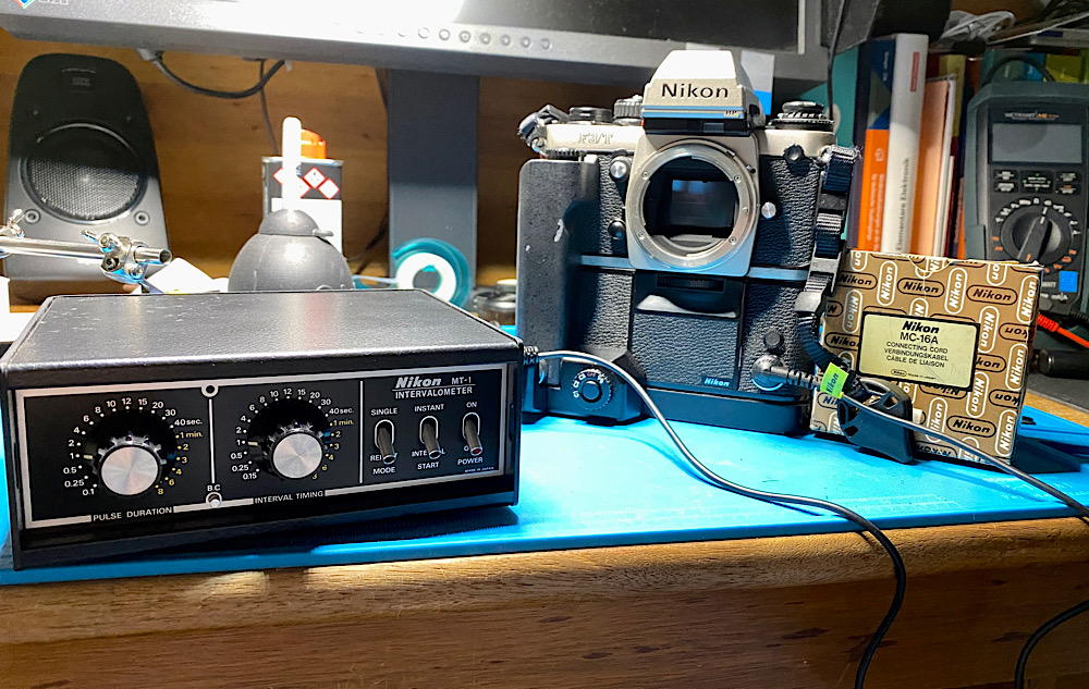

Last year I repaired battery acid damage on two fairly rare Nikon intervalometers.
The devices allow the motorized camera to be triggered automatically at adjustable time intervals and frequencies.

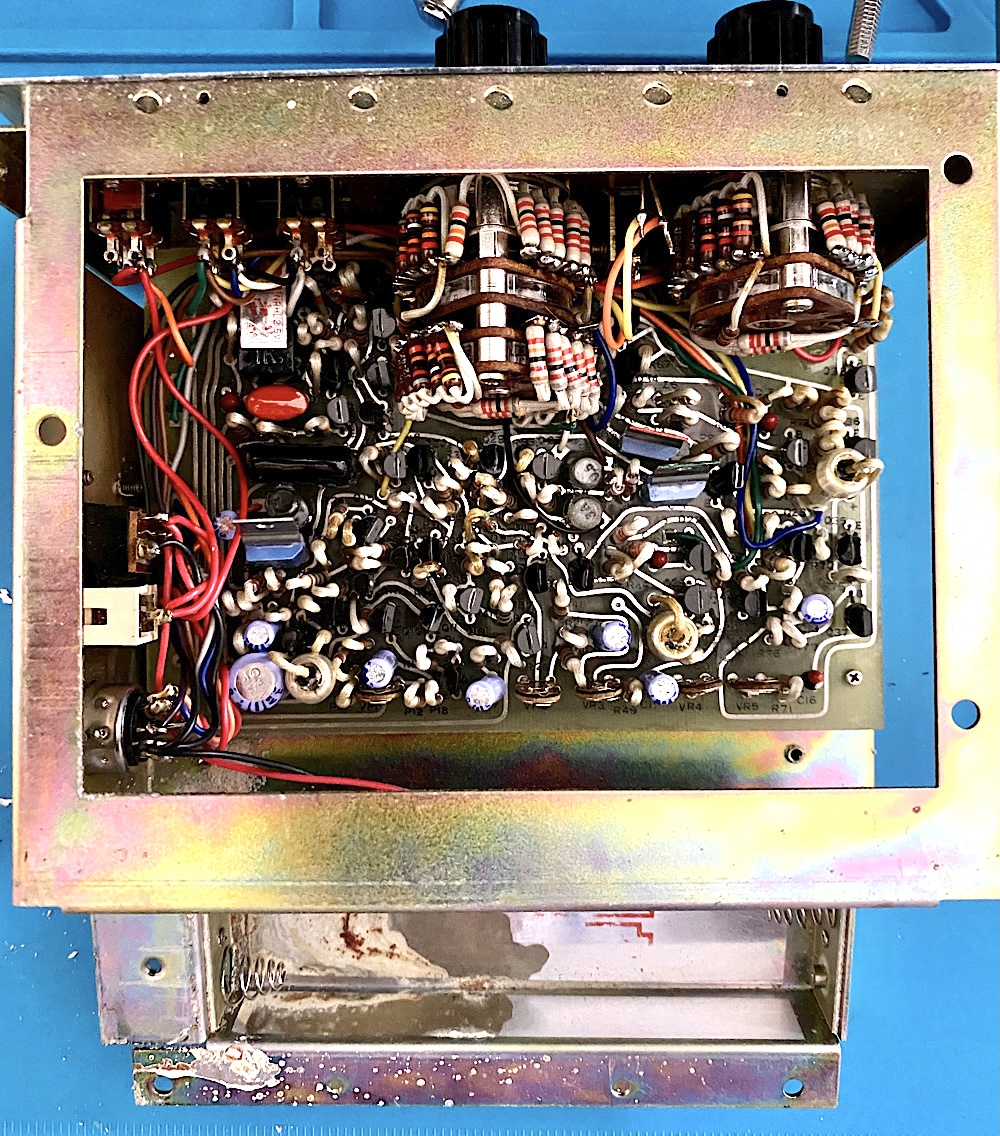

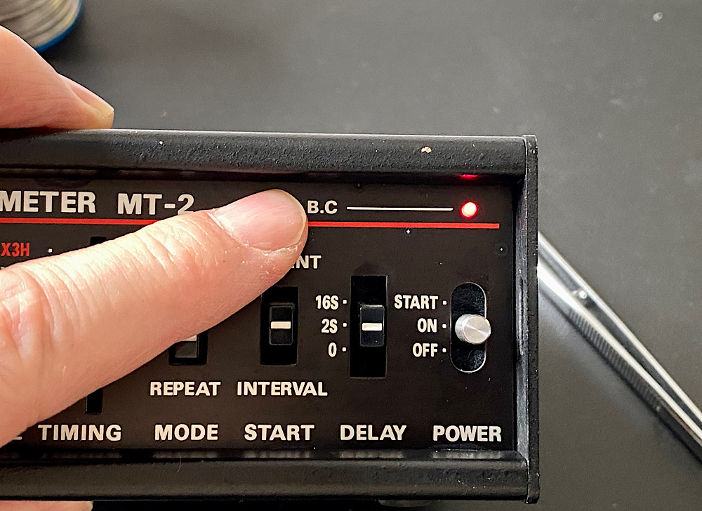

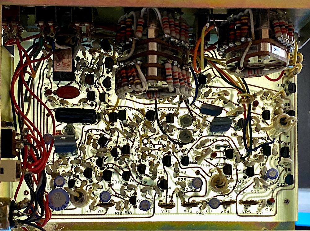

The MT-1 dates back to the 70s and works analog:

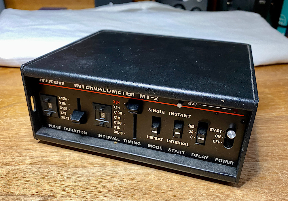

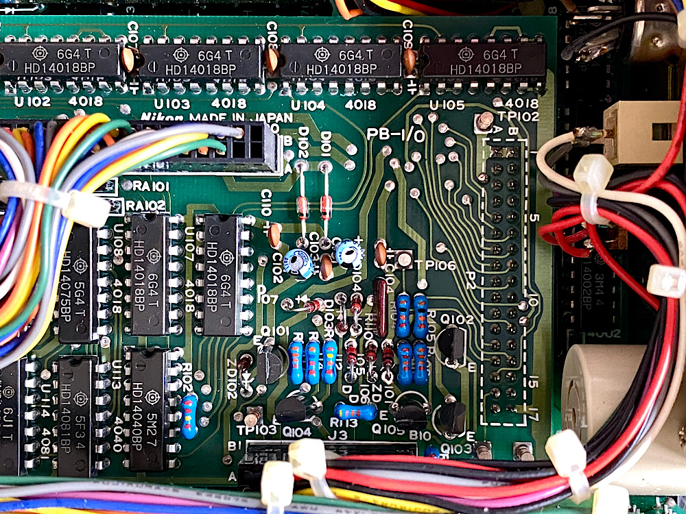

The MT-2, the successor model, appeared in the 80s and works digitally. A TTL grave 😛
With my level of knowledge, I should at least understand the basics of what's going on in there 🙃
Digital, well, I disappointed my teacher because I didn't want to do the work with the Arduino. As soon as I started programming, I was unhappy. That doesn't suit me at all.

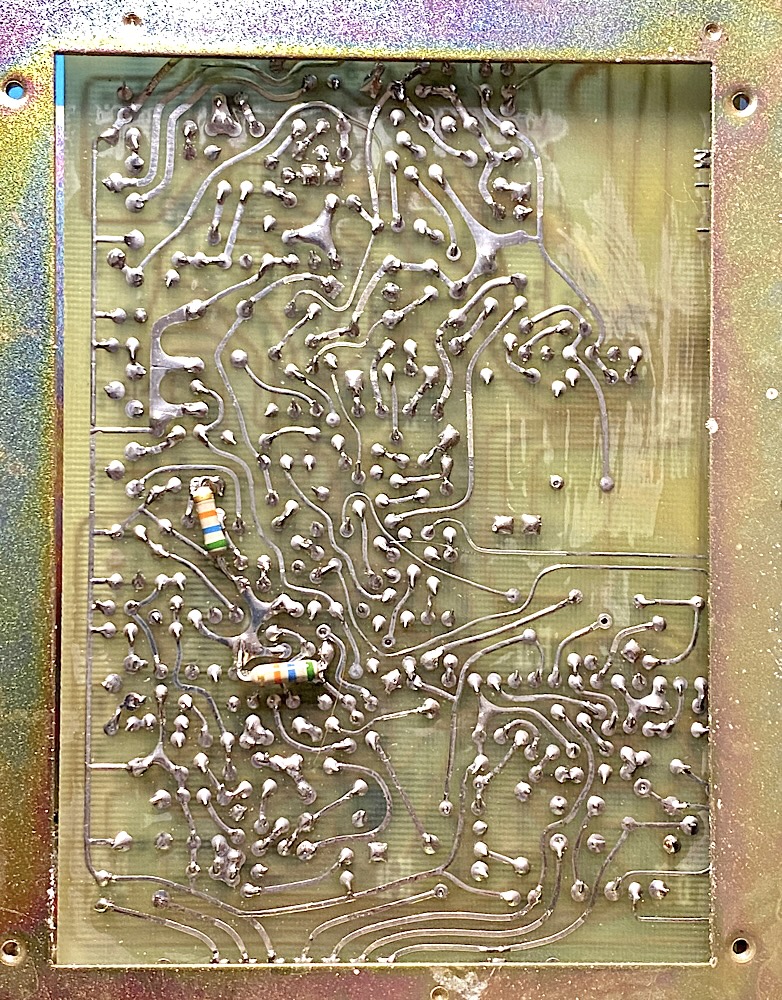

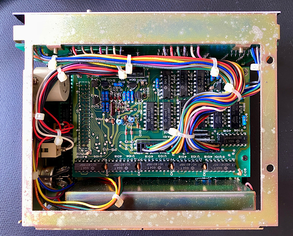

I can relate; I've got the same thing, just the opposite! The MT-2, I could find may way around. The MT-1...well, it would cost me a whole lot more time, I'd really need a schematic to go with it, and even then I'd appreciate it if someone were around to walk me through it!
The MT-1 … even then I'd appreciate it if someone were around to walk me through it!
That can't be me 😉
But haven't you seen all the resistors there?
A fantastic machine, it works with invisible voltages. A real electronic brain!
U = R * I
Any further questions?
Both were certainly expensive in their time. Cutting-edge technologies. And with the MT-1 there's probably a lot of working time too, that looks like soldered by hand.
And both intervalometers work 🙂
Only on the MT-1 does it look like electrolyte is leaking from this electrolytic capacitor (it should be one). But if it is not a particularly dimensioned component, it can be replaced. If necessary, by connecting several capacitors together to get the target capacity.
Where did I get my book with the formulas ...
Wonderful toys!
By the way, the connecting cable between the intervalometer and motor drive is super rare.
Yeah, that one looks like toast. If it's on a power supply line (which is often fairly easy to determine by poking around with a continuity meter), it's not critical and any decent-value cap will do.
Otherwise, parallel a couple of caps like you said. When putting them in parallel, you can simply add the values.
