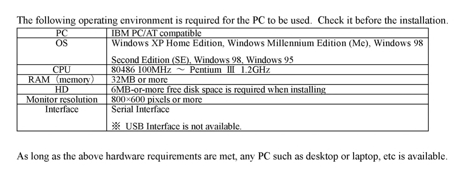

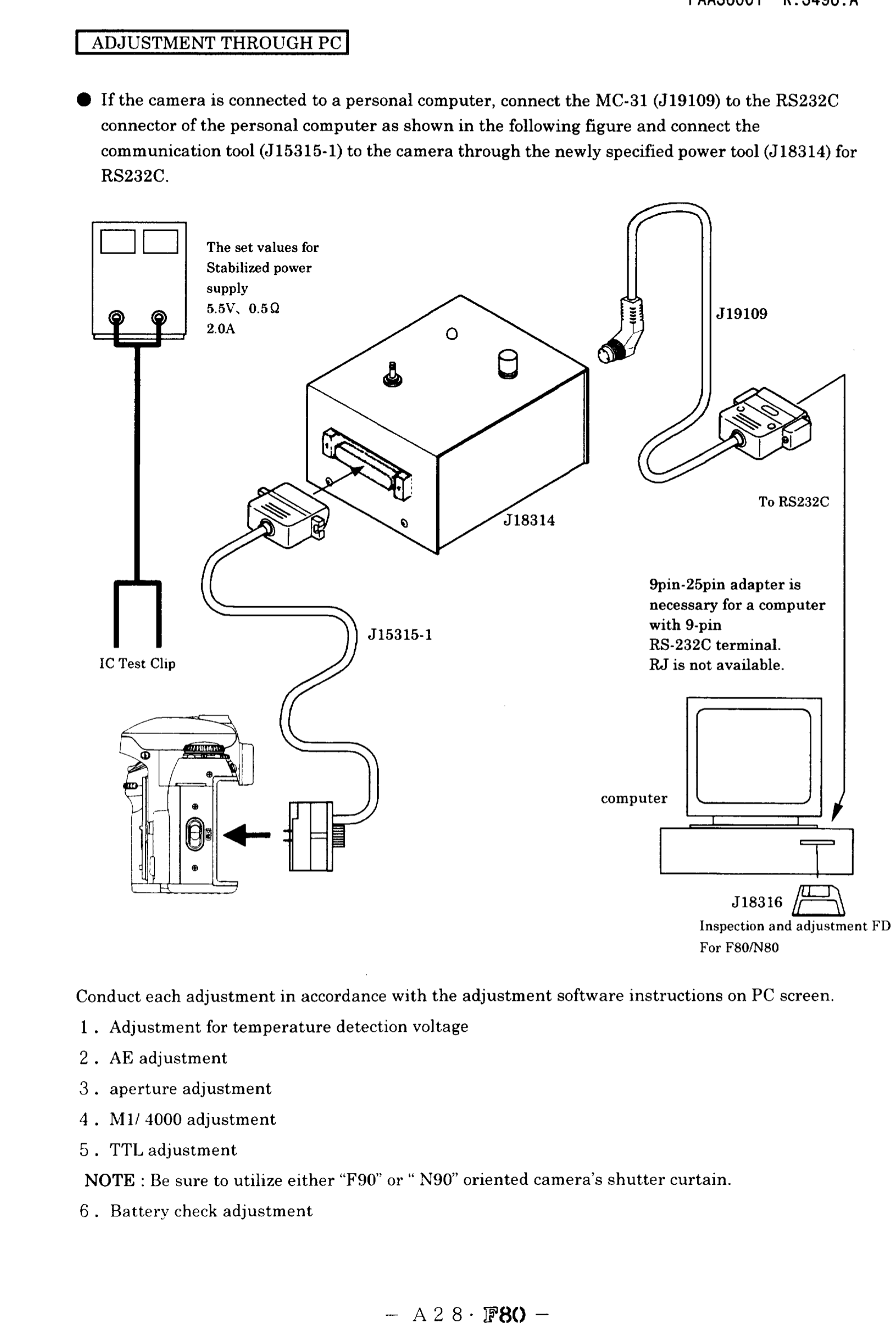

Another issue with the last generation of automatic film cameras is the need for dedicated software. This is further confounded by the likely need to boot into legacy computer hardware.
I suspect these service floppy disks are not available as the independent Nikon service facilities will still service these cameras. I'd say that is a good thing for now.

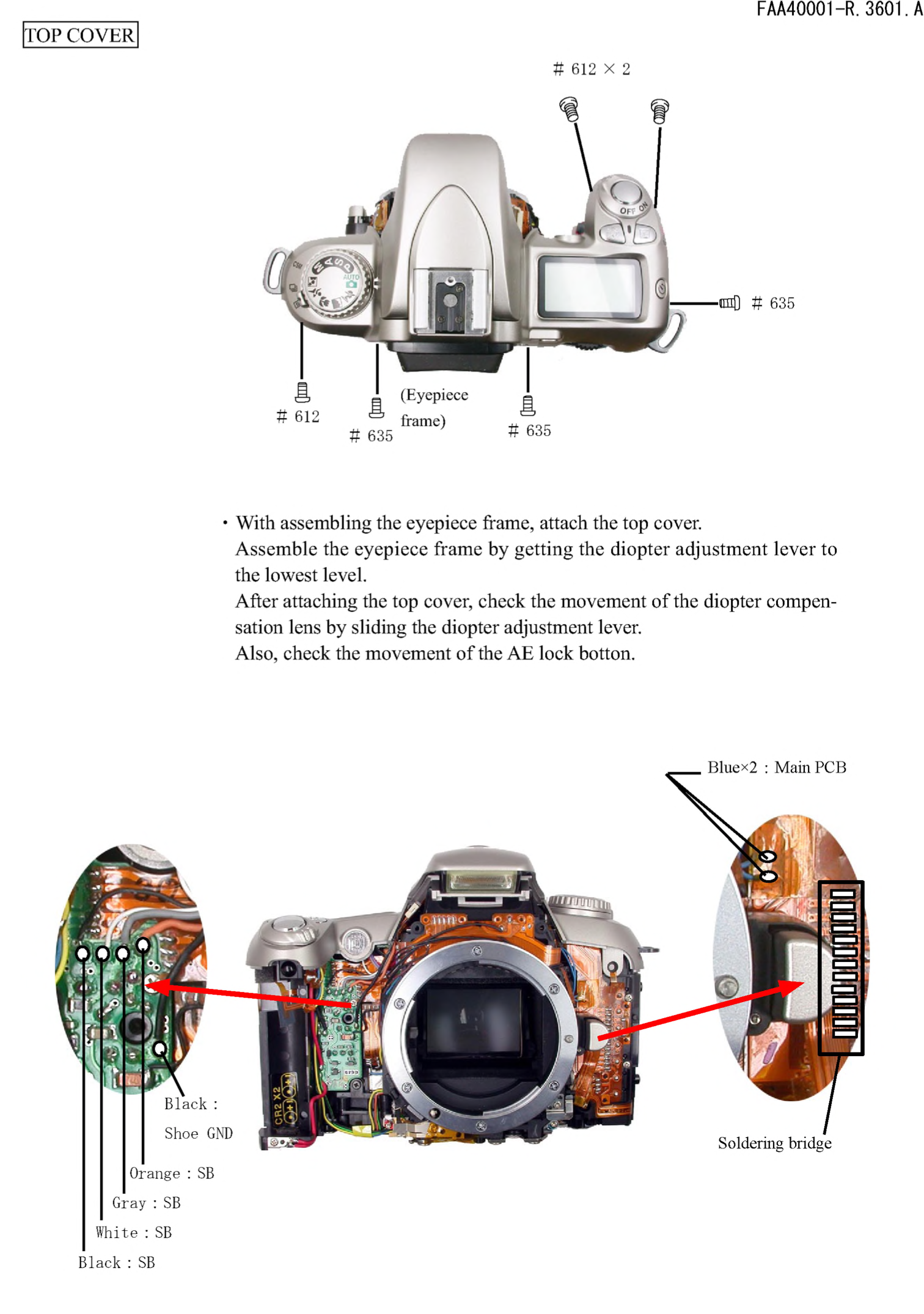

Some good news for Nikon's most recent cameras is that the service manuals are very detailed in how to re-assemble the camera. Even to the point of including color pictures:
Can floppy disk drives still be managed by current versions of Windows? Or did the manufacturers use other operating systems?
If I can get a copy of the program I can get a PC to run it. Be it's on floppy drive running DOS or Windows 95 etc... I can get it to run.
