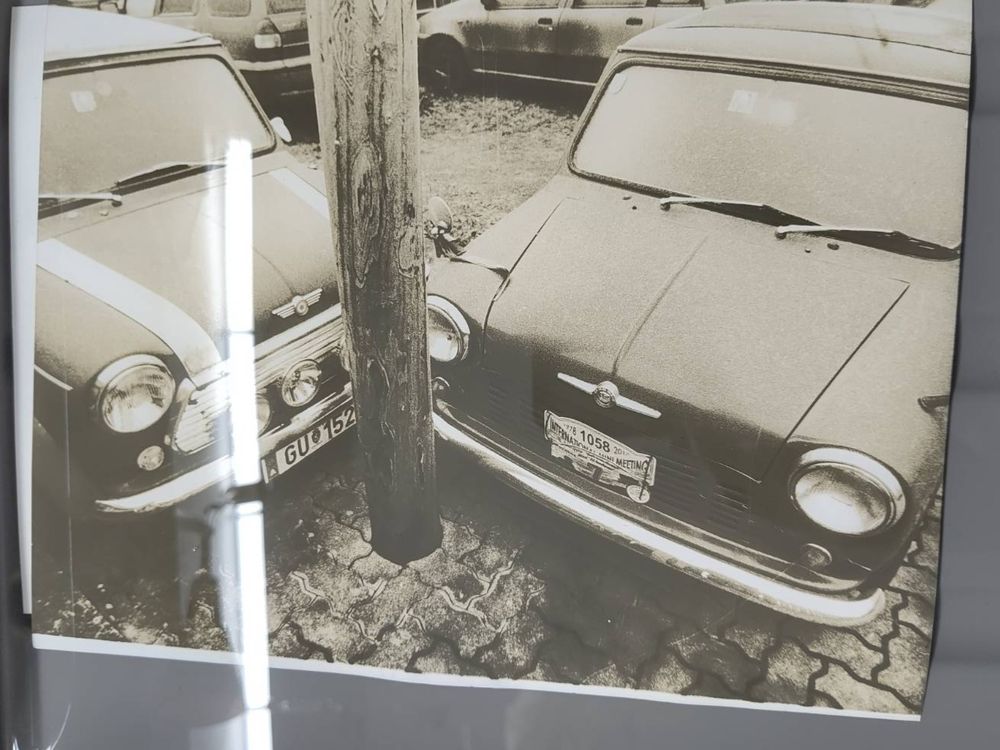

Last week I used some Oriental New Seagull G2 WT FB in lith, here is the result (sorry for the quality of the picture, not the best lighting conditions).

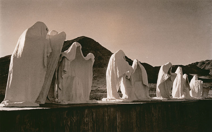

Fomatone 131 paper, Fotospeed LD20 dev (sadly discontinued), selenium toner:

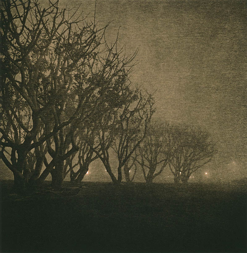

Old Forte Fortezo grade 3 paper, Moersch SE5 Lith developer:

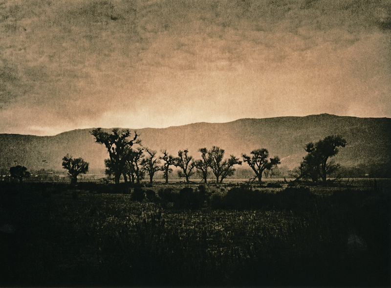

Old Forte Fortezo grade 3 paper, Moersch SE5 Lith developer::

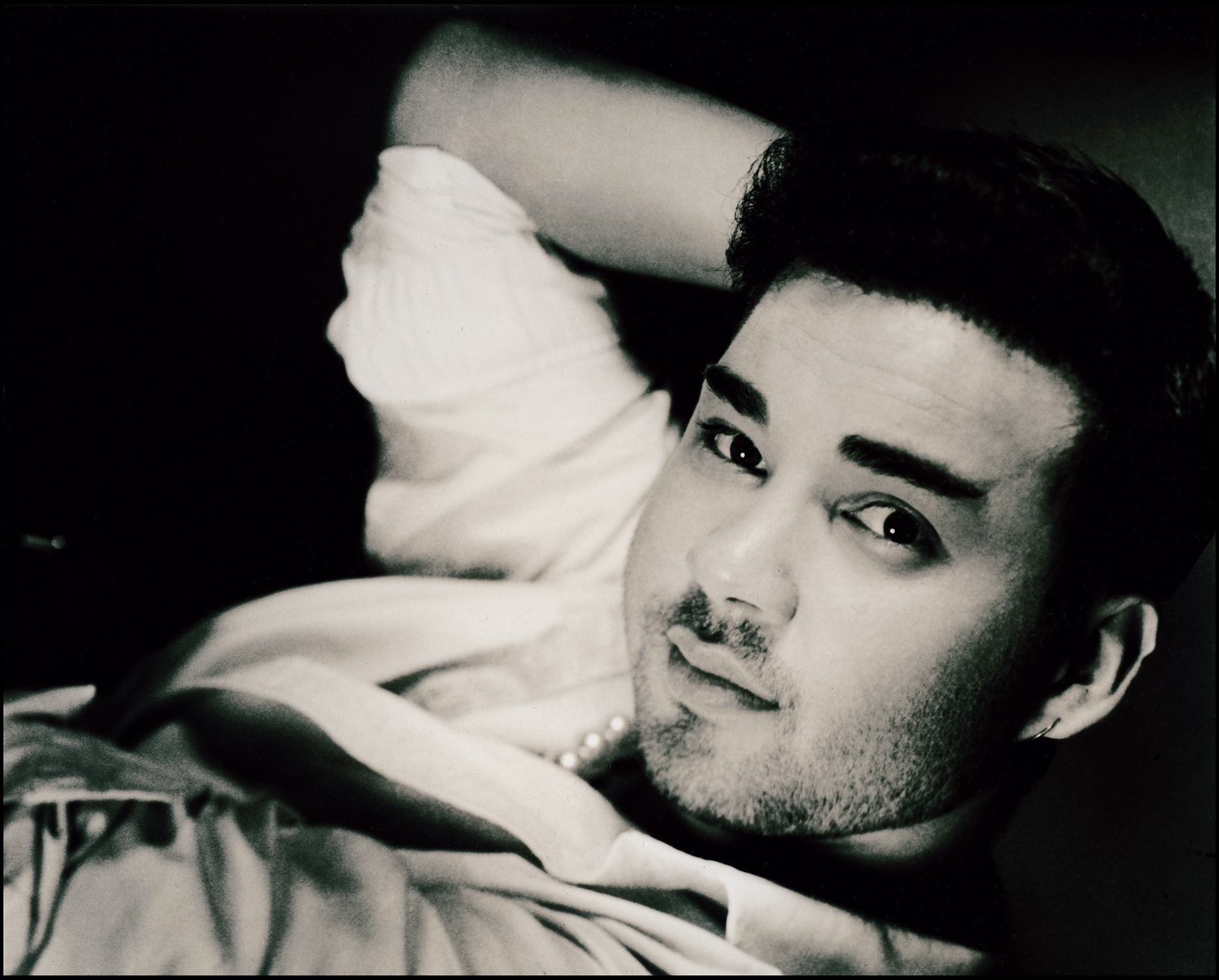

Portrait below from the SETTLE! Lith printed exhibition of Diaspora Identity in England of pop singer Jonny Monk last year in London. Printed on Seagull Oriental FB Gd IV under Cold Cathode. This is the Black & White box. The Blue lightning box colour of Oriental Seagull has been the given orthodoxy of lithable papers from the Oriental Seagull stable. I find that all of their FB papers lith easily with the Moersch Masterlith kit.
This print has the creamy glow that is reminiscent of Anton Corjbin printed by Mike Spry back in the day. Finding the right G4 is hard as Oriental changed their formula, I got turned onto slavich by GZ years ago and I currently like printing with Ilford Warmtone emulsion. I got gifted a box of Process FB Lith Semi matt Paper recently and will select a few negs for it.
Lovely set of images, I'm in for a treat then with Fortezo. Admittedly I've only used Moersch Easy Lith and not SE5 yet.

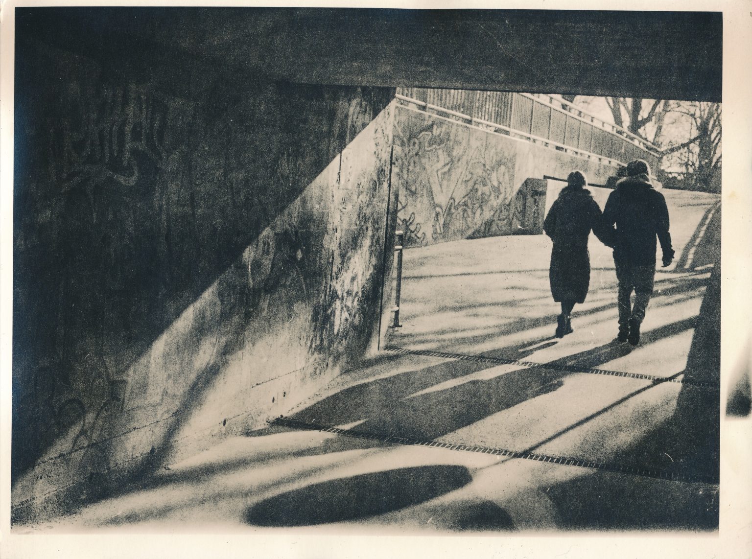

Samum Austron Bromaton Paper – Easy Lith Process | Out of the underpass

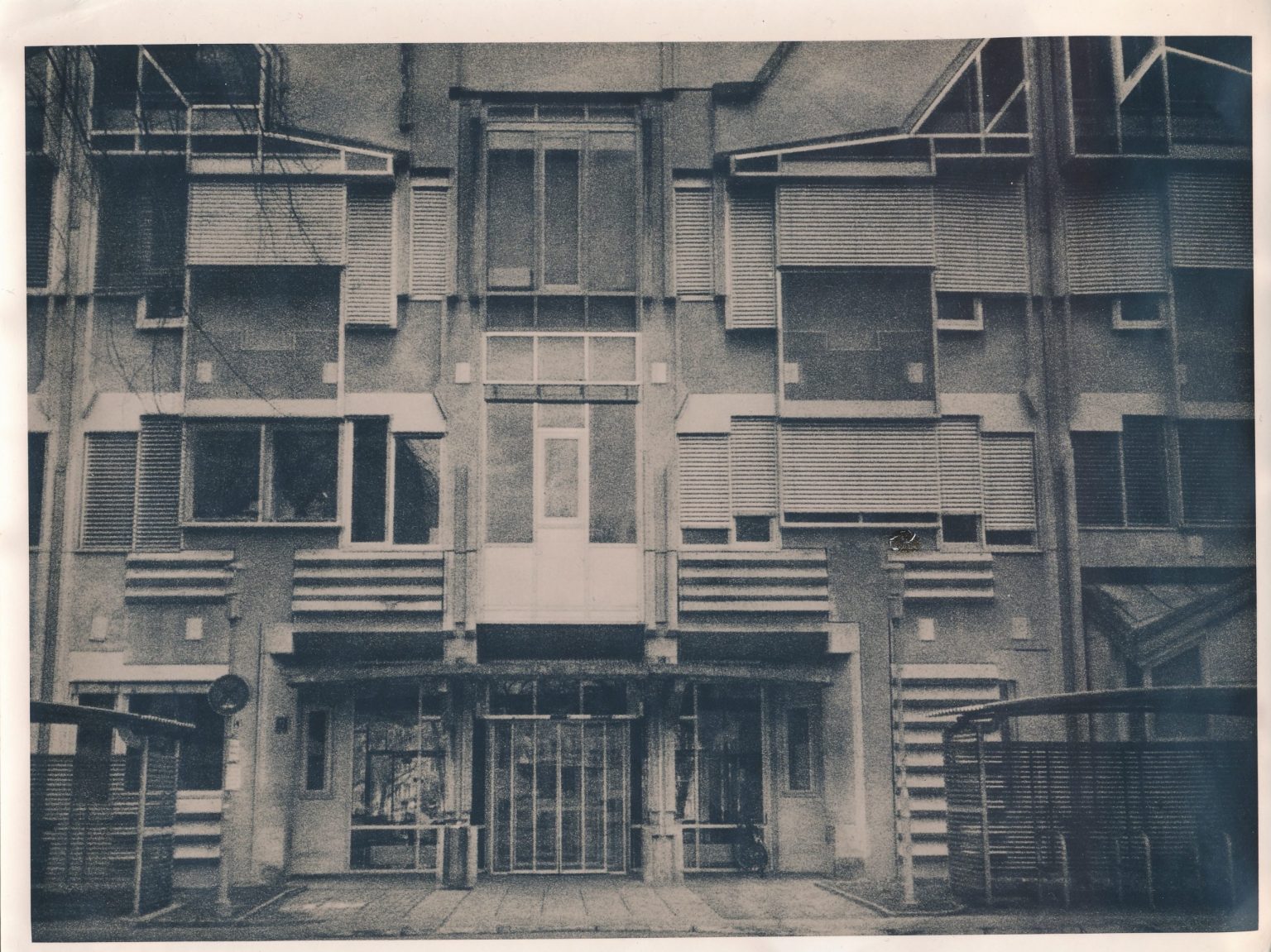

Image from the weekend from a darkroom session with Easy Lith
