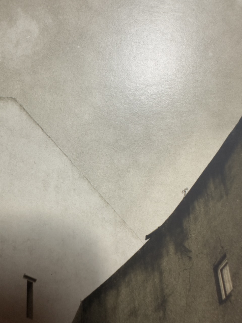

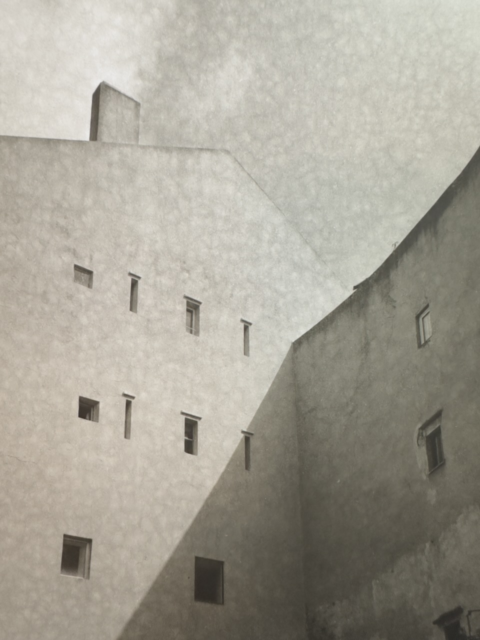

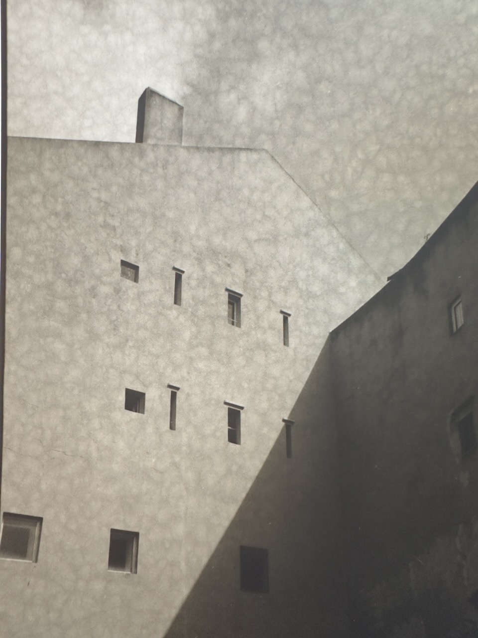

Disclaimer: I’m very new to lith printing. I tried both of these papers and am getting a snowball effect, which is more prominent on Ilford WT FB Semi-Matt. Maybe I can reduce the development time, but then I won’t achieve the desired contrast. I tried some old paper, such as Ilford MG IV, and it worked just as I wanted, but it took a very long time to develop.
I use Moersch 50+50+25 (1+4) as recommended by the manufacturer.

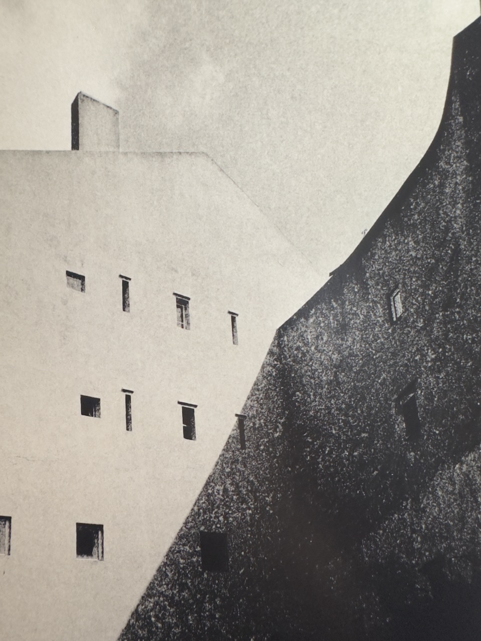

That's an interesting discovery in the sense that Ilford MG IV was said to be one of the least sensitive or even totally insensitive papers to lith toning
Was this RC or FB paper in your case?. If it was RC can you show us examples? Thanks

MG WT Semi-matt is a new box, purchased just weeks ago, and I use it regularly for my traditional darkroom printing.
MG IV, on the other hand, is who knows how many years or even decades old. I got it for free over five years ago, alongside some other papers, and the box was completely worn-out, which tells me it was very old even when I received it. I assumed it would be completely useless but kept it anyway (turns out that was a good decision).

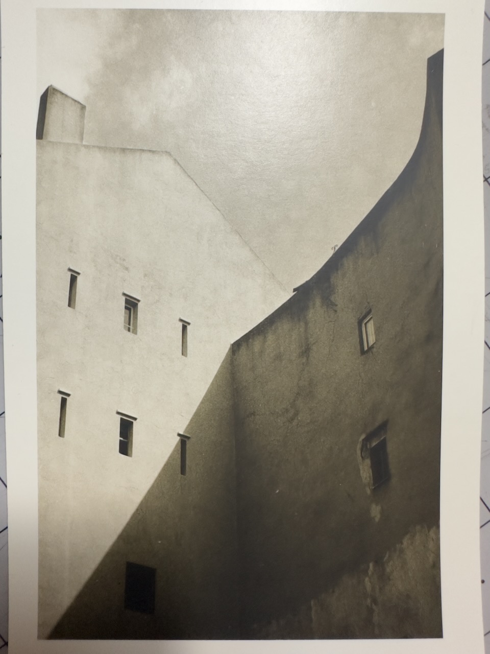

Here are examples of prints made with MG IV and two with MG WT. Both MG WT prints have these blotches, which I read somewhere are called “snowballs.” MG IV, in this case, is much more contrasty, which I intentionally did by leaving it in the developer longer. I like the grainy look of the IV print in this case.
Even my new FOMATONE MG Classic has the same issue as MG WT, although it’s not as prominent.
ILFORD FB WT Semi-Matt:
ILFORD VI Glossy:
FOMATONE MG Classic:
This is my first lith print I ever made. I was just playing with different papers and dev times.
