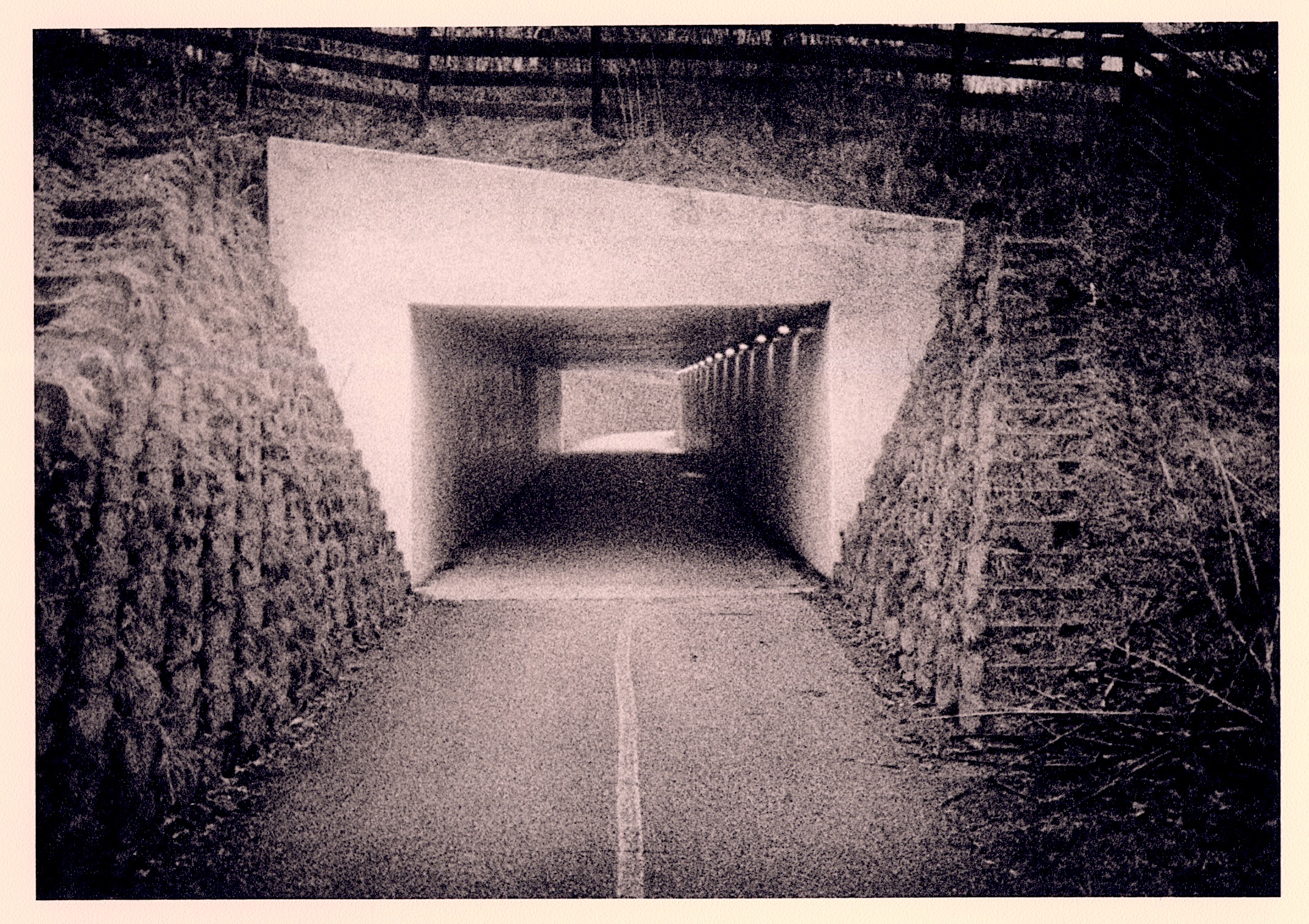

Last week I used some Oriental New Seagull G2 WT FB in lith, here is the result (sorry for the quality of the picture, not the best lighting conditions).

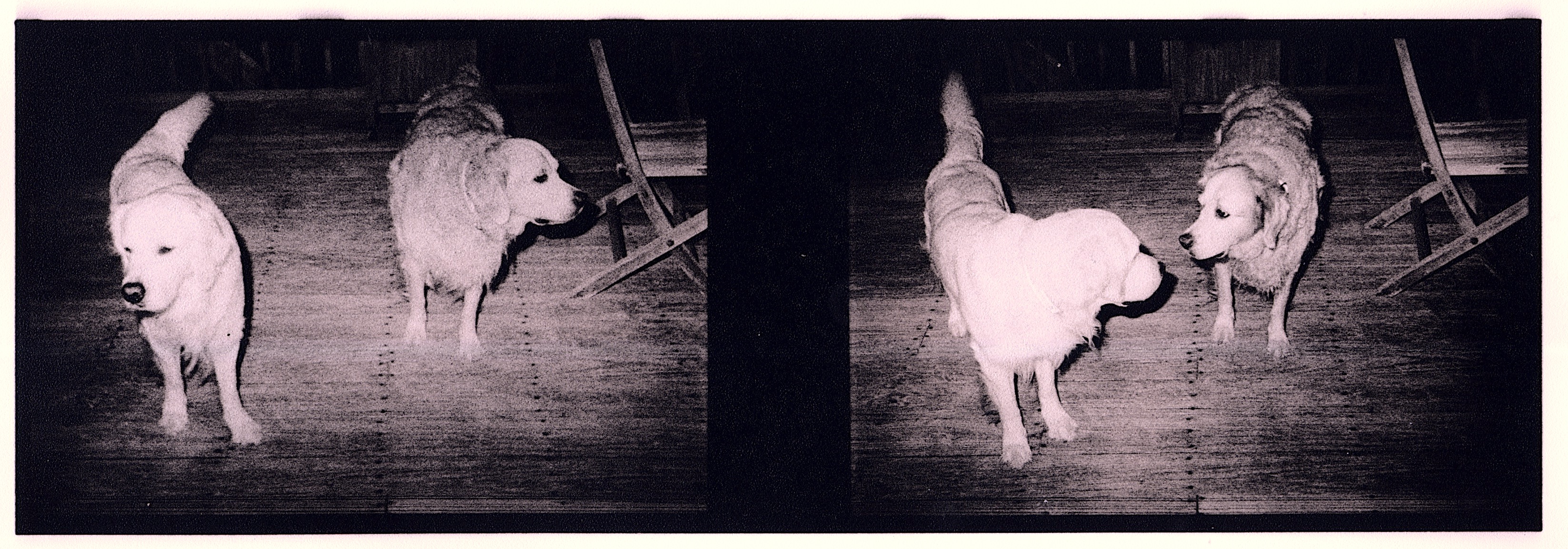

Finally made some photocopies of my prints with Fomatone MG Classic 131 Warmtone FB:

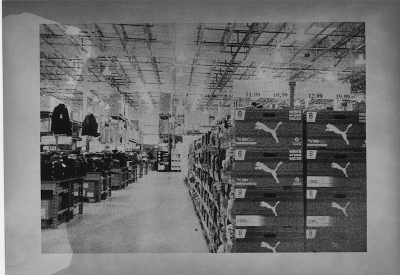

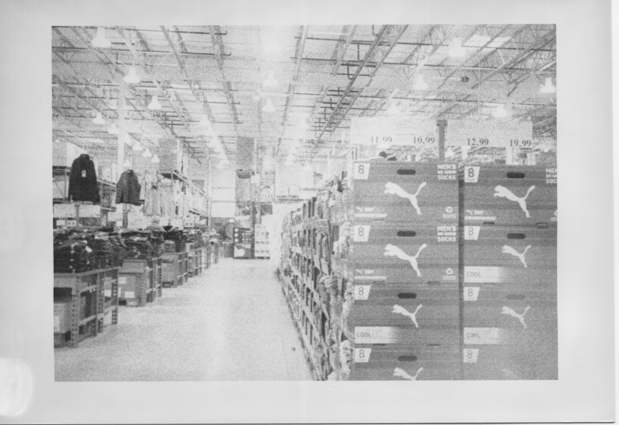

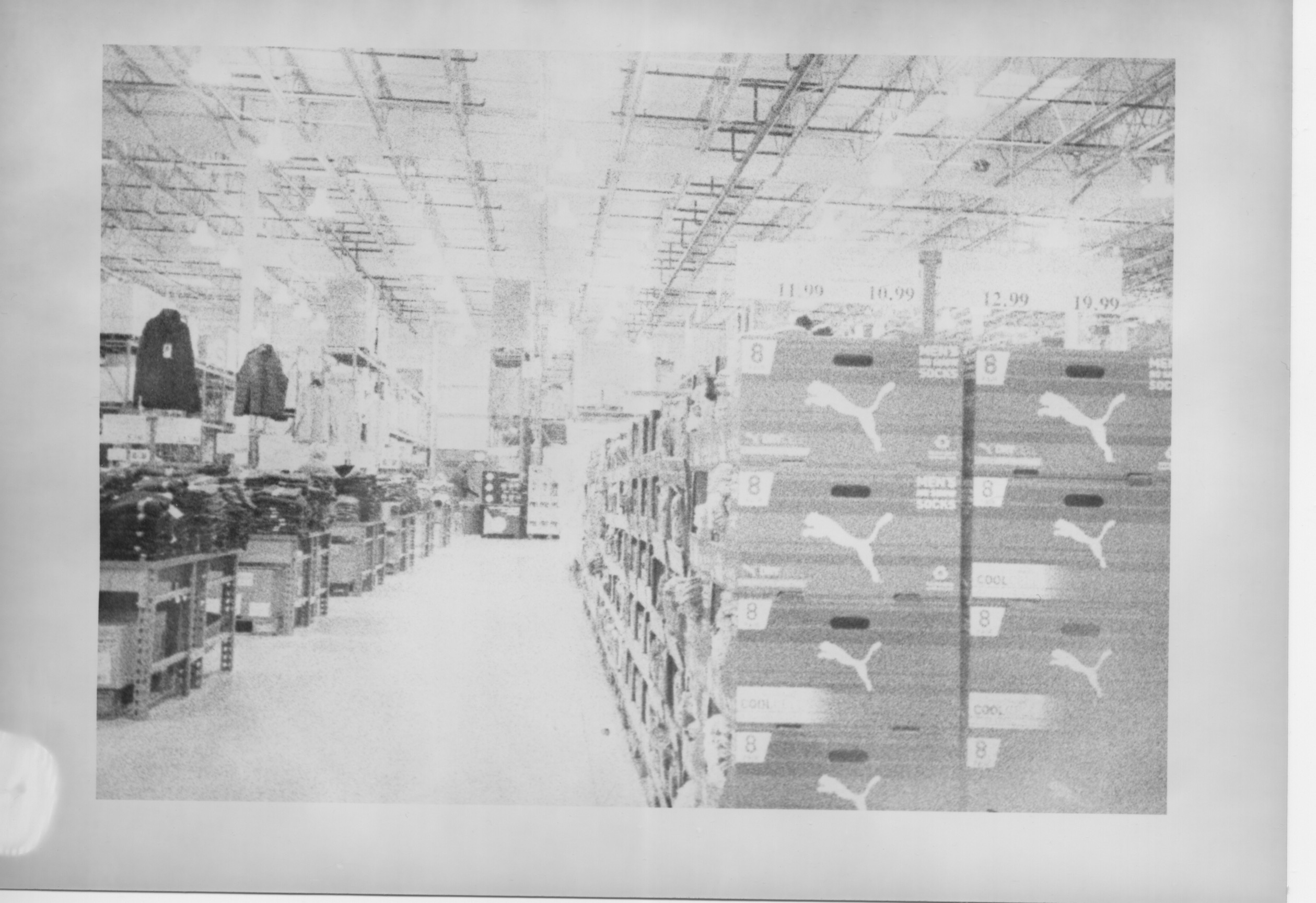

I have not had good results with expired paper. In 2006 this Foma paper worked fine. Now it is shot.
40 sec, 120 sec and 240 sec exposures with this paper in its current state.
Of course the 40 second exposure is the one with the dense surround, which gets lighter as the expsure increased. But still pretty bad at 240 seconds.

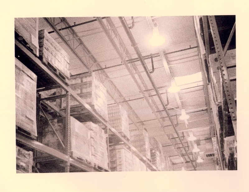

Here is a lith print from the same box of Forte paper printed in 2006:
