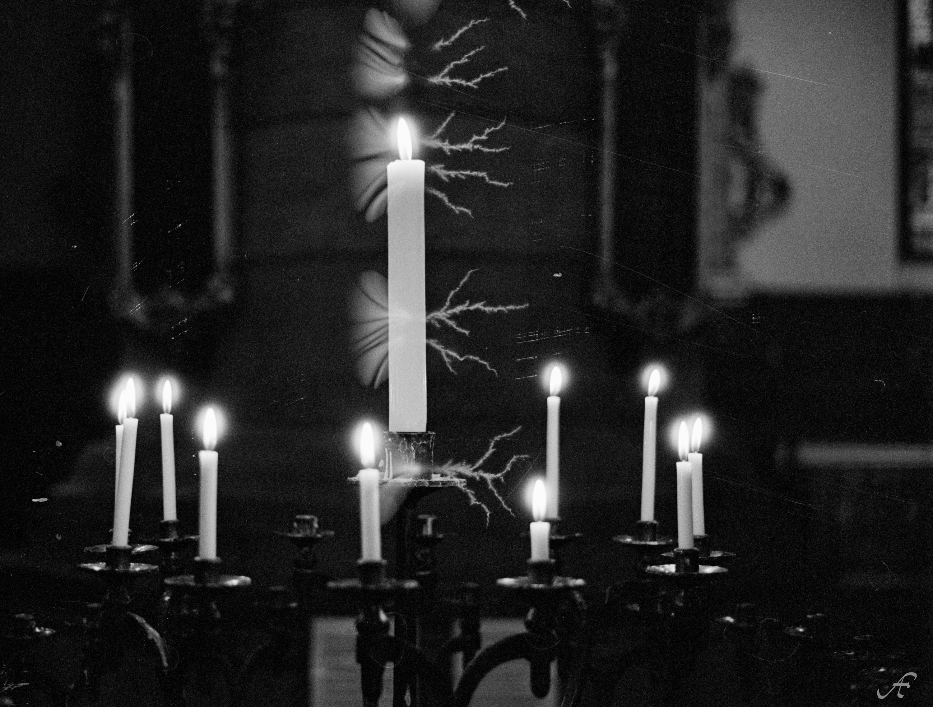

I just remembered an odd negative I got a couple of months ago:
I asked an experienced photo journalist about it. He said the flashes were most likely discharges of static electricity on the film itself. It happens if you advance the film too fast in cold weather, which fits the conditions when I took it.

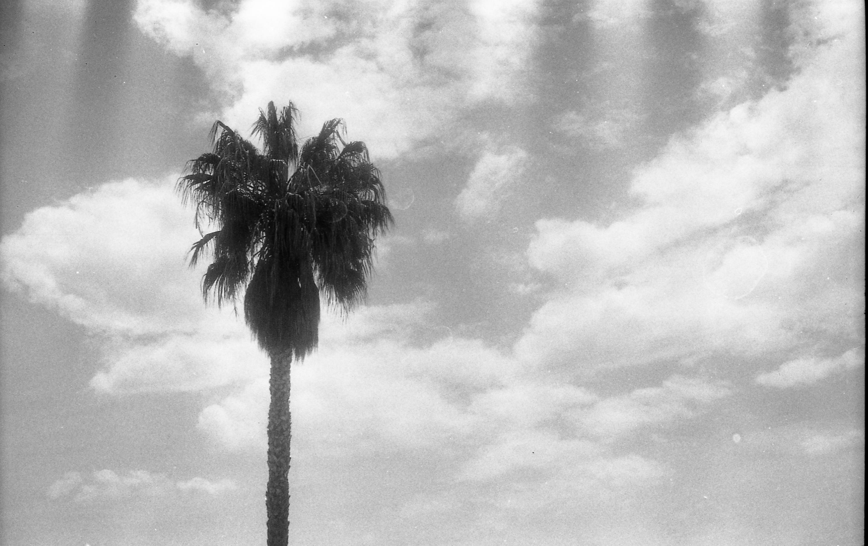

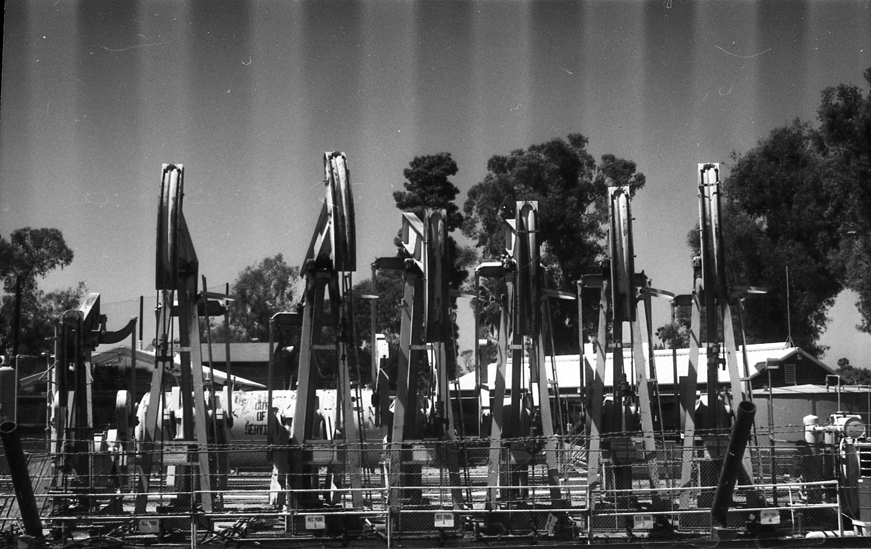

[h=2]R3 Monobath[/h] I love the idea of a single chemical developer that is reusable and keeps well. I'm afraid I will have to reserve this developer for 120 sized film with no sprocket holes only. I am guessing that due to the non-agitation of this developer, it has a tendency to drip down from the sprocket holes creating lines on the negative. Anyone see this before?

That does happen sometimes when not agitating. Certain developers seem to be more prone than others.
This is probably the worst example of sprocket hole banding I have ever seen. It goes from top to bottom, and is extremely pronounced. Sorry this happened to you.
