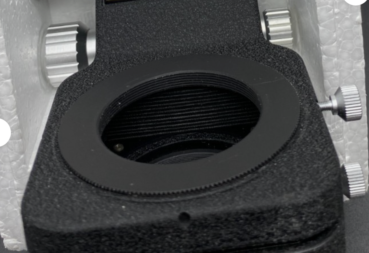

I need the threaded round disk (T thread) for the front of a Vivitar Universal Bellows. This is the threaded plate that a female T adapter (allowing use of a standard camera mount lens.)
The threaded round plate is held in place on the front of a Vivitar bellows with 2 locking chrome thumb screws.

I was writing from memory because my bellows is in a storage warehouse at the moment, but I see that there is only one satin chrome thumb screw on the front standard that locks the black painted disk onto the front standard--not two. Loosening the thumb screw allows the disk to be turned that the aperture scale on the lens can be seen easily. Without the disk there is just an opening with nothing to screw the lens adapter into. The disk resembles the lens disk on an old Omega D2 enlarger.

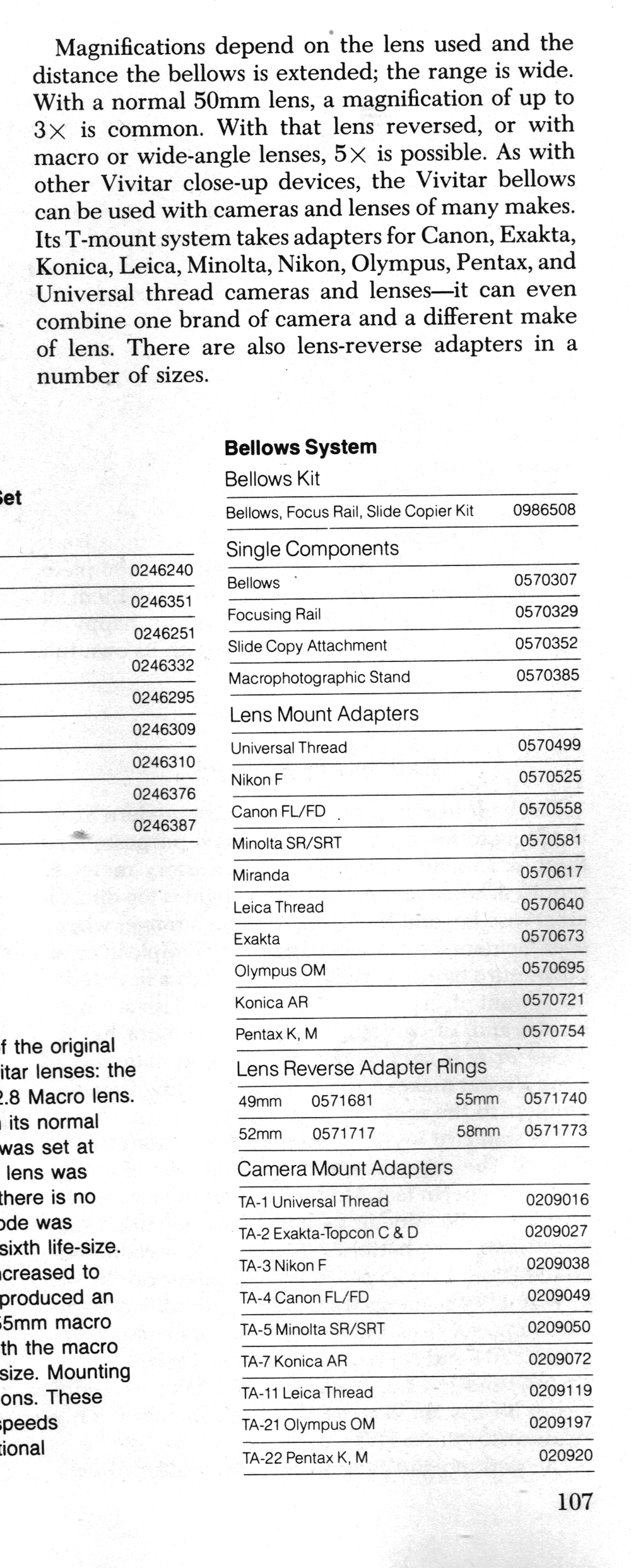

According to "The Vivitar Guide", they made bellows adapters for several different lens mounts. Usually, devices with that type of universal system, like my Beseler Slide copier, have TWO thumb screws to keep the plate in place. The plate itself is round with different mounts or threads on it. The important thing is that the plate has a V-shaped GROOVE around the edge that the screws push into. I have a couple of these types of plates that might fit. Measure the diameter of the hole on the front of the bellows -- which should be the same size as the adapter plate -- and I'll let you know if I have something to fit.

I don't have one of these, but as a help, I think the black ring in this photo is the piece you are looking for. As you can see, the bellows comes with one (1) chrome thumb screw. Good luck with finding one!
