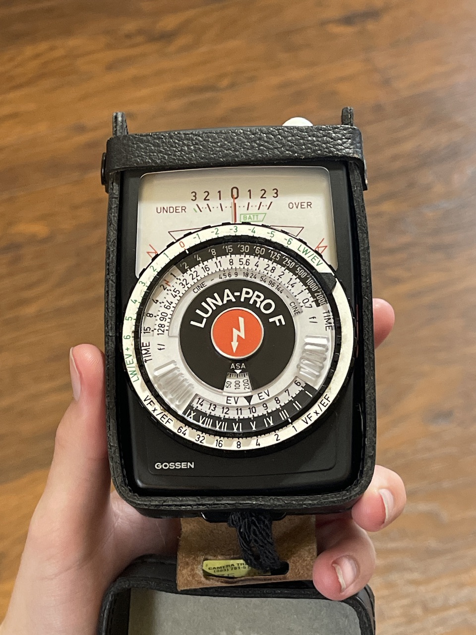

My Luna Pro F just showed up, and it is in very good condition! Comparing it to my Nikon F meter, it gives similar results, so it seems to be working correctly!
BrianShaw
Nov 30, 2005
16,953
La-la-land
Good for you. Congratulations!
Did you get the manual for also? If not, easy to find on internet.

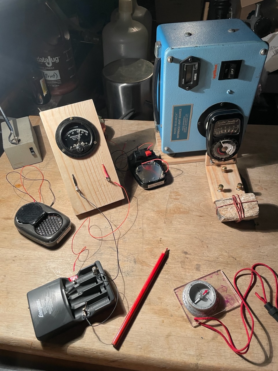

Meter calibration lab tools.
- 100 foot lamberts standard (short wooden platform to lift it up just a little).
- Meter holder/positioner (lifts the meter just a little too high so I needed to put the light on a platform)
- Milliammeter
- Adjustable electric source set at 100 milliamps for demonstration
- A pretty good meter feeding its output to wires (used to be how I tested coils).
- A cell tester (connects a Selenium cell to speaker terminals)
- Compass (to measure how strong the magnet is. At about 8-10 inches a meter will pull the needle 20-degrees from north).
That meter on the holder is one of my original ones. It was calibrated to 32 candles per square foot earlier today which made me happy, for the picture it was only reading 25. Maybe it’s just cold.

I didn’t get a manual with it, but thankfully it is online. Maybe I’ll look for a printed manual, but for now the ODF is fine.

Could you tell us a bit about that "blue box"? Googling "Photo Research Reference Light Source" turned up this: https://www.jadaktech.com/products/photo-research/
Products this company applies the name "Photo Research" to seem to measure light rather than provide a reference standard light source. (I'm wondering if this company acquired the company that made your "blue box" but did not continue to make the "Reference Light Source".
I've thought from time-to-time that it would be nice to have some sort of reference light source , especially one that was variable. Then I could check my light meters not only for constancy (are they reading the same today as they did a year ago) but also linearity. Sort like how I check my shutters for actual speeds and also consistency. Of course it would be nice if such a device cost less than four figures and didn't have to be periodically sent out to a metrology lab for NIST-traceable re-calibration. Probably all an unrealistic hope.
Googling "reference light source" turned up more than I can digest just now.
David
Bill Burk
Feb 9, 2010
9,455
Its underlying brand is Kollmorgen and a few turned up on eBay one day and the cost wasn’t scary. This one worked right off the bat.
Now I see the well has run dry. But there is a camera tester from Revini Labs on Kickstarter.
A friend I met trading camera grease made a camera tester. He sold all he made of a few units but made the plans available and might have some parts if you want to do it yourself.
David
the sun is a perfect reference light source 'sunny 16'.
Good way to double check calibration. The Kollmorgen should read 30 and ‘sunny 16’ should read 250 on the Weston ‘Light’ scale.
I think it should be easy to get a reference source cobbled together with available electronics.
- Milliammeter
I'm lost. What does magnetism have to do with light meters? And is that rock calibrated?
I believe Weston factory “calibration” involved matching the coil, cell, dial and magnet. Unfortunately they aimed calibration to be “just right” out of the shop.
Any loss in cell output leads to a lower reading.
My goal is to assemble meter with a bit of overdrive and add a potentiometer to dial it down to standard. Then if it loses sensitivity over time it can be dialed up.
The strength of the magnet varies from meter to meter. Some will pull the compass 20-degrees from north at 13 inches and some at 15 inches.
When there’s more magnetism, the needle travels farther.
I can almost get 1/3 stop higher reading by adding a small supermagnet.
I am going to get one of these calibrated! If not, I’ll melt them down for their gold.
The petrified wood is there because I didn’t think about balance when I made the holder. It keeps the meter from falling over.
When you put that way, it almost make sense. ;-)
