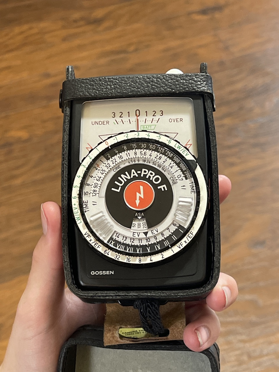

Was looking for handheld, I found one that I like quite a bit.

I did find a meter I liked, the Luna Pro F. It has all the features I need, and looks really good, for $50 USD. Thanks for the suggestion though.
I am glad you've found the right model. Btw, Luna Pro F is just the model name, it's being made by our german brand Gossen, which is famous/was famous into germany, back into it's heyday. :smile:

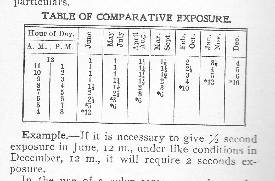

In slightly differnt units, a similar chart I found in an 1890's photography how-to book.
this one also appears of little use to me.
most importantly, without knowing the latitude of the geographical location it makes no sense at all. obviously on the equator the difference will be very small while at the north pole they will be huge (not to mention that it completely ignores the southern hemisphere).
less drastically, it also depends on the longitude because most places will not have the sun at its peak at 12.00 noon, which if we use the table above could easily result in an error of half a stop.
but even if we assume it was made for a specific location like NY, it doesn't make much sense to me. If I go out a take pictures at a bright sunny day in December at noon, I never found the exposure time to be 4 times longer than on a bright sunny day at noon in July (unless I was shooting a subject in backlight maybe).
In short, what seems weird to me that they made this rather complex table with high precision of 1/4 of a stop while the basics behind it seem very questionable.

Maybe reciprocity failure was more of an issue with this old type film which required more shutter time during the darker months? Even under regular daylight at noon in the summer, one second is indicated as normal. So, this is real slow film to begin with. So a little less ambient light requires a lot more exposure time. It's not a linear relationship.
I‘ve understood the „1“ in the table to be the standard factor, and the other numbers to be exposure compensation factors. But reading the example text, they do mention 1/2 sec exposure, so it seems to be really slow film indeed. Anybody knows what the normal ASA was at 1890? :smile:
