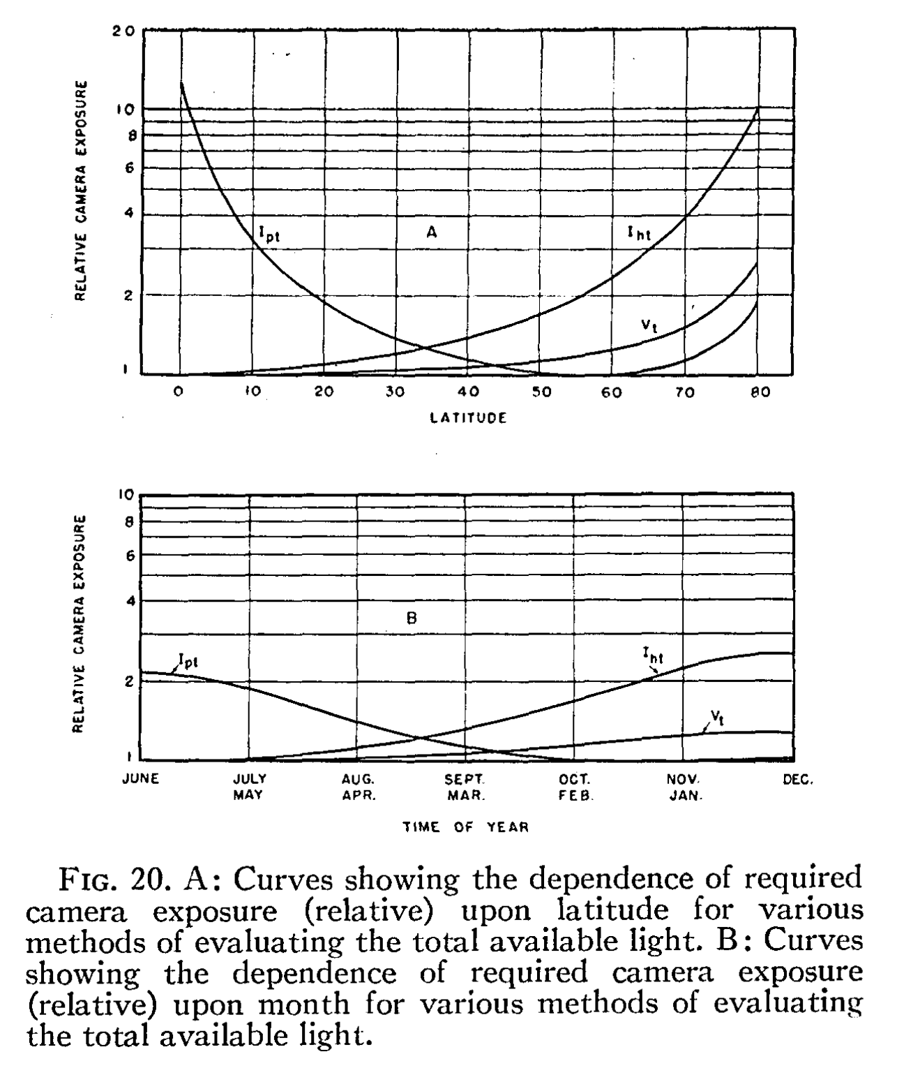

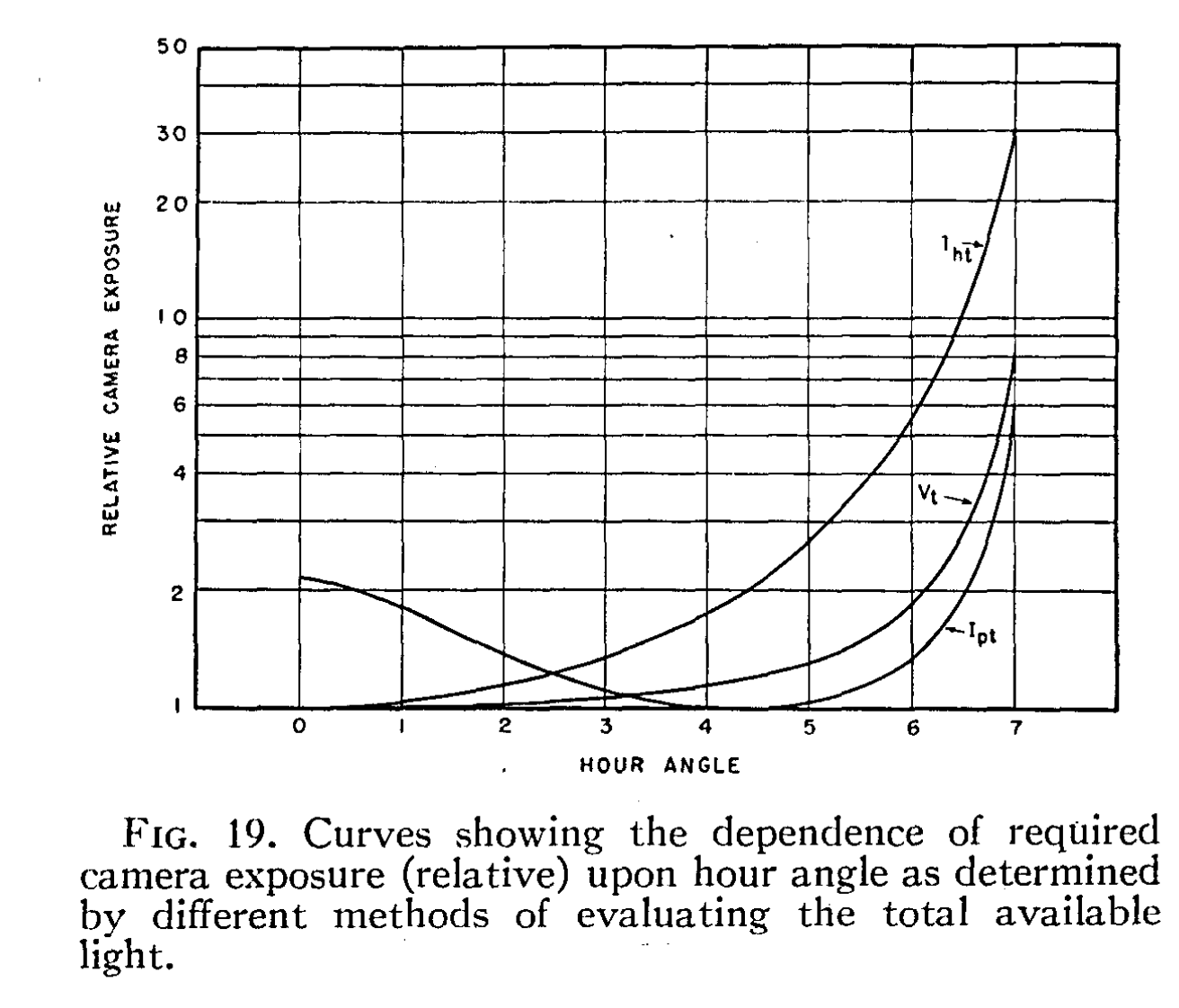

Again, I believe Steve B. offered up this reference. Jones and Codit argued that since the correct exposure for B&W Neg-Pos processes is determined by shadow exposure, the light from the sky, vs just the sun, is important. In fact they went to lengths to calculate the total light from the sky, as volume density of luminous energy (explained in the paper...50 pages).
T
his value, as might be expected, is somewhat unpredictable due to latitude, time of day, season and other atmospheric conditions. I think a 'standard candle' would be better calibration standard than the sun. :smile:
VOLUME 38, NUMBER 2 FEBRUARY, 1948
Sunlight and Skylight as Determinants of Photographic Exposure.a I. Luminous Density as Determined by Solar Altitude
and Atmospheric Conditions
LOYD A. JONES AND H. R. CONDIT
CommunicationNo. 1155 from the Kodak Research Laboratories,Eastman Kodak Company, Rochester,New York
(Received August 4, 1947)
