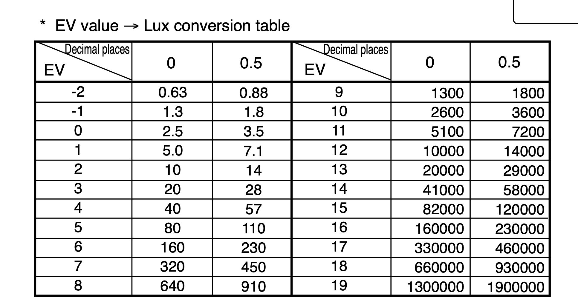

That is nice to do the math as you are doing because the usual conversion tables give round numbers.
I've come across some of these conversion tables in my research. They're pretty good for converting EV to Lux, but don't seem to be quite as good for the reverse. (especially since EV is a logarithmic scale and Lux is a linear scale.) I'd much rather have a direct calculation. It may seem complex if you write out all the steps, but once you bake it into a spreadsheet or program (on a computer or programmable calculator), its really easy to do.

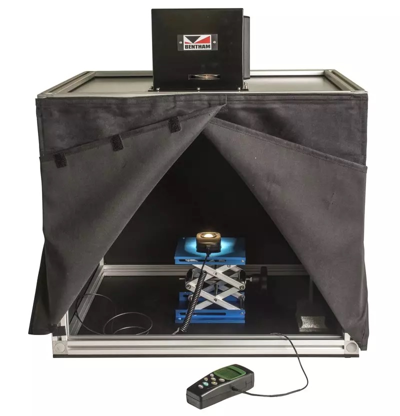

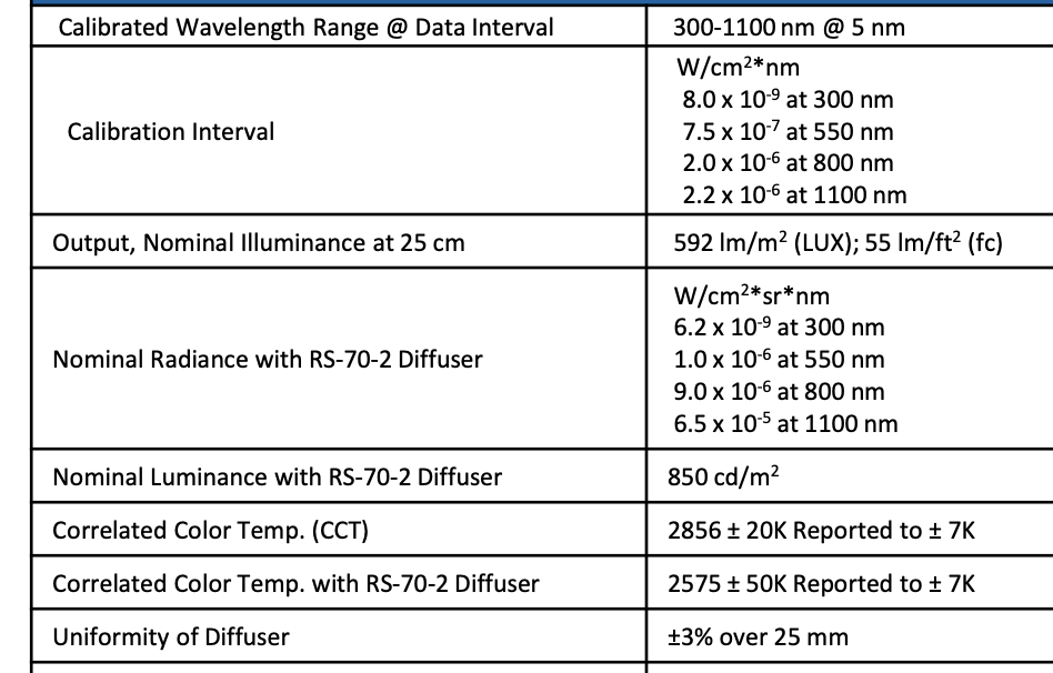

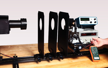

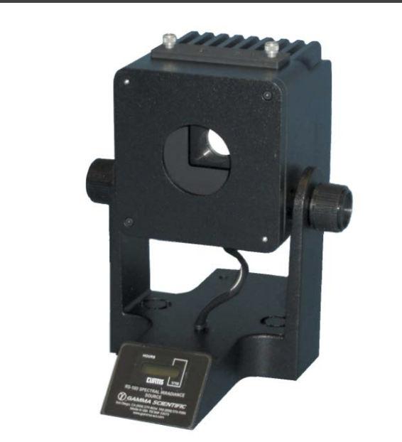

Don’t you want to use a backlit opal screen illuminated by a stabilized tungsten light source filtered to daylight?

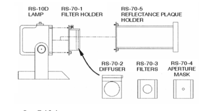

Here are a few fascinating calibration devices.
Here is a diagram of a calibrating light source with specs that one could use to duplicate something similar:

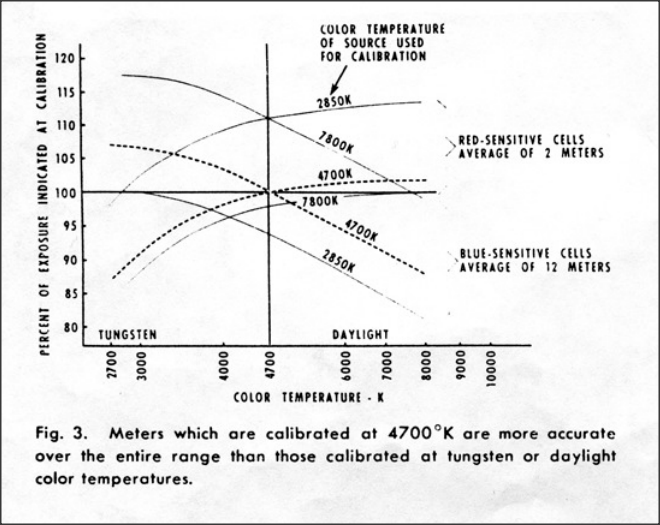

Color temperature plays a rather big factor in meter calibration. The chart is from the attachment below, Stimson, Allen, An Interpretation of Current Exposure Meter Technology, Photographic Science and Engineering, Vol 6, No. 1, Jan-Feb 1962. It had to be split-up to upload.

dkonigs,
And that chart shows 2850K 'color temperature of source used for calibration', and not concidentally virtually matches the chart posted in post 15
Once your light meter is calibrated it will give a perfect exposure of the calibration light source :smile:
I was just working out a post along the similar idea of realistic precision. After all, it's an exposure meter and not a light meter.
The spectral sensitivity of the photo cell as illustrated in the above chart should in itself be a strong argument against expecting impossible levels of precision. Then there are the exposure constants K and q. A hand held meter is separate from the camera's optical system and therefore has to assume a general set of conditions. A camera's optical conditions change. The hand held exposure meter's assumptions don't. Through the lens metering doesn't have this problem.
