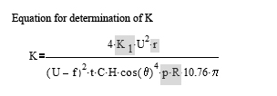

I was hoping for some comments on whether I read that document correctly, and whether I was on-track with that math I put together.
You might also want to check out this paper, which I don't see referenced in Conrad's paper. I believe I got this paper reference from Steve B.
Jan 7, 2005
2,713
Los Angeles
Yup, that's another one of the critical papers. The one I posted earlier is important too. I put together a compilation of different papers and various other sources into a document a number of years ago. It's called Defining K. It covers the theory from Illuminance through to the print (I believe). It should still be on this site somewhere.

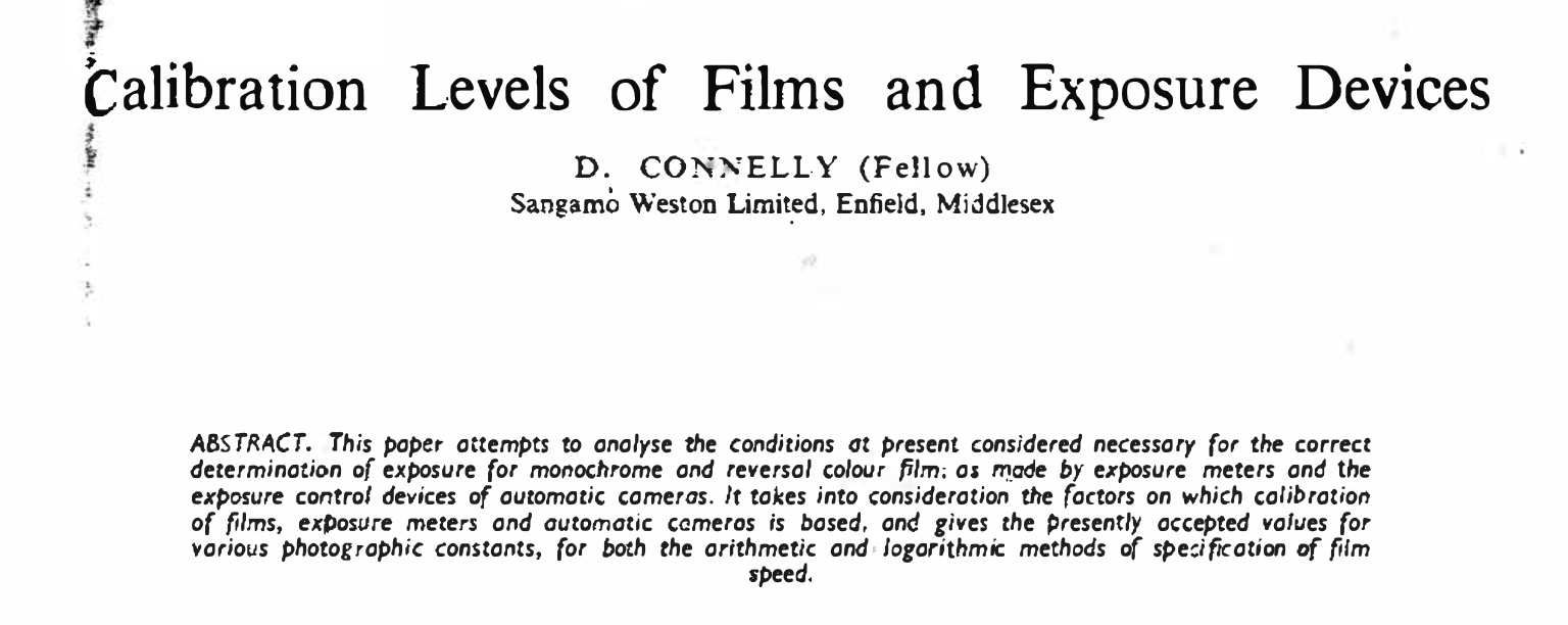

Found a pdf version of Connelly's Calibration Levels of Films and Exposure Devices small enough to upload.
  • Calibration Levels of Films and Exposure Devices, Connelly.pdf

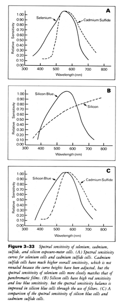

Two immediately come to mind. Overcast color temperature is very blue compared to the standard's. The part of K that is relate to the spectral response of the photo cell is based on the 4700K of the standard. It won't be as accurate under an overcast sky.
The other consideration is Reflectance is based off a Lambertian surface or perfect diffuser. Gray cards have some degree of spectral reflection. In addition, the angle of the gray card or incident meter to the angle of the light source is also a factor. You didn't mention how you used the lux meter to establish the illuminance value. How the values are measured with the different instruments can make a difference.
I noticed Conrad uses 90% Reflectance at the top of his luminance range. While this commonly occurs, the statistically average model uses 100% Reflectance and has a log luminance range of 2.20. Using these values creates what I have found to be a good instructive model.
