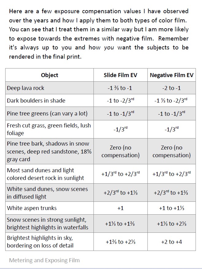

Whatever you meter with a reflectance meter will come out an 18% mid-tone -- so the correct exposure is to meter something in the scene that is an 18% mid-tone. That's why grey cards are sold. Barring a grey card, you need to be an expert in finding 18% areas in the scene. A lot of people buy spot meters to try to do this, but soon find out it's not easy -- because the human eye automatically adjusts to ambient light.
Also, different items reflect differently. You have to know how to apply the right "compensation" factors. Here's Alex Burke's use of a spot meter on different subjects. His whole book is excellent.
