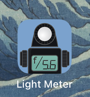

After having tried quite a few meter apps over the years, I have centered on this one.
It’s simple, clean and can do both aperture and shutter priority and you can move the center spot around as you wish.
Would be fantastic if someone figured out a way to do flash metering with an iPhone, and if someone figured out a way to use an Apple Watch for light metering.
