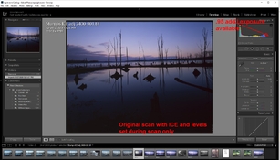

Here's the original of my earlier shot. I think you can say the sky is a little underexposed. It was really dark about then. This is when it pays to bracket. But with 4x5s I now shoot, I'm too cheap. If I was shooting medium format gear, I would have bracketed +1 and -1 and had a better selection to work with.
