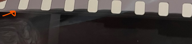

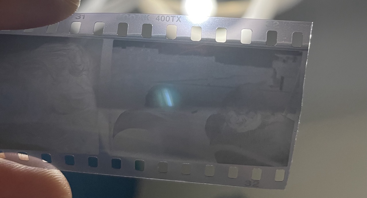

Hi, I'm again on this thread because I can't wrap my head around the origin of this light leaks.
Further inspection the camera I noticed that the shutter travels from left to the right when advancing frame, as the film does, so I don't get how it can cast a light leak as this one. Am I wrong? could it be the that the light is coming from the prism / viewfinder area?

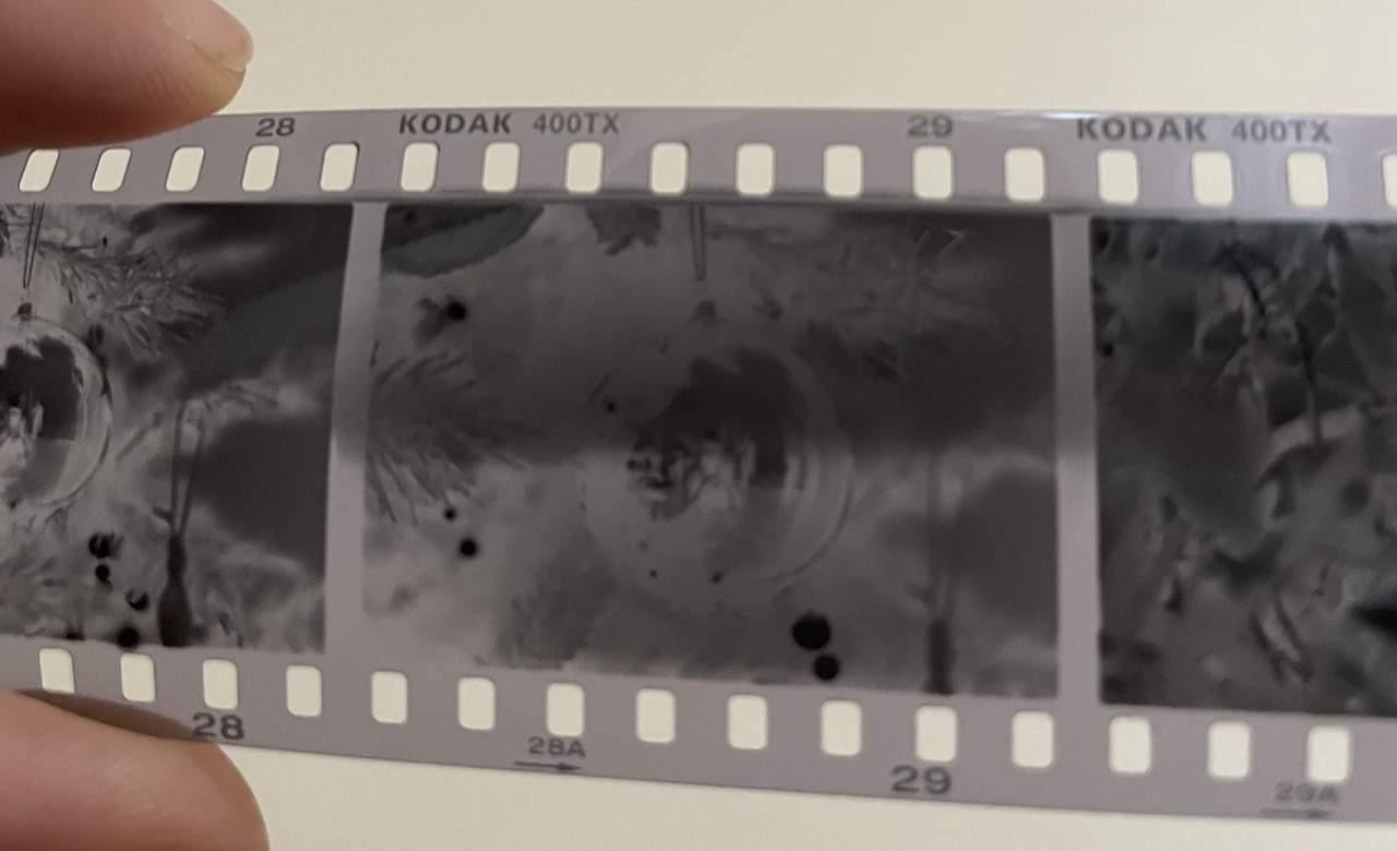

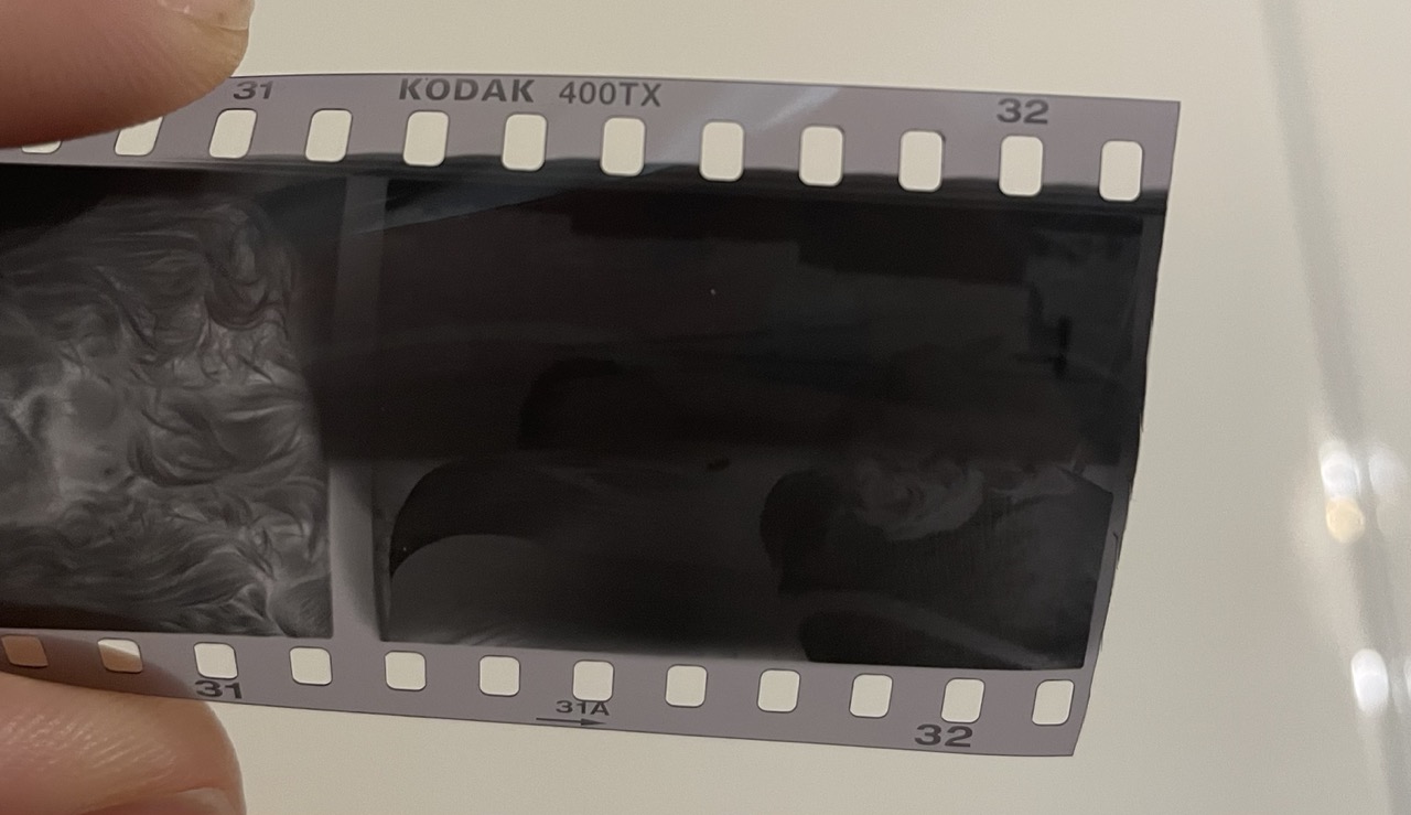

You'll have to show an example, because the one you posted earlier doesn't exhibit this
As you can see, the frames that present the issue also have a distinct strike in the sprocket area :
Yeah, that looks like severe fogging that just spreads out beyond the film gate. You can actually see reflections in that part that suggest an interaction with the edge of the film gate; note the thin, straight line that runs parallel to the image frame.
The shutter probably advances faster than the film advances. So the gap between the curtains travels across an area of the film (which would include the space between frames). You don't have a "blob" of extreme density, so that implies the fogging occurs while these things are moving. When the shutter has been fired, the gap between the curtains is out of sight. When the shutter is cocked, it's also out of sight. It's while being advance that it can let light through to the film.
As for the light leak going into the sprocket area, look at the little point of high density down by your thumb at #28 and see how it blooms outside the frame. Reflections and light piping in the film itself - it's common for higher amounts of light to do that.
