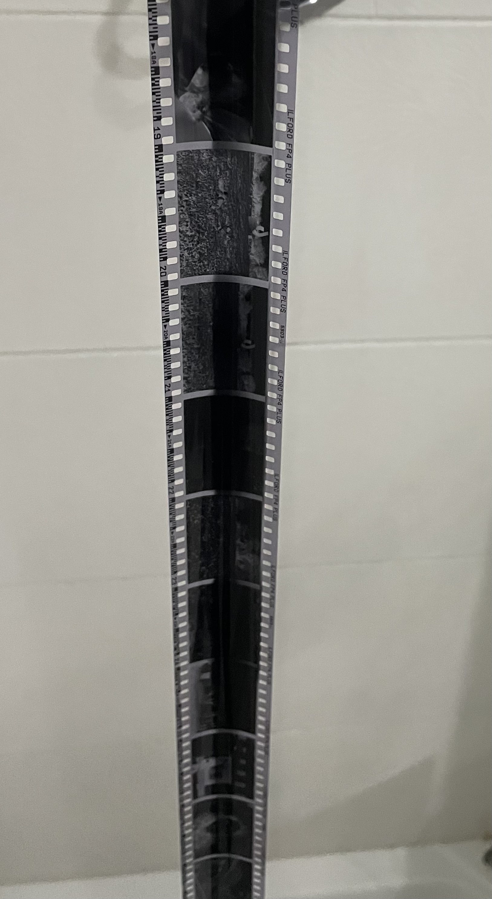

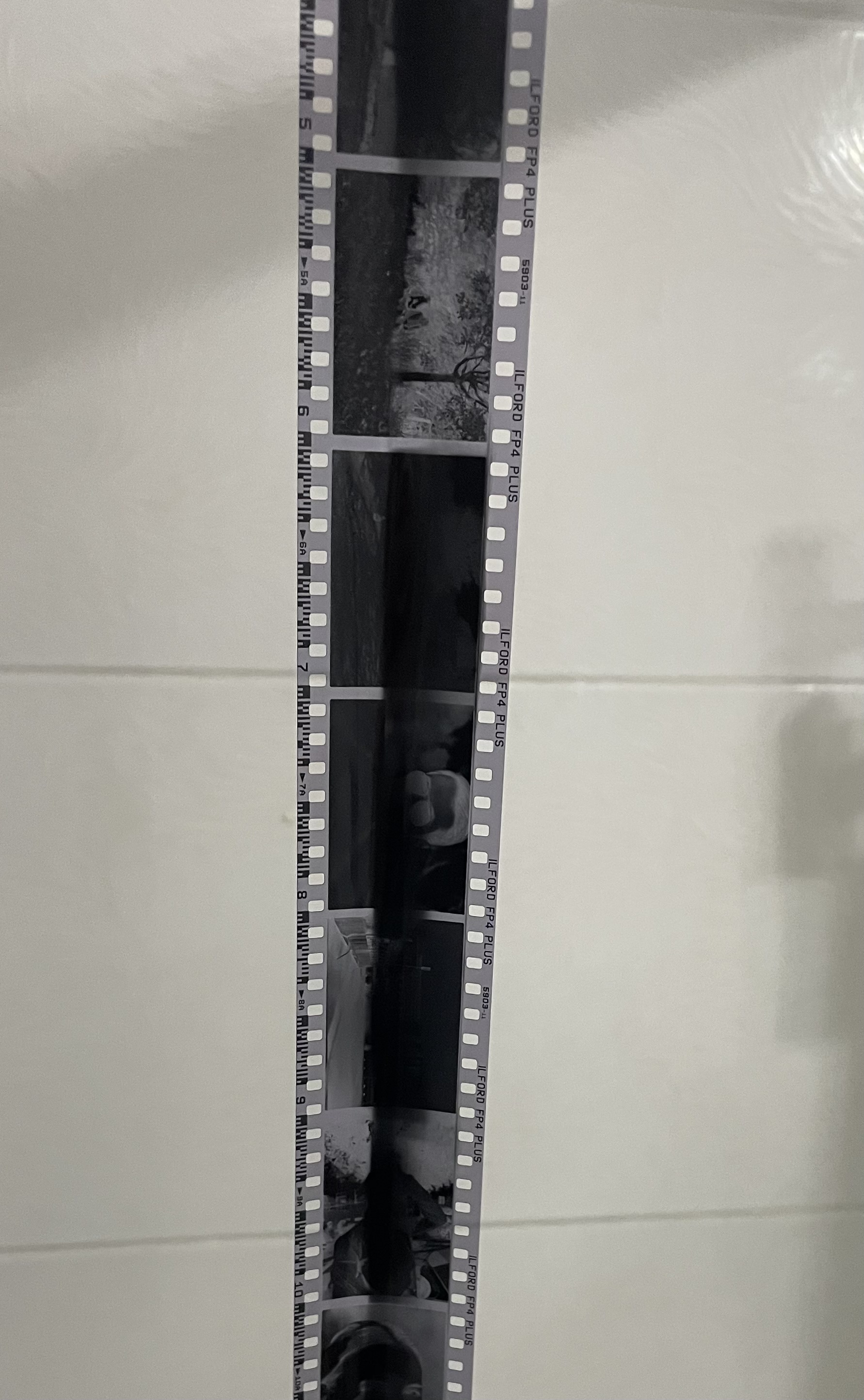

Hi, just developed this roll of FP4+ shoot on a Canon F1 CLA’d last week.
As you can see, a progressively thicker horizontal black line is present on the whole roll except for the last three or four frames.
I don’t see how a light leak in the camera could have caused it.
Could it be a developed issue? Any help is much appreciated

The streaking is inconsistent in width and always in the middle. Streaking is at the apex of the film curve and nowhere else. This suggests the film was semi stuck together in development and some frames broke free.
Oh, okay. So you think the film was in contact when spooled in the tank’s reels?
That is what I would suspect. If the film was warmer than usual when loading it may curl more than normal. I was looking at the edges for signs the film jumped the tracks but did not see any, usually there is a kink on the film edge, plus the result of that would be far more damage. You are getting an image underneath these areas and the film may have separated at some point but not enough for full development. Just what I suspect from similar situations.
I see. That’s very interesting, never thought the film could touch without jumping the rails. The good thing is that I can rule out the camera being the issue, the bad thing is that I don’t know how to avoid it in the future! Maybe pre-rinse could help?

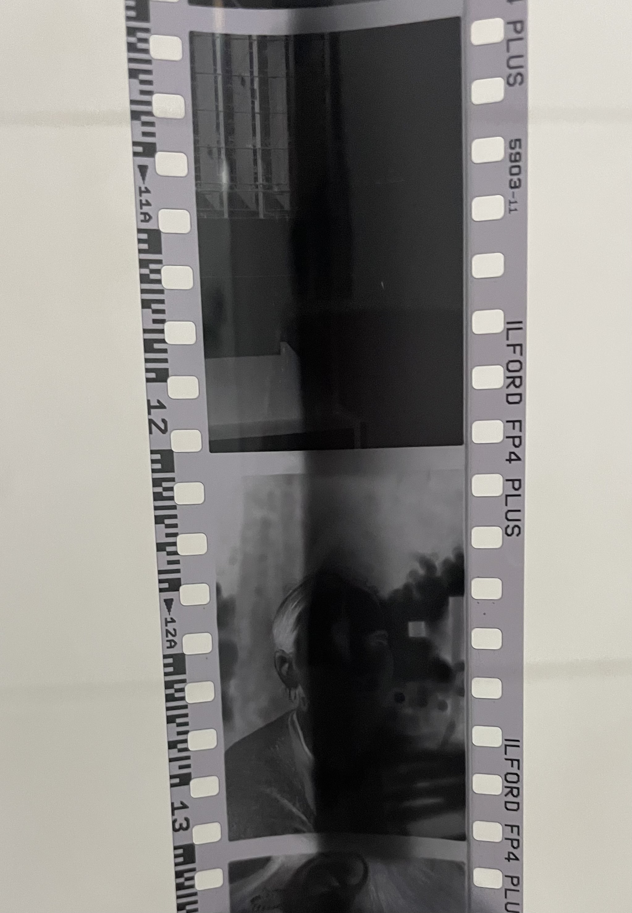

I don't see how the film physically contacting itself on a reel would cause this excess density in the negatives. Film contacting itself results in either loss of density where developer couldn't access the emulsion, or entirely unprocessed areas of film where both developer and fixer couldn't get to it. The latter is more common, and generally is limited to small spots where e.g. reels contact the emulsion.
It definitely isn't pressure 'exposure' due to bending the film, either.
It looks like fogging to light. The blooming around the dense areas in frames 6A and 21A supports this. The question is just where/when that happened. My bet is on a camera-related issue because there appears to be a relation to the frame spacing (again, see frames 6A & 21A).
Generally, if film is touching itself in the tank, those areas end up undeveloped and unfixed, which looks different from the pictured film, which appears to have added density in those areas.
