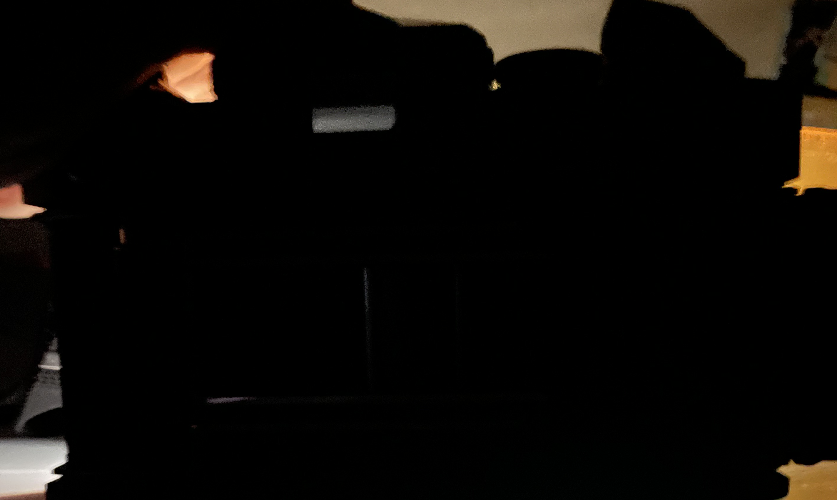

@Don_ih @koraks @MattKing I developed a few more frames after changing the hinge seal. Unfortunately, the problem seems to be still there (although less evidently).
I further inspected the shutter by locking the mirror up and pointing a strong light in the lens mount. From behind, when advancing the film, you can kind of see a very very small VERTICAL line of light between the curtains (see photo, sorry for the poor quality but it is over the capabilities of my phone's camera). I don't know if this little amount of light is within tolerance.
Anyway, the mark on the negatives is horizontal, so I don't see how it can be the cause of a vertical leak.
Also, the light seems to originate from the shutter curtains non perfectly overlapping rather than from an actual gap between them.
If that's the problem, will it be fixed by adequately tuning the shutter by a technician or is the shutter faulty and need to be replaced?
Don't forget that the film moves horizontally when you wind it.
I don't think there should be any light falling through the closed shutter.
You mention that this happens as you transport the film. So as @MattKing points out, the film moves along this slit.
I don't know whether this is the (only) source of the problem. I also don't know what the best course of action is - whether this shutter can be fixed, and whether it's necessary to begin with.

Yes, that tiny slit would make a band of density exactly like what you're getting in your photos. If the camera was serviced, that should have been caught.
If there's a slit in the shutter that's occurring during winding then you could put a lens cap over the lens while winding. That might explain why I couple of shots didn't seem to be affected in your original sample. Try winding every other frame with the lens cap on to isolate that issue.

Hi, I took the camera back to the technician, but unfortunately, the issue still seems to be there. To be fair, the gap between the curtains seems to have been reduced, but it still affects the pictures by causing light leaks.
In you opinions is there any way to bend titanium shutter curtains back together?
You can try gently poking them with your finger, right at the point of overlap. You have nothing to lose. But pushing too hard will push the curtain out.
The light leak was probably caused by someone accidentally pushing on the curtain while loading film ... or while doing a cla....
