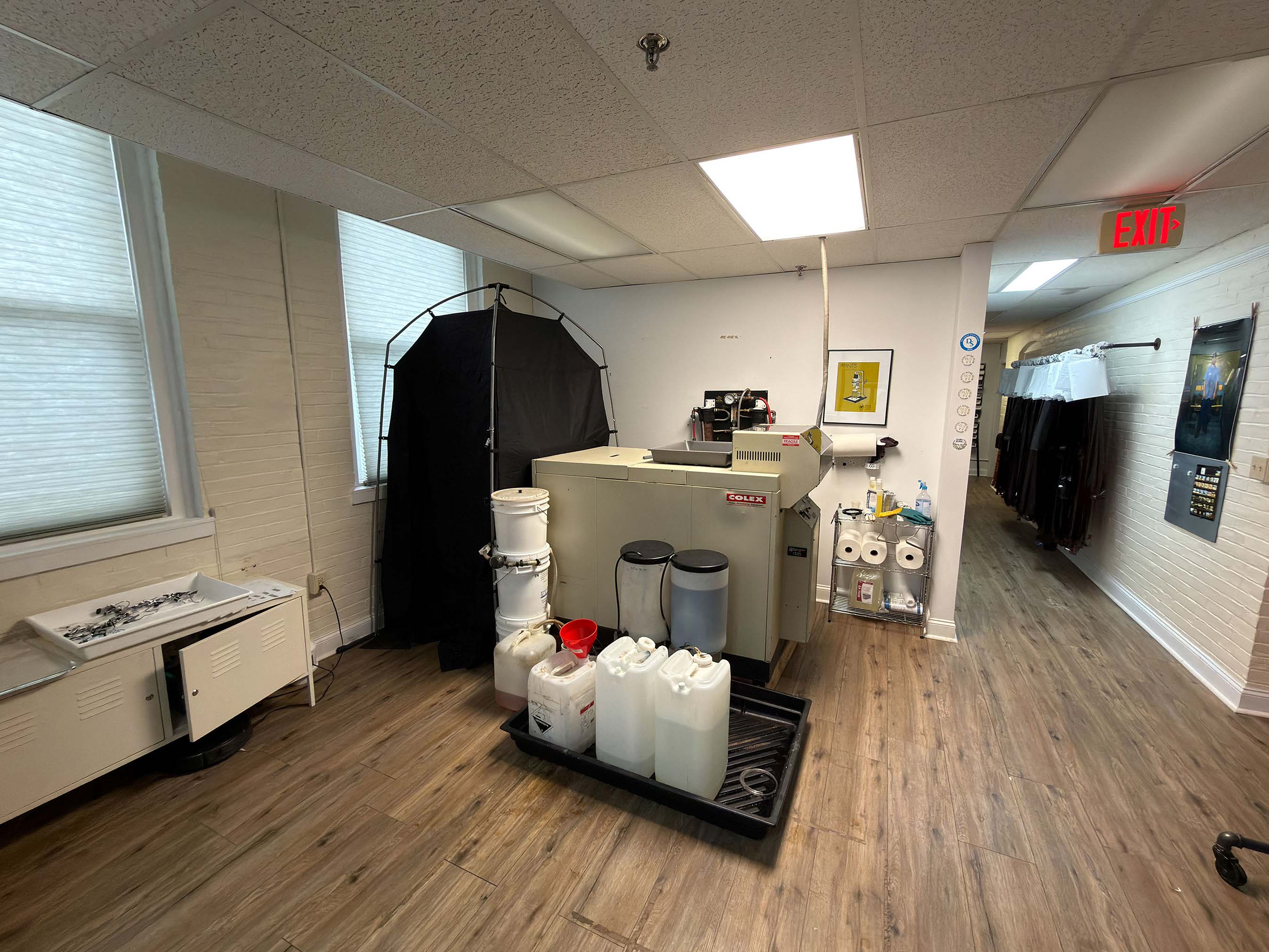

This is our space where we have the COLEX. To install the Roboline here I think we'd need to build out a new 'room' to lock out the light. It's certainly possible but I think it would be quite the undertaking. We are renters here too so there is a bit of a limit on what we can do. In my ideal imaging I'd have 2 RT machines next to each other, both with daylight load lids. You can see how we use the ILFORD darkroom tent now, which is fine...but is an eyesore. Also the zippers break down about once a year so we have to replace them. If I had my ultimate druthers we'd move into a more industrial space where I could build out whatever I want, but moving at this stage would be a bit catastrophic...if such a space even becomes available.
But it remains frustrating to me that 2 Colenta RT machines would be similar in price to 1 Roboline dip and dunk, which I would consider the ultimate for us. We do still do a fair amount of sheet film, which we run in Expert Drums. I would love to have a dry to dry set up for all types of film minus E6.
It's much less complex than you'd think - a couple of light-tight stud walls and a door, which are not that difficult to demolish when/ if you need to move. Colenta seem to be happy to supply a shaped wall panel for the machine/ wall interface. The space needed is not significant, if you've ever seen/ visited other dip/ dunk installations. Obviously, the amenability of your landlord will be the key factor here, and the ability to deliver 8kW of power for the machine & handle 200kg+ of chemistry + machine weight on top of that.

Is your premises a domestic electricity supply or can it be upgraded? A new Colenta (depending on model) has electricity requirements of 4.5 - 10kW. Add up all your equipment kW and then add 30% and that might give you an idea of your power requirements
Will the new equipment be on a ground floor with a concrete base? Or on a 1st/2nd floor. If you have a leak what will happen? A rough rule of thumb is that 1L of chemical is roughly equal to 1kg in weight. So add all your tank capacities and also add the amount of replenisher you will store and that should give you a rough weight requirement. I personally prefer a ground-floor concrete base.

In terms of power consumption, the Colex 20" RTF we run now draws about 10kw, so if we go to 2 RTs I think it would be slightly less or the same, and the same if we do Dip and Dunk. We actually do not pay for our electrical usage in this building, because the systems are so tied together they can't determine usage for individual renters. So, from a cost perspective, it's not an issue. I think from a utility perspective my concern is with water temp incoming to the machine. It's Maine so cold in the winter and 20C or so in the Summer assuming I'm not drawing from the water heater. The Colex uses a lot of water (also not something we have to pay a metered rate for). If I was very concerned about it then the Rapid Access model would make the most sense because it does not require a water connection. The B&W machine does, but the sales rep indicated to me that as long as the water comes in cold, it's good...the machine tempers the wash baths. I would hope the same is true for the Dip and Dunk.
The floor is not concrete, there is a basement utility space below us. We drain directly into the floor through a pipe we had fitted for the Colex. Yes, spills are annoying. We have 2 wet dry vacs. Again, if I had my druthers we'd be in a semi-industrial space...but druthers I do not have. I would think the heavier Colentas would be in line with the weight of the Colex, it's a big machine with big tankage. It hasn't fallen through the floor yet!
It would be important to me that staff could run any machine we get independently. Part of our goals for the coming years is to free ourselves up (my wife and I run the shop together) so that we don't have to close when we go on vacation, even if we run with some reduced services. So again, that's points to the simpler RT machines. However, if they quote me a price for 2 RTs and it's the same as 1 D&D that does both B&W (in Xtol) and C41, and sheet film, it's hard to say no to that. People can be trained up. We now staff pros who get a lot of training, and I'm happy to say we pay them pretty decently for our area! I'm proud that we offer arts based employment out here. A lotta folks go to school for photography these days with dim job prospects, but our employee uses her degree every day.
