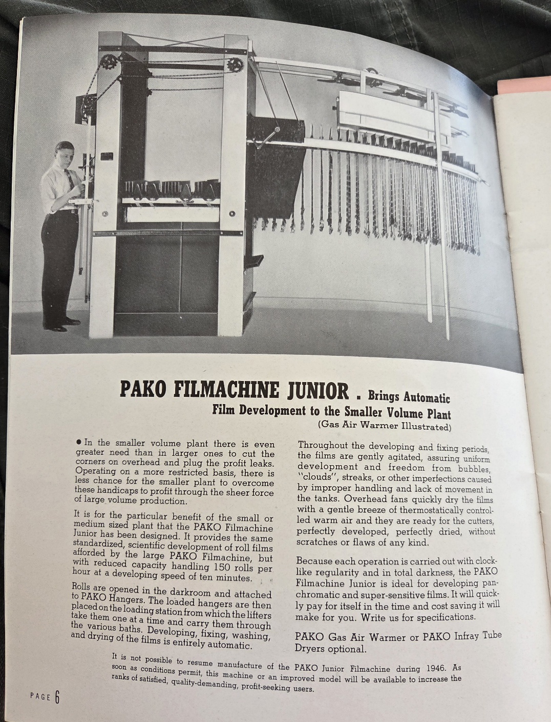

I have always thought D+D is the most elegant. I have old catalogs from Pako that showed a huge setup for developing roll film.
And wearing the tie is not an option! :smile:
And a white shirt, shined shoes. I love those old gear ads. It can get even sillier. A manufacturer was promoting a new model of table saw, and had a simulation shot of the product done in a pro photo studio. The nicely clothed model, without a bit of sawdust on him, had no eye or ear protection, and was feeding the board into the saw blade the backwards direction rotationally, with his hand directly in line with the blade. Nothing was actually plugged in, so the Mfg Rep asked what harm was there to the ad? I responded that if someone equally uninformed takes a wrong clue from that ad, and gets a hand or arm cut off, or loses an eye, or even worse, it would lead to a multimillion dollar lawsuit. The Marketing Monkeys got the point and withdrew the ad.
Now if I see someone in a white shirt with a tie, and shined shoes, I think, either a Mormon missionary or an FBI agent.
