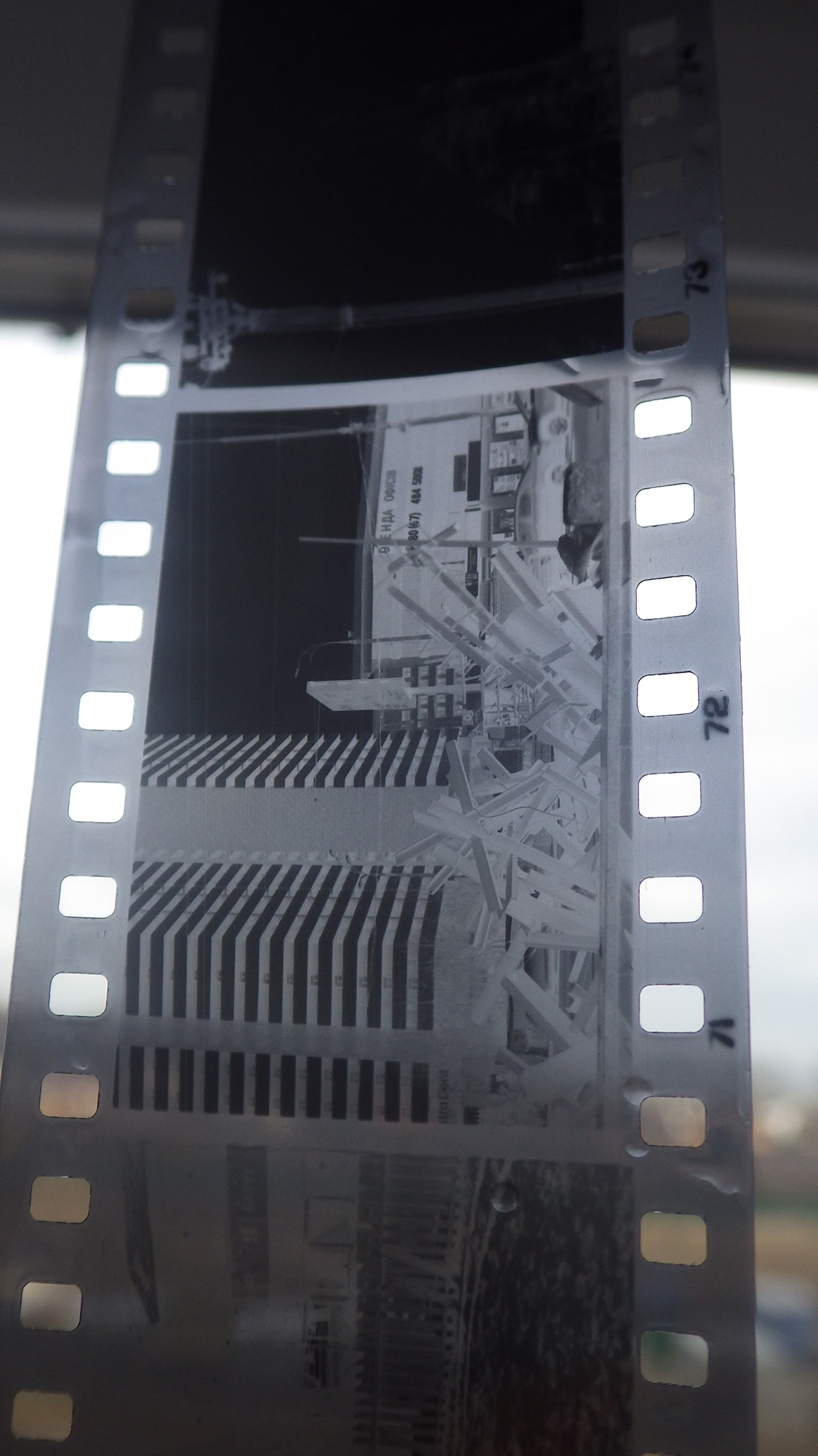

This is exactly what I'm trying to figure out. And the first test results are disappointing. I have just developed a film received from them by Svema100. The first suspicion appeared when I started doing the test "3.14"
When wet, the emulsion acquired a pink tint and it was impossible to fully determine the darkening density. After developing Microphen 1/3 for 12 minutes, I got a transparent film covered with a veil. In the same developer, but with the addition of a little benzotriazole, I developed Svema130 film 40 years overdue. Photo result. For a 40 year old, I think it's perfect. Until the end of testing and making inquiries about the seller, I can’t say anything either good or bad, I can only say that I couldn’t make such a big mistake when developing.
