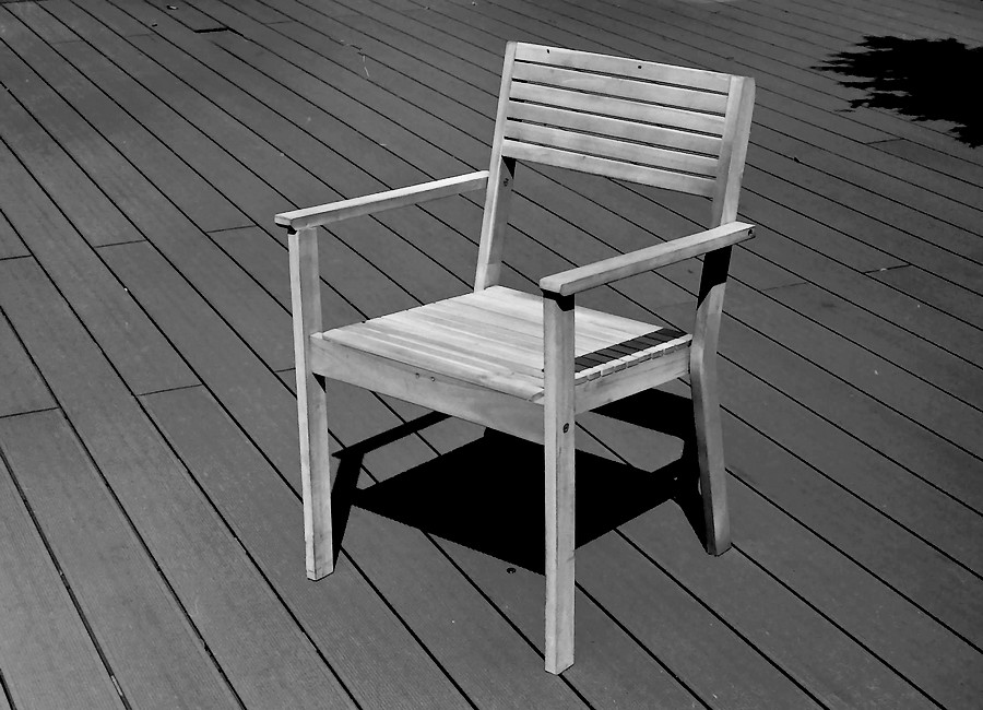

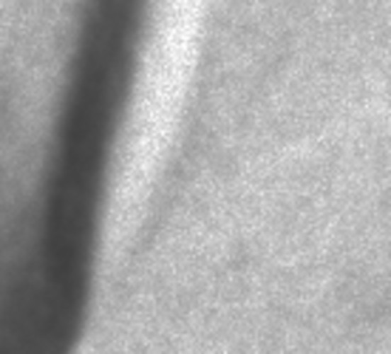

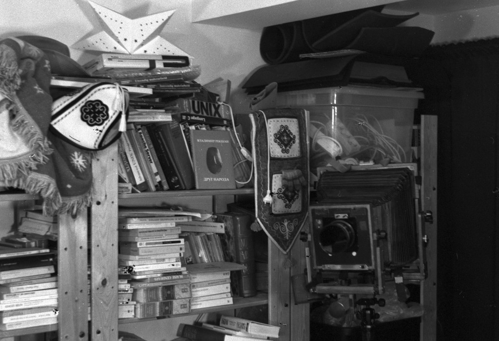

I received yesterday a roll of Svema Foto 200 and one of NK-2SH as Astrum from a seller in Germany, ie. three days shipment instead of three weeks or three months.
I like the packaging: it's plastic reusable canister, the kind I use when rolling from bulk. Very convenient.
It was a very dark day and already late evening, very little light, I took a Zenitar-M (50mm f1.7) on a Zenit and went take few pictures.

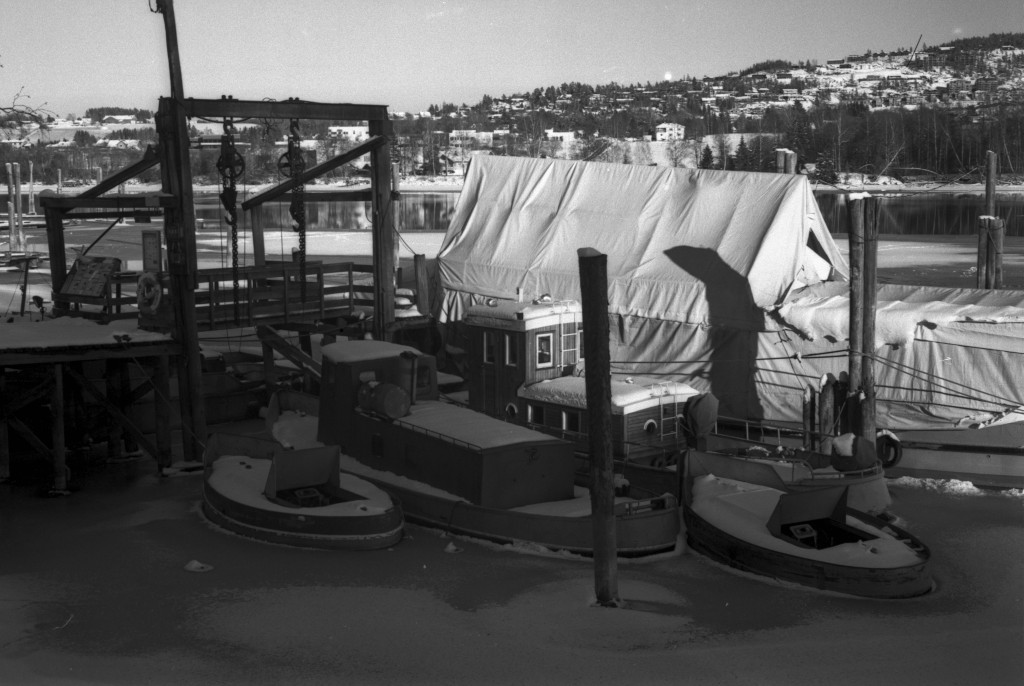

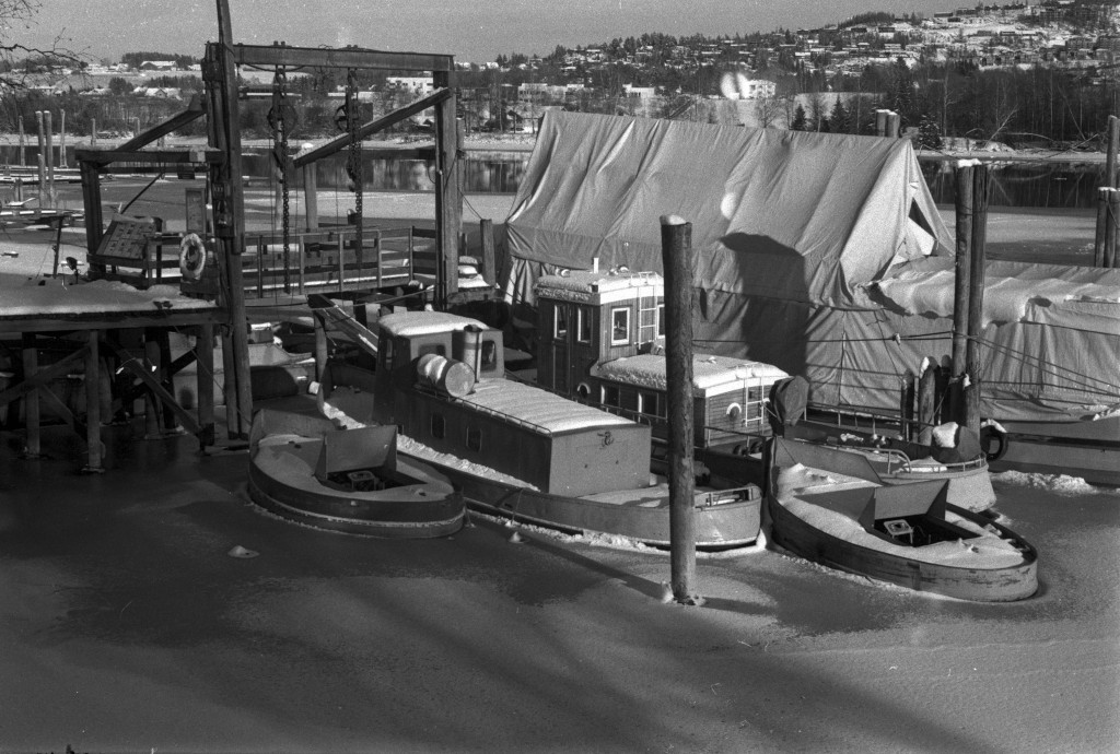

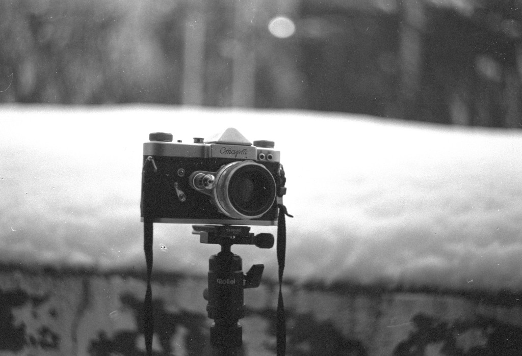

Today there was blue sky no clouds and I took the Exakta Varex with a Tessar 50mm f2.8 and a Soligor 28mm f2.8. The Exakta is convenient for the knife. I have a changing bag along, so I shot some frames of Foto-200, cut, roll the strip into a canister, load the NK-2H.
the typical soviet developer was the so-called Standart-2 ST-2 (metol, sodium sulfit, sodium carbonate, potassium bromid and a bit of EDTA or Calgon), I am empty for potassium bromide so I had a look on Massive Dev Chart but Rodinal I don't like much, DD-X, and D-76 I don't use, Xtol/XT-3 I mix a bottle when I know I will developer many films in its shelf life but not the case now.
So I opted for HC-110, For Foto-200, there's a standing development recipe, I didn't have the time, so after some interpolations I decided to try HC-110 in H dilution (1+63) for 12 mn, first mn constant agitation, then 3 inversions/minute.
For NK-2H Massive Dev Charts mentions regular B dilution for 10mn, I decide to try instead E dilution (1+47) 15mn.
Plenty of instances of these films around the net but none with these HC-110 dilutions and times. I scanned at 5000dpi. So:
Foto-200 under low light/very grey sky:
Foto-200 again, today evening full blue sky:
this one was risky, the sun is casting strong just by the edge of the roof in the back, lens Soligor 28/f2.8
then I switched to NK-2SH, light has changed a bit as sun was getting lower:

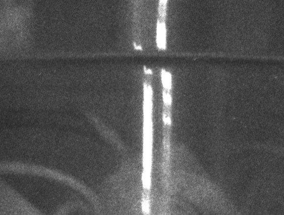

last one for the fun, as I was curious about possible lens reflections, sometimes they are very unexpected:
I forgot: Svema 200 is very thin, must be a bit careful in case of loading into metallic spirals, to avoid bending.
That's, certainly, a way to develop something. I am not sure how good of a way though
I found no recipes for HC-110 at higher non-stand dilutions, but i use it a lot, so i compared times ratios among other developers with ratios for other films with same developers in order to make an initial try. The 12 mn with dilution H (1+63) worked not too bad with Svema-200, for a first try.
For NK-2SH the formula provided on Massive Dev Chart is B (1+31) 10 mn but with other films I find H better and for sure forgiving, the rule is double the time of B for H (1+63) but I opted for a compromise in duration/dilution so opted for E (1+47). Again for a first try not too bad.
I guess Rodinal would have given a bit crispier images, but then these HC-110 dilutions seem to work well for grain size. By the way, grain difference Svema-200/NK-2SH is huge. I will get Svema-100 in order to compare, but just nown i'd rather buy a bulk roll of NK-2SH.
But why stand? In the first photos there's uneven development present, typical for stand. What benefits does it have over the standard "7min at 20C"?
No i didn't do stand. I mentioned that for Svema-200 the only formula with HC-110 that I found is stand.
What i did is HC-110 1+63 12 mn. I may have not mixed well enough but it was 1mn constant agitation then 3 inversions/minute.
Oh. I see now, sorry. I've misread your posts, sometimes happens to me for some reason. Still, what caused the uneven development?
The first pictures of Svema-209 are from a short, eight frames, strip I cutted from the roll and i loaded into a metal spiral. I felt under the fingers how thin the film is, easy to misalign or bend a little when loading into the spires. Maybe space between two spires was uneven, too narrow, almost touching, so not optimal fluid circulation ?
I guess plastic spirals are more error-proof.
I was more careful with the second strip next day. And with NK2-SH thickness is better.

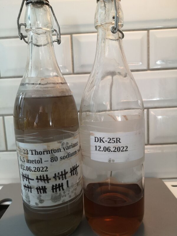

I finished the 36x roll of Svema-200 playing this time with replenished D-23 I have been using for 8x10 sheets, mixed mid-june, 9 months ago, and used as marks tell 36 times.
10 mn, constant agitation 1st mn, then 3 inversions/mn.
Some white points here and there, not sure it is dust. Will need to buy more Svema to keep playing.

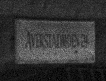

I have been doing some more play with the Oto 400. I happened to see a Ukranian Flag flying in the sun in my area, and took a picture with the Oto 400. BOTH of the two fields of the flag were almost the same shade of Grey on the negative. (blue and Yellow) this has me wondering if it is indeed an AERO film with some extended red or IR response. Some more play to think about.
