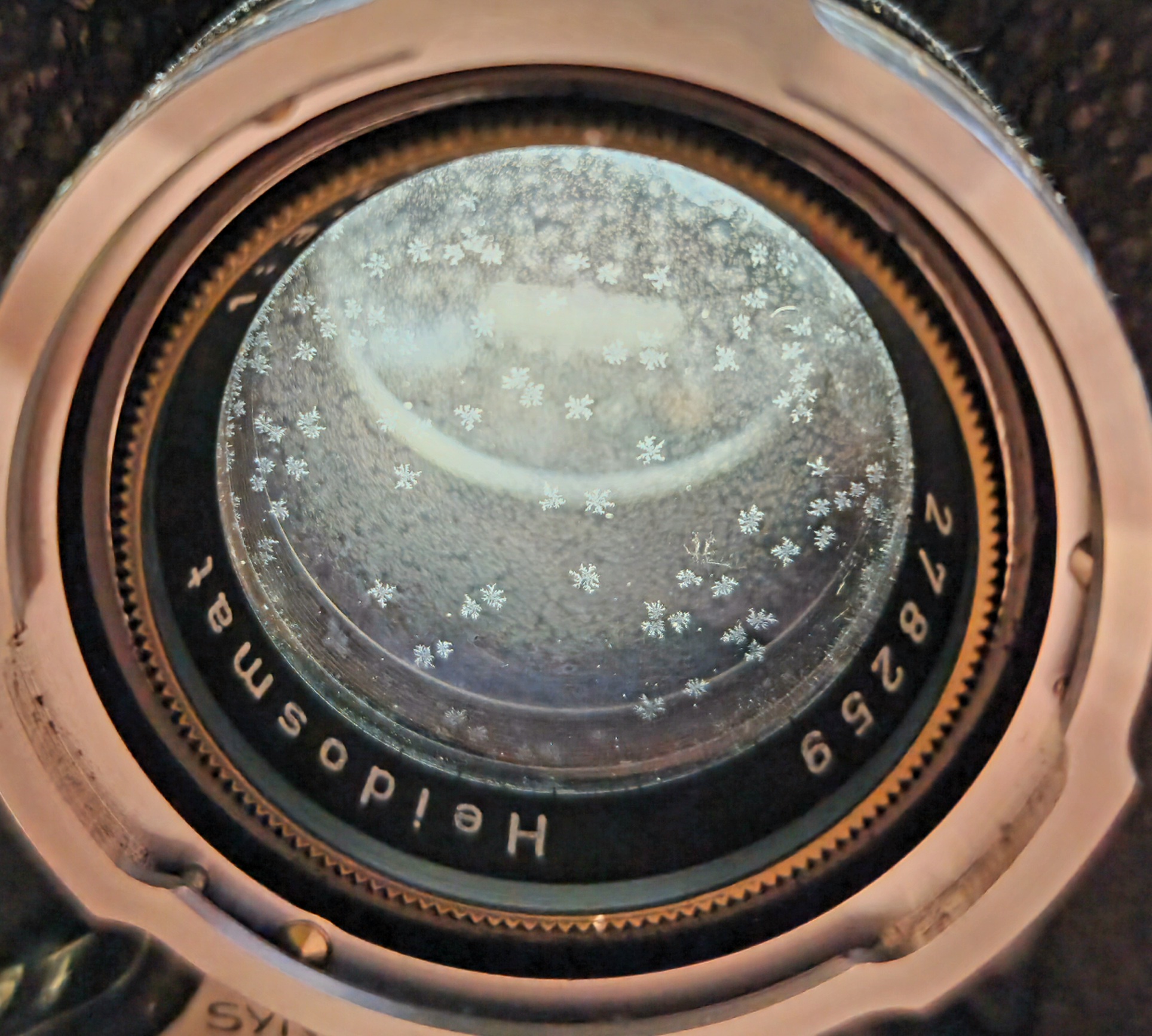

Michigan has had a lot of snow this year and it seems as if my Rolleicord IV is celebrating.
This is the viewing lens and despite how bad it looks the view is still pretty good. My search has shown it to be possibly balsam separation while others say it is fungus. Searching also says it is common on Rolleicord IV's of which I have 2. This is on both front and rear lens elements. The other 'Cord is nowhere near as bad...yet.
Comments?

Unfortunately the viewing lens does not allow elements to be separated since they are glued in and removing them could cause more problems.
Rollei used a triplet design for the viewer. So it can't be separation; no glue on the elements. This is likely fungus.
It should be possible to remove the individual lenses and clean them thoroughly. You need to remove the front panels to gain access to the viewing lens. You need to keep track of the orientation of the double concave middle element and of the two spacers. And you need to be able to collimate the viewing lens.
Thanks for the comment. I had read that "unglueing" the elements using heat would likely cause them to separate and lose the orientation they were installed in if that makes sense. So if no glued elements are present, I may give it a try.
It would be nice to find a replacement viewing lens but I doubt many/any are out there.
Yes, three separate elements. Once you get the front cover off and the lens removed (check infinity focus first), the front part unscrews. Check around the side to see if there is a set screw for it. As OAPOli says, keep notes and photos on orientation of the spacers. And the middle element. When it first comes out, feel the surface on both sides; you can feel that one side is curved more but it is hard to see. I'll put an arrow on the side of element in pencil, also.
Soak all the glass in ammonia and hydrogen peroxide for a night. Then see what you have. The nice thing is that the viewing lens does not have to be in very good condition to work perfectly well.

I will give it a go, got nothing to lose.
Exposing the lens for direct Sun light will help stop the growth, but will not remove and fungus damage.
If it is only on the viewing lens and not on the taking lens, it shouldn't be much of a problem. The Rolleicord is a beautiful camera with a quality to match any 6cm X 6cm format.
Yeah, I have done that with sunlight and a UV flashlight over time and have not seen it getting any worse so I guess that's the best I can do for now. As I said, the view is amazingly good despite the look of the lens. Thanks.
