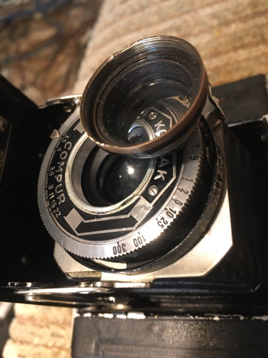

Starting from here. Front element is unscrewed from outside with barrel. Should I unscrew two screws on the plate first?

@svetoklik you still haven't stated what you are trying to do.
I don't know what you mean by "inside ring".
The video you linked shows how to remove the front lens group, and what is the function of the two screws.
Its stuck. I will continue tomorrow. Meanwhile I have checked Xenar 10,5 cm lens.
It is possible to make adapter but there will be no space to fold it back without further modifications what is out of my reach.
Front lens is missing. Maybe I can use Shooter for Seagul 203.
