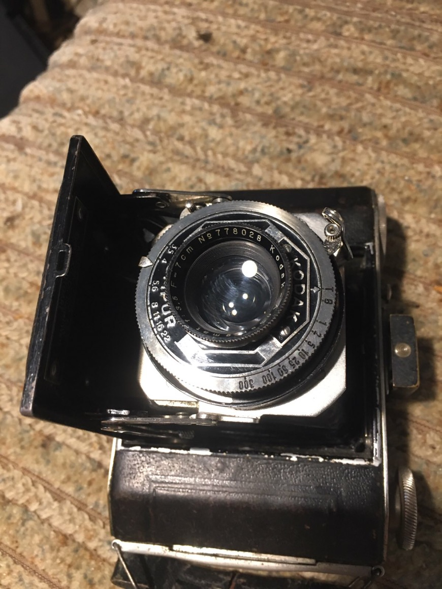

I have Kodak duo 620 camera for 6x4,5 Cm format, but front magnifier glass for focusing is missing.

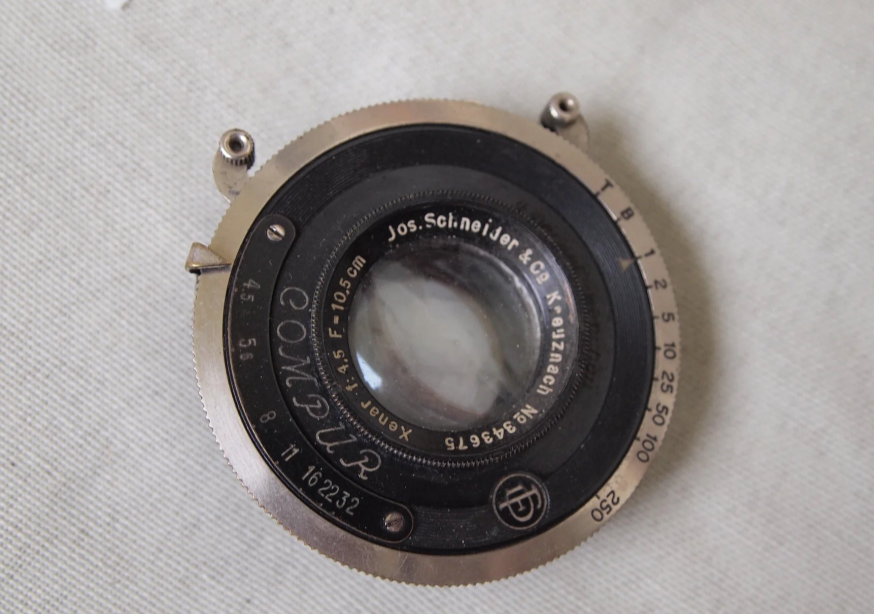

Also have Jos Schneider & Co Kreuznach Xenar 4.5/10,5cm lens with shooter that opening 125 on all chosen speeds.
Assuming that folder lens 10,5 cm is for 6x9,5 Cm format it will be possible to mount this Xenar on to Kodak duo with proper distance from the rear glass to the film.
Diameter of the lens is about to fit dimensions of kodak plate.
Does someone know this distance?
For these lenses, the shutter mount to film plane distance is approximately equal to the focal length. Since the Kodak Duo uses a 7,5cm lens, the 10,5cm lens in the same spot will be way too close and won't focus on anything. And generally speaking, lenses are collimated to infinity to a fraction of a mm in the position. So swapping two lenses of the same focal length might not even work.

My question is does somebody knows distance from 10,5Cm folder lenses to film plane?
In another direction, there were 7.5cm Xenars used on some Zeiss 6x6 and 6x4.5 folders. These would use front element focusing.
I would start with 3 cm more distance than for the 7.5cm Xenar and test from there with the 10.5 cm.

If someone is under hand 10.5 cm lens for 6x9 cm format and have a moment to measure registar distance from film plane to the back of the lens?
Open helicoid on the rear of Kodak anastigmat 3.5 &,5 cm lens, very nice and honest for maintenance.
Since you have the lens, you should try to measure it directly. This is a specific measurement, which can vary ~0.5mm between samples.

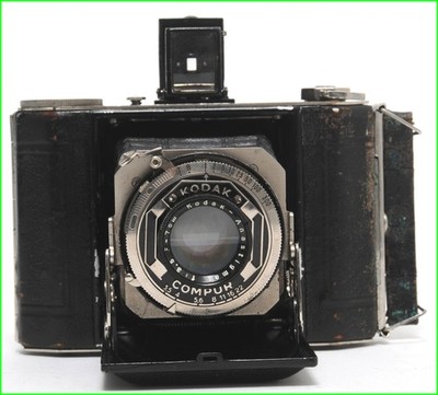

The lens pictured in post #5 is a 7cm. These are uncommon. You can check if it's a triplet or a Tessar type by counting the reflections of the rear group.

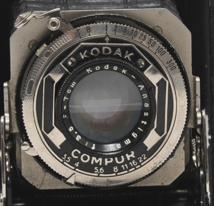

It seems that the goal is to replace the missing lens element and take pictures. Here is an example of complete lens:
Oops, yes, 7cm, not 7.5 cm.

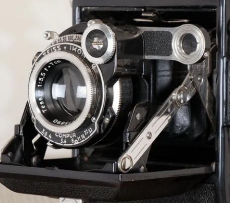

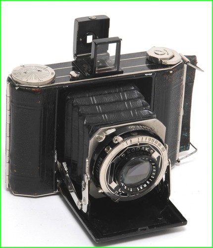

Early Zeiss folders have 7cm lenses. Like here-
Hi Dan. The 7cm marking on this KA lens vs 7.5cm/75mm markings on later lenses might be an "oddity of marking" and not an actual difference in focal length. I do not know of a change in the Duo design from the earliest ones with the 7 lenses and the ones following with 7.5/75 marking. But that knowledge is only academic as I've never owned one of the earler 7 lenses to actually measure focal length. There certainly are "oddities of data" though as I've seen Kodak documentation that asserts the 75mm lense of the Duo 620 version II as being a triplet...

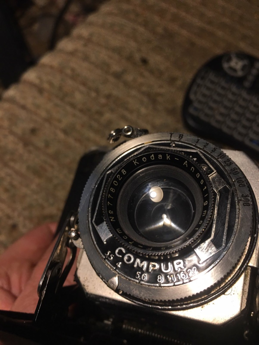

Three reflections of the lamp in the group, but more interesting is it true that one lens missing on the top?
Here is two more pictures from links, one is early Tesar type. the other one is original Duo 620 where we can see on the front element with marks one lens right on the ring that is possible to unscrew.

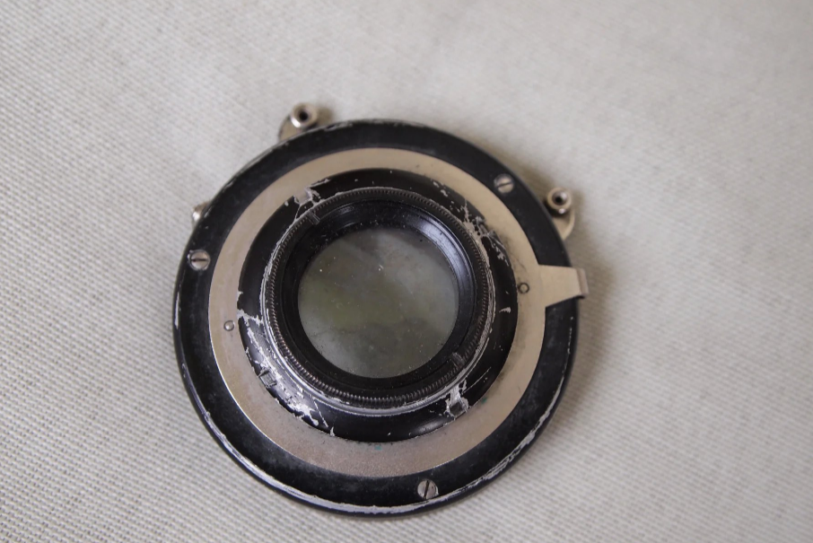

Is it possible that the front lens cell was disassembled and re-assembled incorrectly... in the wrong order? That could account for the odd appearance of your lens vs the reference lenses as well as explain why it won't focus.
I don't think the 10.5cm lens will work in the Kodak Duo due to the configuration of the camera and the focus mount.

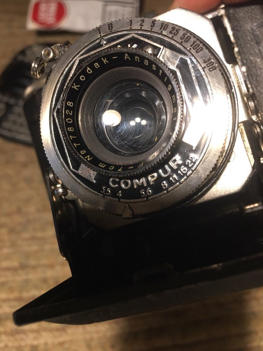

@svetoklik whether it's a Tessar/Xenar type or triplet, there will be two separate elements in the front group. I count four reflections, which means two elements.
Have you tried to disassemble the front lens? Are there one or two lenses? As @BrianShaw suggest it could be that one of the two elements is on backwards. Usually the double concave central one.

From your photos, the front element appears convex which is correct. If the front lens was missing, you'd see the central concave element and the appearance would be completely different.
Unscrew the name ring using a rubber tool. Both elements should be accessible. You might need to unscrew the front cell from the shutter first. Flip the central element, reassemble and recheck the focus.
You should check the rear lens as well. The convex surface should face the film. Make sure it is threaded securely.
It is concave and maybe that part was assmbled opposite?

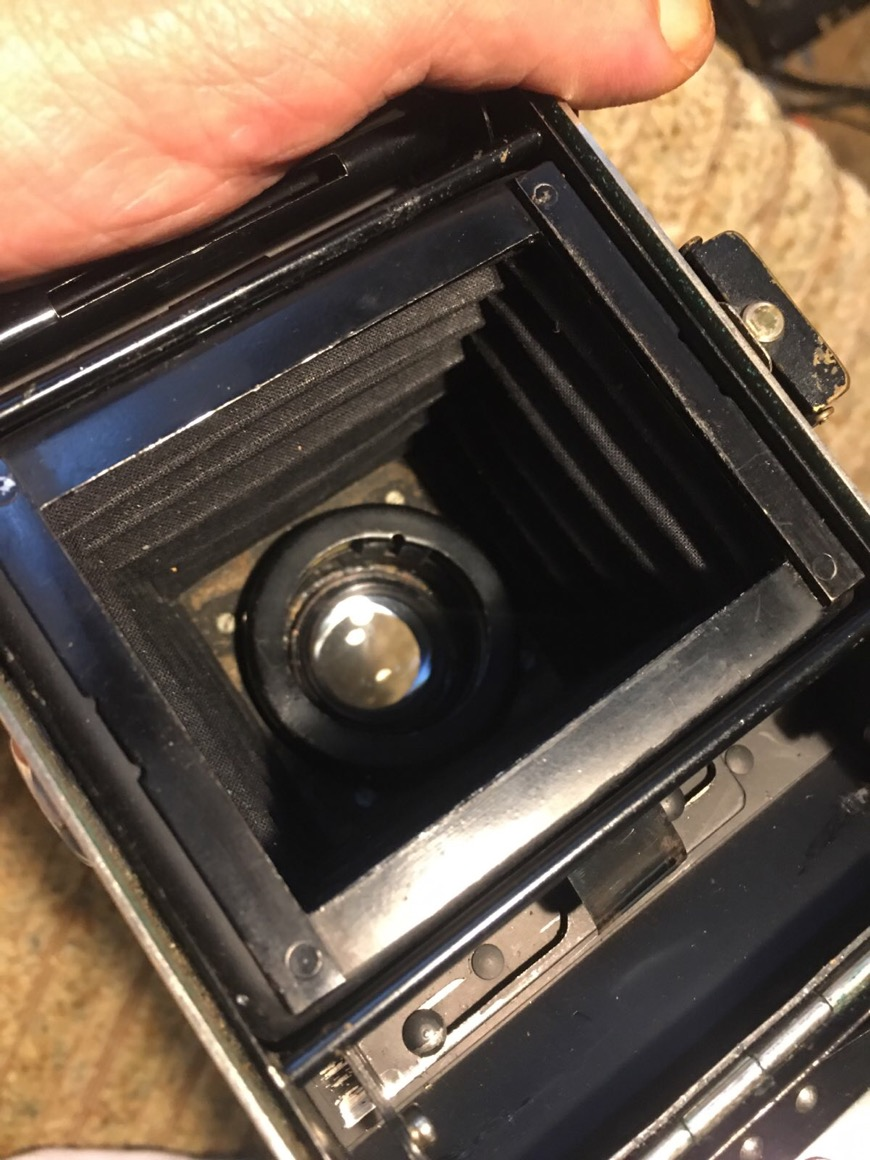

Yes, it is convex.

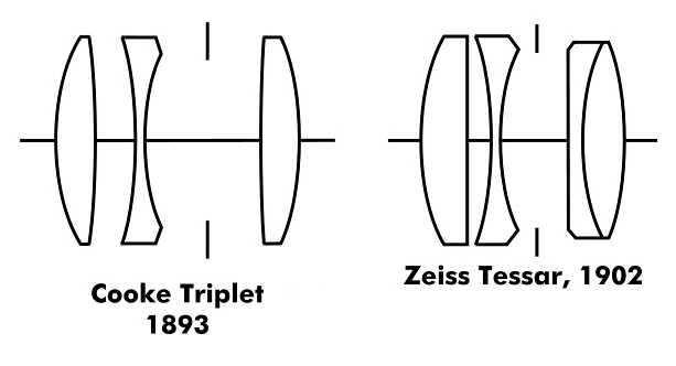

These are the expected configurations:
Only the central element is somewhat symmetrical.

On the other triplet lenses also has four reflections. Here is a picture with closed shooter.
Two different reflections.
Ok I didn't realize the first pic with 4 reflections had the shutter open.
