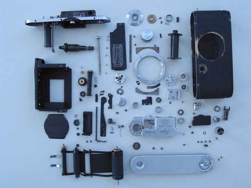

I had my time with Zorki's, Fed's and Leica's; here's one I once restored:
Leica IIIa sync repair & cla VII
by Ron (Netherlands), on Flickr

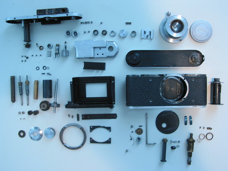

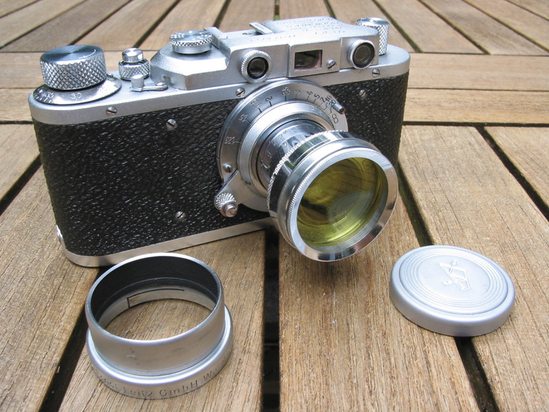

..and here a NKVD FED which I restored for a fellowmember of flickr:
Internally the NKVD Feds are as well machined as the Barnack Leica's. This one needed new shutter curtains and a complete clean and lube ;-)
NKDV FED repair & cla XI
Here it is after restoring and servicing; clean and shiny...
NKDV FED repair & cla XV

Thanks. Zorki's where manufactured as from 1948, whereas FED's were made as from 1934 shortly after the first years of the Leica II and were meant to be a copy of the German camera - Lenin had asked the Germans for licensed production, but they refused, so he started his copy work. Internally the NKVD Feds and some earlier ones have brass internals machined like Germans would do.
Btw later Leica's were also made with diecast bodies; diecast is much more rigid than plate iron - so the diecast is not why later Zorki's got less quality. It is because of too fast production with lacking quality control and indeed lateron cheaper materials were used. However many of these camera's are doing fine if well serviced and finely adjusted > I prefer to shoot with a finely adjusted Zorki 4 than with a Barnack Leica :smile:
I always do a complete strip-down since it reveals other faults and hidden dirt - best way to do it IMHO albeit laboursom of course.
