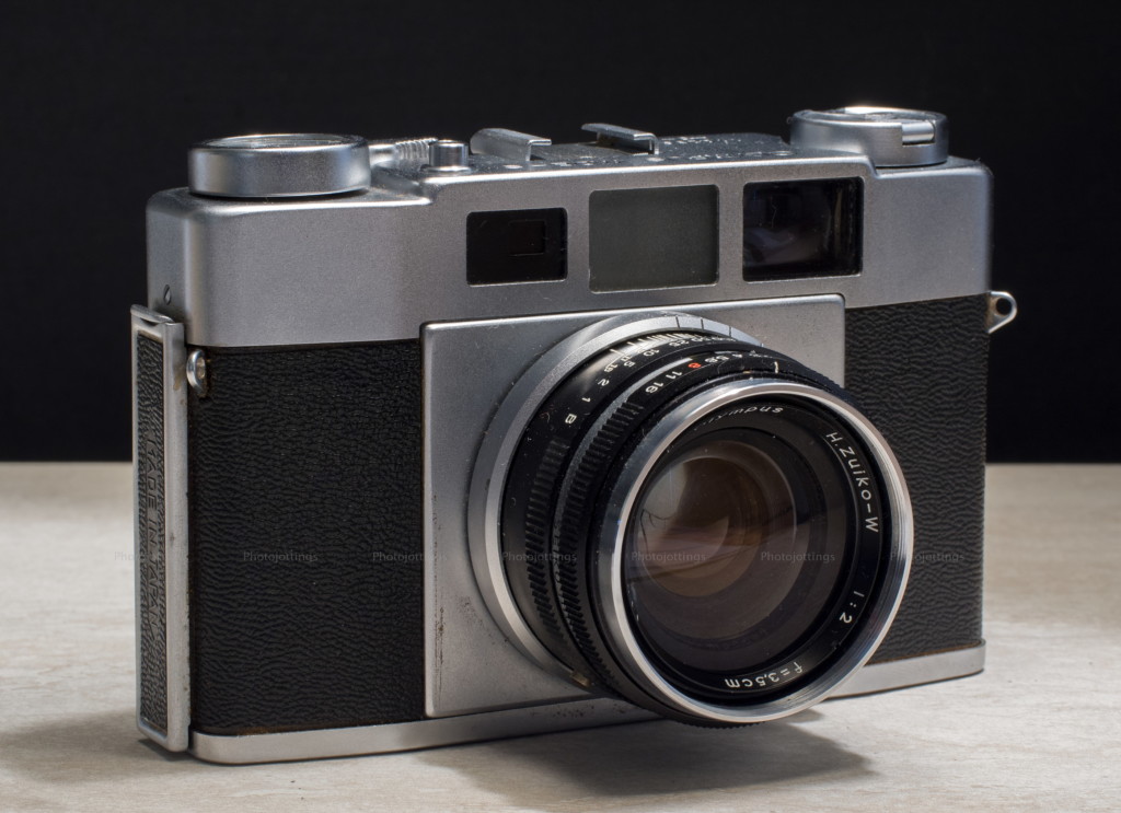

If you are OK with a fixed 35mm lens, get an Olympus Wide-S. 7 element Zuiko 35mm f2 lens, 35mm bright line finder with integrated focus patch and parallax correction. Back opens normally, lever wind and compact size. A real joy to shoot with.

The Olympus I mentioned is a late 1950's model that is all manual/mechanical. No batteries, no meter etc.
