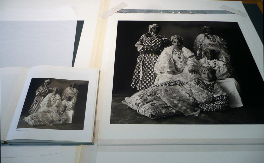

This is one image that i have yet to upload from a while back when i was looking at the differences between the book reproductions and the actual prints that might be of interest to some. It shows quite significant differences in density, tone and hue between the two that is important to emphasise to those who have not seen the original prints which is a must for anyone interested in platinum prints or indeed Penn's work.

I'm not sure what book that is, but it is generally agreed that Penn's book, Passage, represents the pinnacle of traditionally printed photo books, with quadritone negatives crafted by Richard Benson and Thomas Palmer, two giants in the printing trade, and printed by Franklin Graphics of Providence, Rhode Island. The reproductions in Passage are ridiculously beautiful, great dMax and separation of tones...unsurpassed in the printing trade to this day, IMO.
