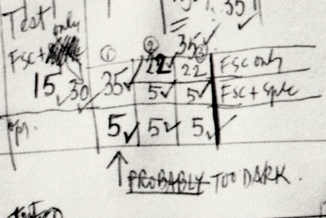

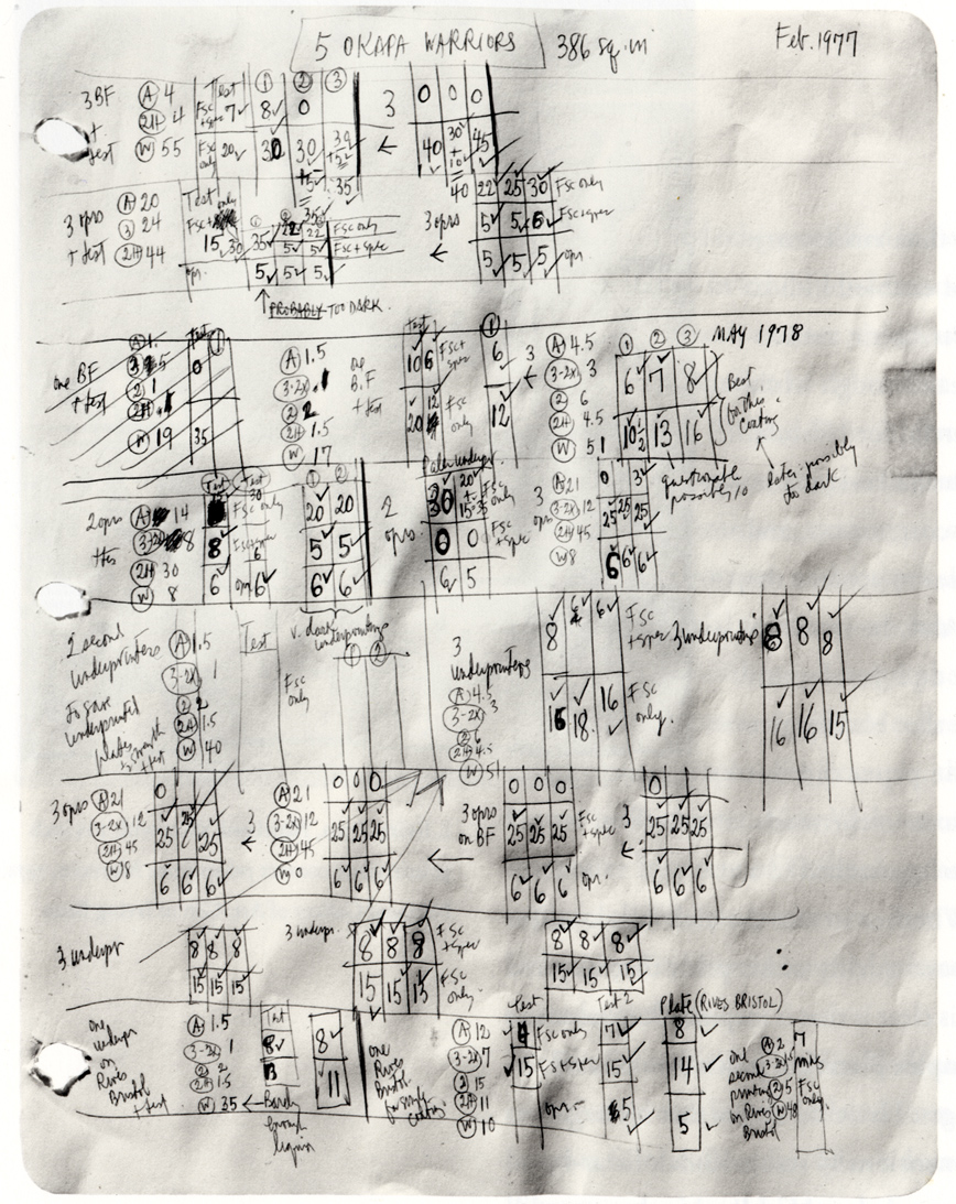

Below shows a working sheet of Penns for the Five Okapa Warriors platinum print scanned from Platinum Prints by Sarah Greenough. I have never really looked at this working sheet with any great depth until now. Its quite difficult to interpret some of the hand writing, there seems to be mentions of under printing One second printing on Rives BFK, later I will crop some the terms that look most significant. I presume the numbers are referring to drop counts /ml in some instances. Food for thought anyway.
