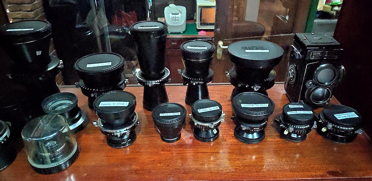

It looks like a 4x5/ 5x7 lens kit, probably for a Sinar. I've often seen 360mm plasmats on 4x5 Sinar setups. The 250/6.3 and 600/12 are pretty clear giveaways that it wasn't supposed to stretch to 8x10. I wonder what the percentages of people using the 250/6.3 Fujinon on 8x10 are, compared to the 250/6.7 - not high, I'd hazard a guess.
Yes you're right..it comes with Sinar P2 and Sinar F with a lot of accessories

Actually I already bought the lot yesterday and thinking to sell few items especially the Tele lens because i wont use that much.
Just a question, what Fujinon 600 is ? The T or the C ?
_______
Congratulations, this is an impressive asset !
The Nikkor T was very valued for the fieldability of the kit, if wanting to carry 3 long focals then quite weight and space were saved, and using a single shutter instead 3 also added exposure consistency, while also saving bellows extension. There are not much convetional choices in those lengths and some people used process lenses instead, like the APO Ronar, obviously commanding longer bellows than the Nikkor kit. The Nikkot T kit also has very good coatings. A "rival" glass is the APO Tele Xenar 800, a massive and ultra expensive/scarce thing, but reportedly it is better, specially in the corners, but in landscape, most of the times, what the corners have is irrelevant, in the top corners we may have sky/clouds and in the bottom corners we may have something near that is not in perfect focus.
Instead Christofer Burkett mounts the APO Tele Xenar 800 in his Calumet C1 to take details, for his kind of photography that glass had an advantage, specially considering that it could follow abig enlargement (with APO Nikkor EL 480 enlarging glass!) to craft museum ilfocrhomes.

It's Fujinon T 600/12
Maybe i should give it a try to Nikkor kit before i sell it.do you think all three tele lenses (360, 500 and 800) will work on my Chamonix N2? Which lens that need an extension base?

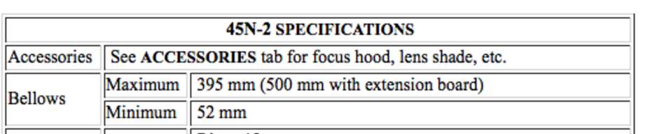

the 360 requires 261mm bellows to focus infinite, the 500 requires 350mm, and the 800 requires 527mm, see here the Flange Focal Distance value: http://www.kennethleegallery.com/pdf/Nikkor_LargeFormatLenses.pdf
The N-2 has these specs (https://www.chamonixviewcamera.com/cameras/45n2):
So you can even shot the 500, but to focus very close with it you may require the extension board: https://www.chamonixviewcamera.com/accessories/extensionboards

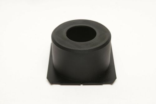

With some sort of custom top hat lens board (this one is not for chamonix) you may extent a bit more to even shot the 800mm at infinite:
...it would be something equivalent, but it should take a #3 size shutter.
With the extension board and the top hat lens board perhaps you may be in the limits of the camera, to shot those lenses another camera would be better, perhaps a cheap monorail like a CAMBO SC 4x5 would be quite suitable.
Thanks i will try the 360 & 500 on my Chamonix
